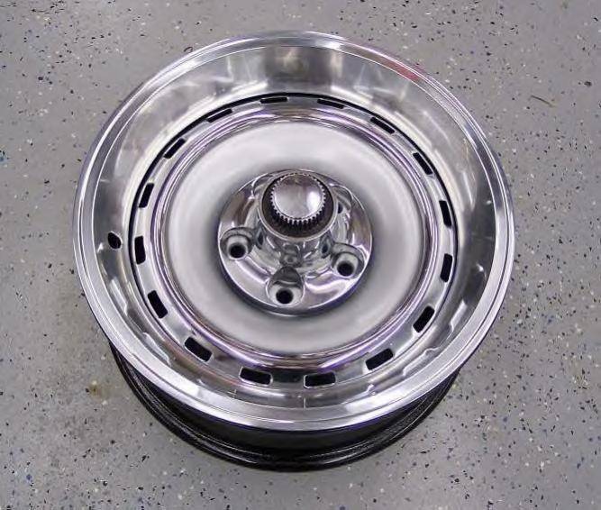

This is a C-body Road Wheel
Kevin

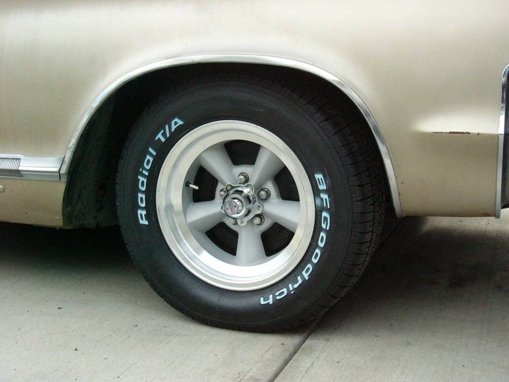

While a Magnum 500 type wheel wasn't available on a 66, they do look like they belong. These are 15x7 with 235/70 all around.
KevinView attachment 75751

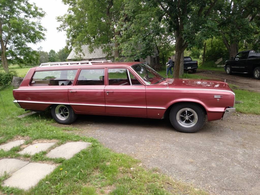

Following this post with interest as I have the tiny 215 tires on a wagon. @twostick, the Magnum 500s look great, did you specify a particular offset when you ordered them?

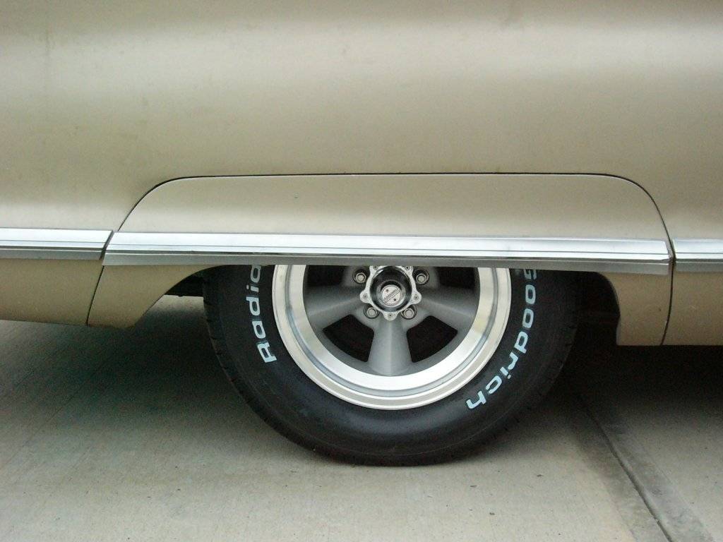

Those are 15x7, and from what I remember, about a 3.75 BS. Tire in that pic was 245/60-15. The pic below is the replacement tire, a 235/70-15. It fills out the opening much better, as the 245 was a little short.
