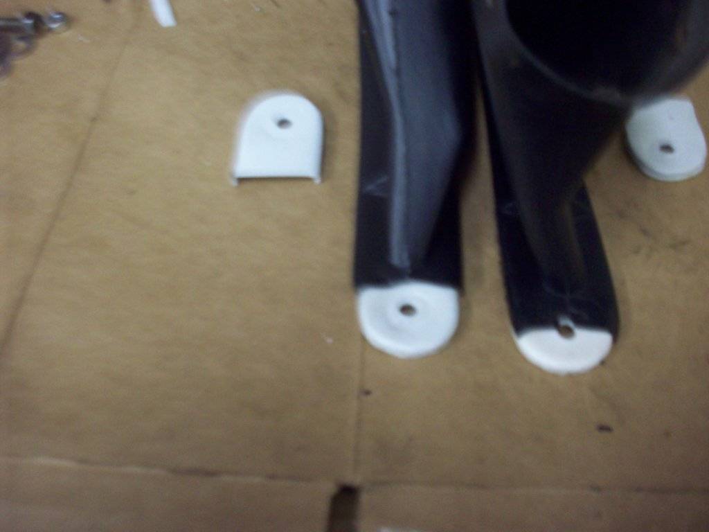

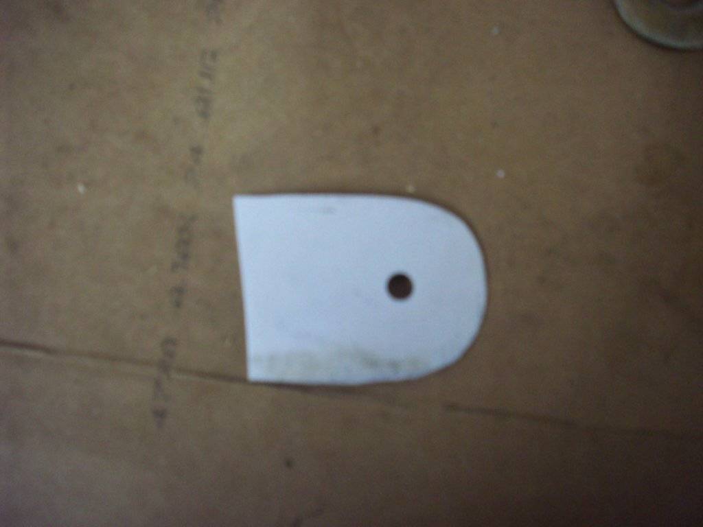

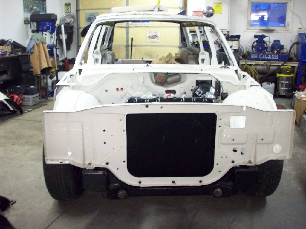

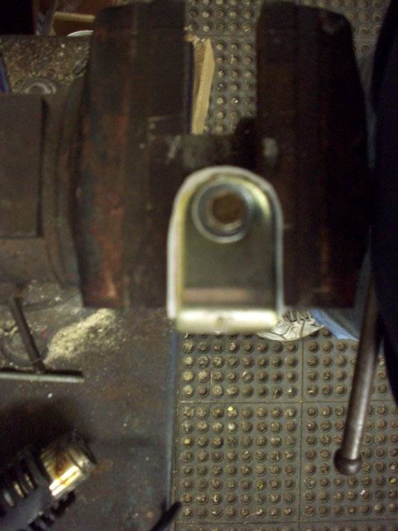

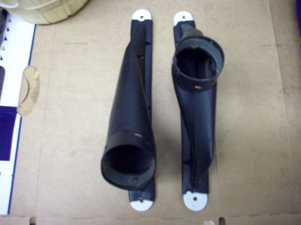

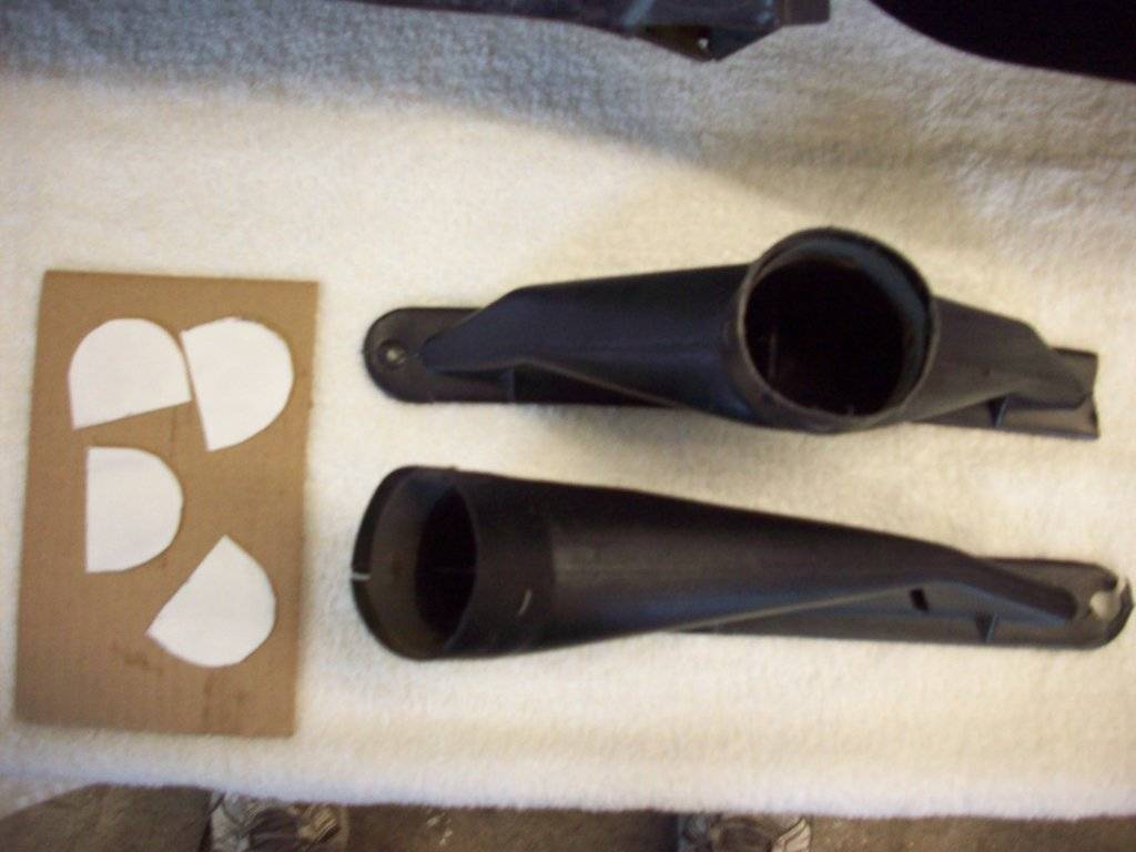

hi guys. time flies by. its been just over a year since I posted any more progress pics of my wagon. haven't done much but that is changing right now. I retired a couple weeks ago and have plenty of time on my hands. I tore apart my heater box and rebuilt it. repaired my broken dash vents. ends were broken off so I used some plastic off an oil jug that was the same thickness cut them to shape and used a heat gun to shape them around a clamp that was the perfect size and shape. cut them to the size I needed and epoxied them in place. just thought I would share this in case some other member had same issue. also a couple more pics of front end assembly.
