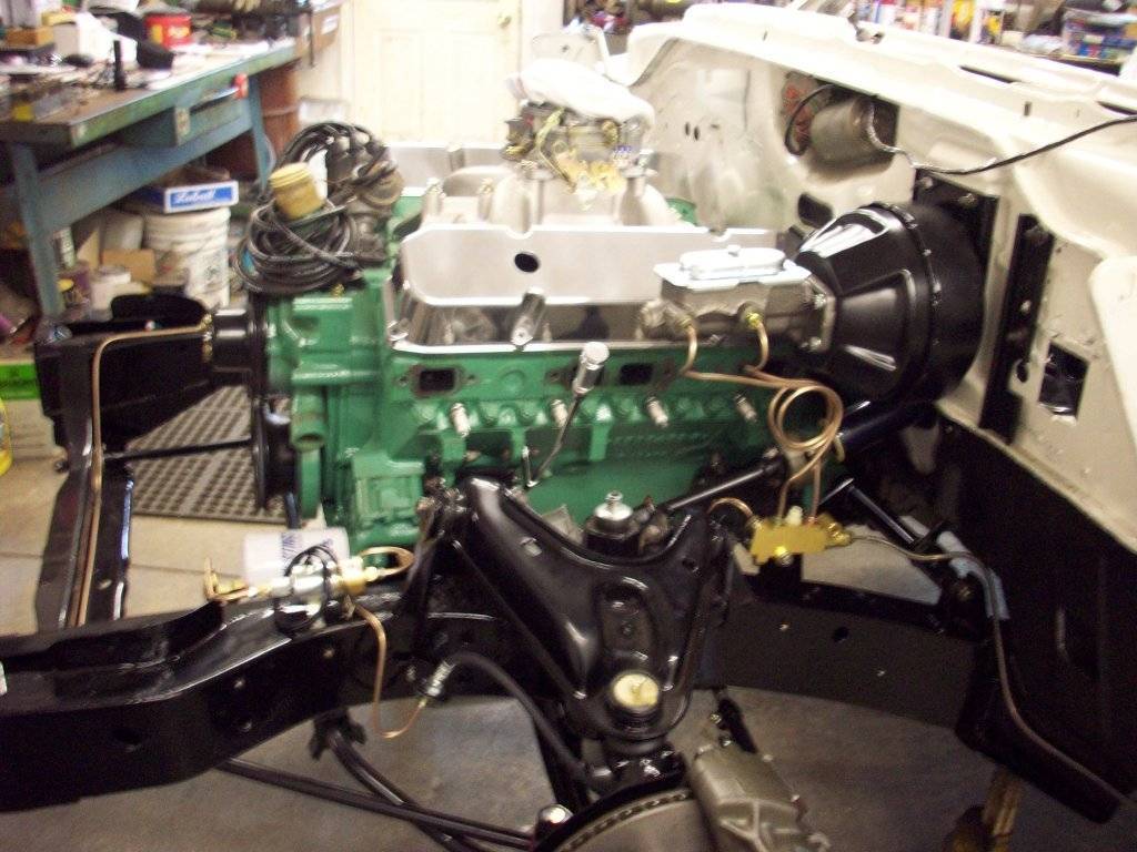

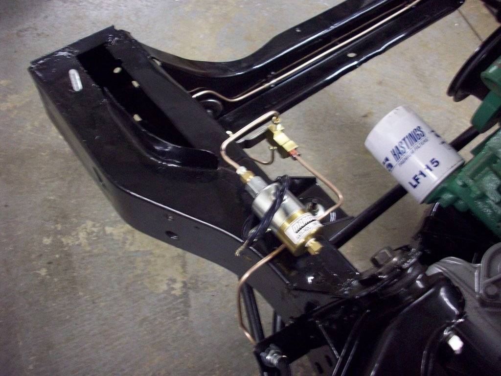

just finished up the brakes. had a line lock new in a box I was gonna put on my hotrod but though what the hell. I had to redo all the brake lines anyway so I plumbed it in on the wagon. be nice for doing burnouts. a couple more pics for you picture whores.

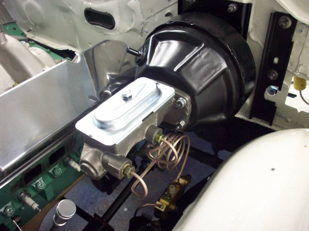

Is that a Drum M/C with Disc brakes?
I agree....that is what I see as well. You may want to change out the MC for a proper Disc brake unit. The disc brake MC will have a larger reservoir for the front brake circuit, as well as a larger piston bore diameter for generating the higher pressures needed to properly apply the disc brakes. Will the drum brake unit work....yes...but will it have the "Umph" to lock up those calipers and rotors in an emergency stop situation??......I'd not be willing to gamble on that with my nicely restored wagon. ;)
