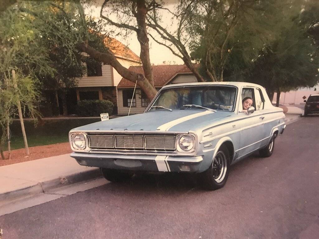

This rocket had a 71 340 out of a Challenger upgraded (?) to a cast iron 1969 style waterpump for clearance. Swapped out for a DC surplus circle track 360 used the same cast iron water pump set up but I upgraded to a ‘68 390 Mustang radiator because it was bigger and free. Worked fine for me.
