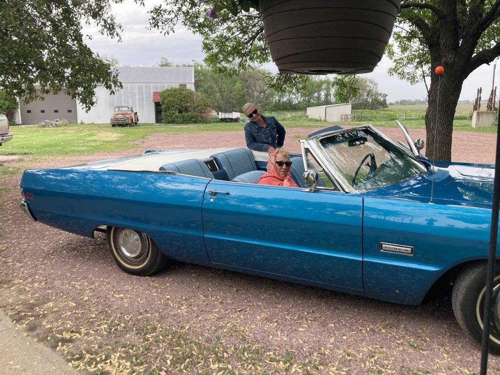

I have a 1969 Fury Convertible with a 318/904 and a 2:76 rear. I picked this rig up in February, and put 4000 miles on it this summer. Motor runs good, but is very very tired. Transmission shifts fine, and when I changed the fluid and filter and drained the torque converter, there were no surprises.
