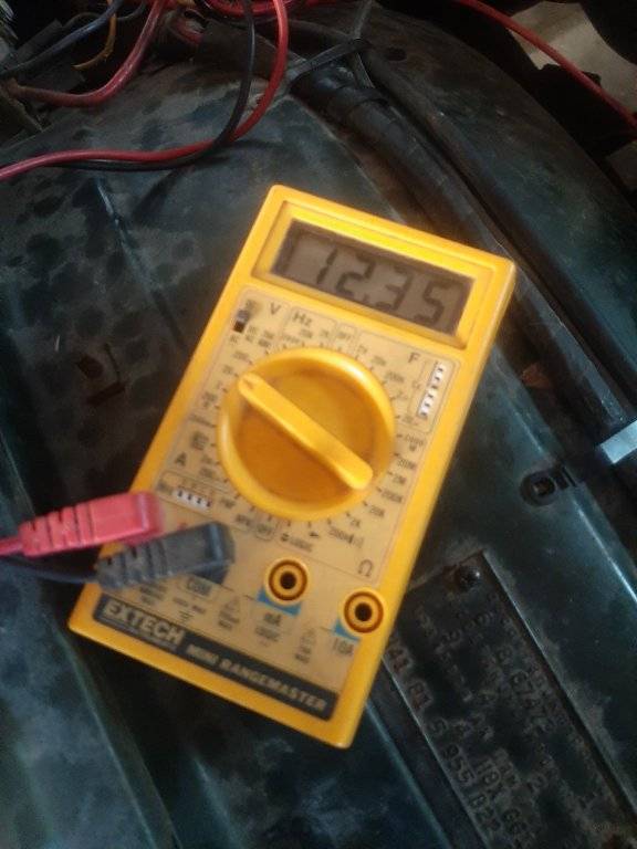

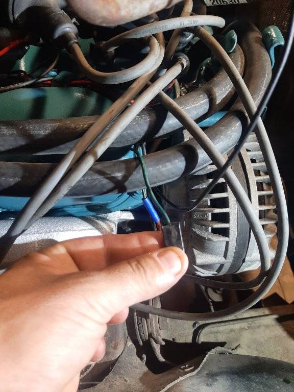

Got my car running a few days ago. Been doing great until tonight im cruising and my volt guage is around 12.5V. I get it home and put my tester on it and verify my guage is correct. I rev the car up and it goes up to 12.7V. Im suspecting my voltage regulator but i know nothing about these old ones.

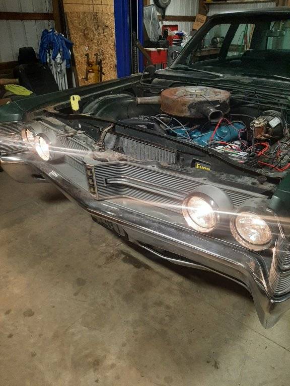

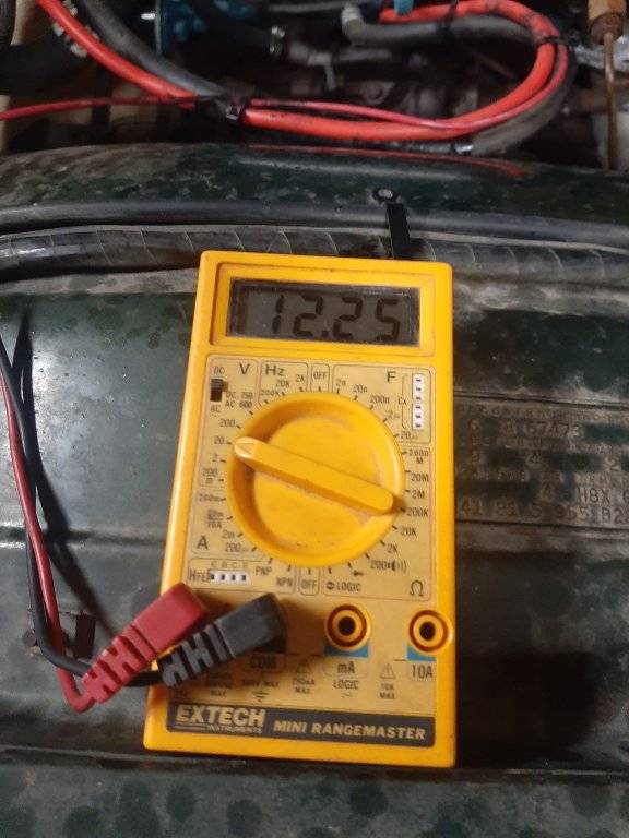

Just did the test and it started out at 12.72v with nothing on. Started the car with highbeams on and dropped to 12.25V. I unhooked the green wire and ran a jumper right to the negative on the battery
Alternator.

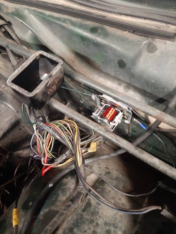

Pic in post#1 looks like the old pre electronic regulator. If so there should be only one field terminal on the alternator. The other brush is grounded. If this is the case, I believe the test should be to remove the wire from the field terminal at the alternator and supply battery voltage to it and complete the test a Big John suggested. Lindsay
Yes you put 12 volts to the green field wire, grounding the green wire will do nothing.
Guys I screwed up and wrote to connect the wire to ground. I meant to the positive terminal.
No excuse... I'll edited my post and I apologize for any confusion, especially to @67440NewYorker who did the work.
Connecting to ground for the later (70 and up) is the correct way, but earlier cars, with the single field connection connects to positive.
