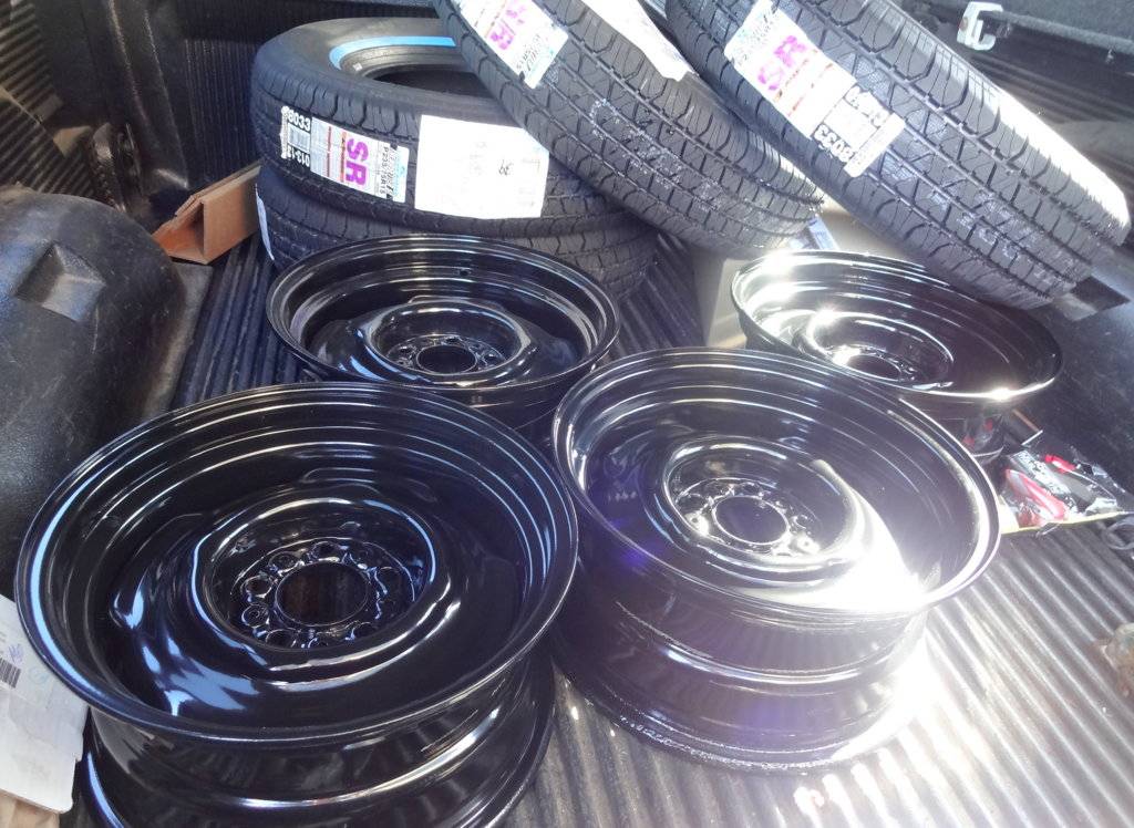

Tires, (235 X 75R 15 Cooper trendsetters), scheduled to be delivered Monday. Wheels are at the powder coaters. A set of 69/70 Dodge wheel covers are in hand.
This will put the car in driving condition.

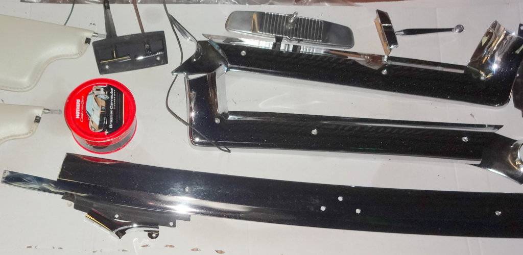

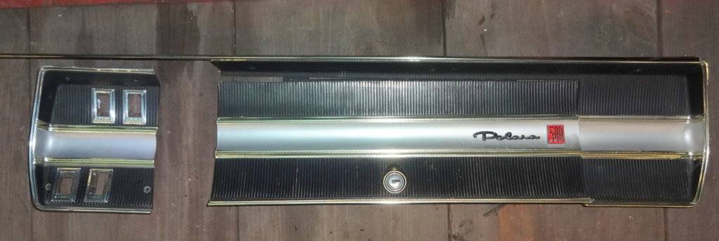

Pic's of the dash panels and chrome A pillar interior garnish moldings.
Brazilian waxing the interior parts ? Get outta here. :D
LOL....... I haven't used that on anything yet. It was just on the table when I shot the photo. The trim pieces were lightly pitted with a heavy haze on them. I used Bright boy cleaner/polish and 0000 steel wool. they cleaned up nice but the pitting still shows in the light.

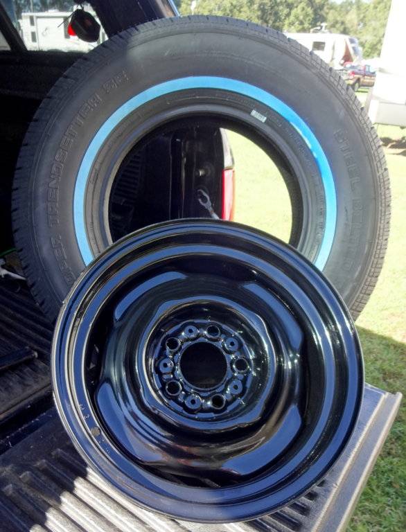

I love the great period look the Cooper tires lend to the Polara. Nice job by the powder coater on the wheels too. These are the "M" body 15 x 7 wheels I got recently. Designed for radial tires. Reduced flex should help keep the wheel covers in place.
