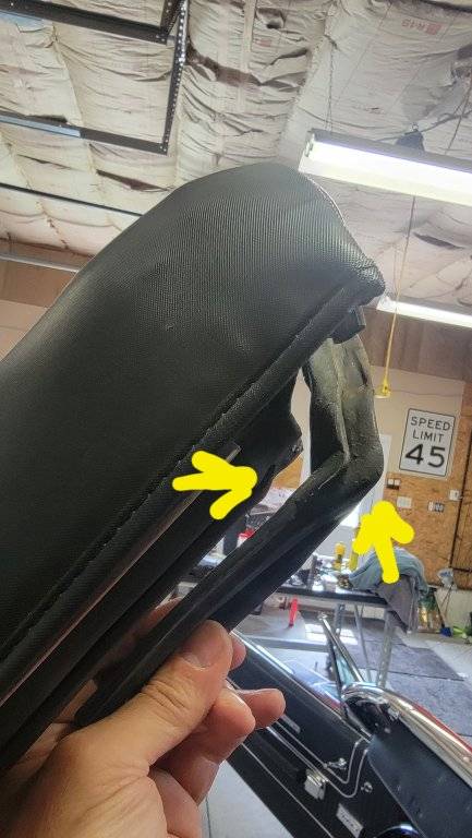

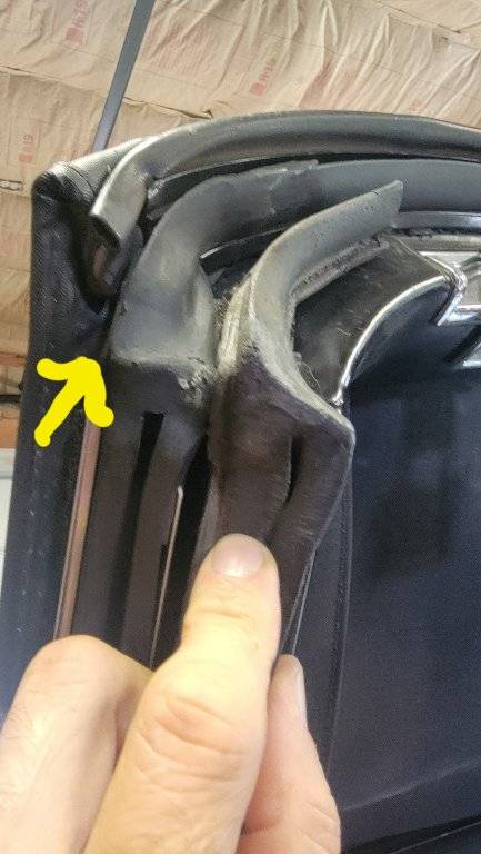

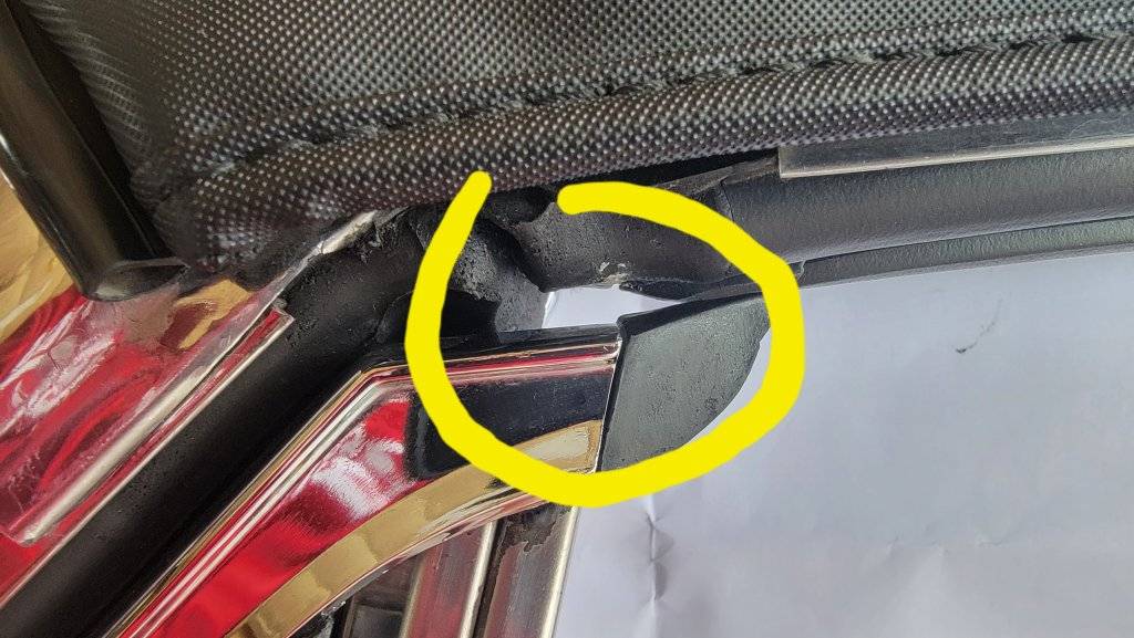

Hey all, this past year I installed new front convertible seal. There is a gap that I can't really solve for, I've sent Steele my original seals and they acknowledge that there is a difference, but they also say that they have sold over 200 sets and only have had a few returns over the years.
So here's my question, has anyone on here used the same set and if so, what year/model have you installed them on, and do you have the same issue? See the picture's I've attached for reference, it's a pretty good sized gap above the wing window frame.

My car is a 67 Fury, I have a wing window frame off a 68 and it's the exact same outside dimensions and shape. so same issue there. I have to wonder if they tooled it off an earlier car etc. The fitment goes from 65-68. Fury, Imperial, 300, Newport, Polara.
let me know what you have and if you can post pictures if you have the gap. Steele sounds like they want to figure this out, so please help if you can.

I put on a set in the last 6 months from Steele on my '67 Fury III convertible. Everything fits the way it should. I still need to get seals for the forward edge of the wing window frame/windshield interface, though.
Weird. Pictures of the areas I showed above please.
