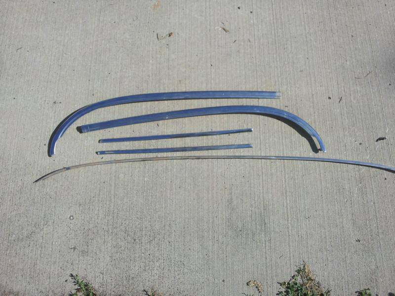

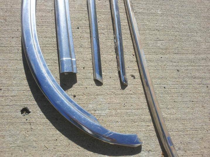

I dug out my trim from a 68 New Yorker fast top, maybe someone can tell if it matches a 300. I know it will physically fit a 300 but I don't remember if it has the same profile.
It should be the same.
4 door is probably different than 2 door.
I learned this while getting new ws for my 300 convertable. Its odd. The 4 door and convert use same ws the 2dr ht is different.
67 and 68, 300,New Yorker,Newport,Polara,Monaco,and Fury 2dr. Fast Top, share the same windshield. 4dr sedan,convertible and wagons share same glass, it's about 1.5 inches shorter, roof to cowl.
