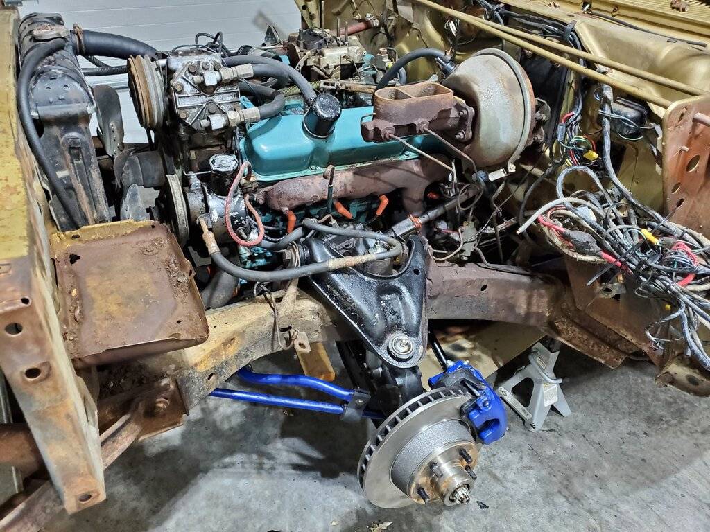

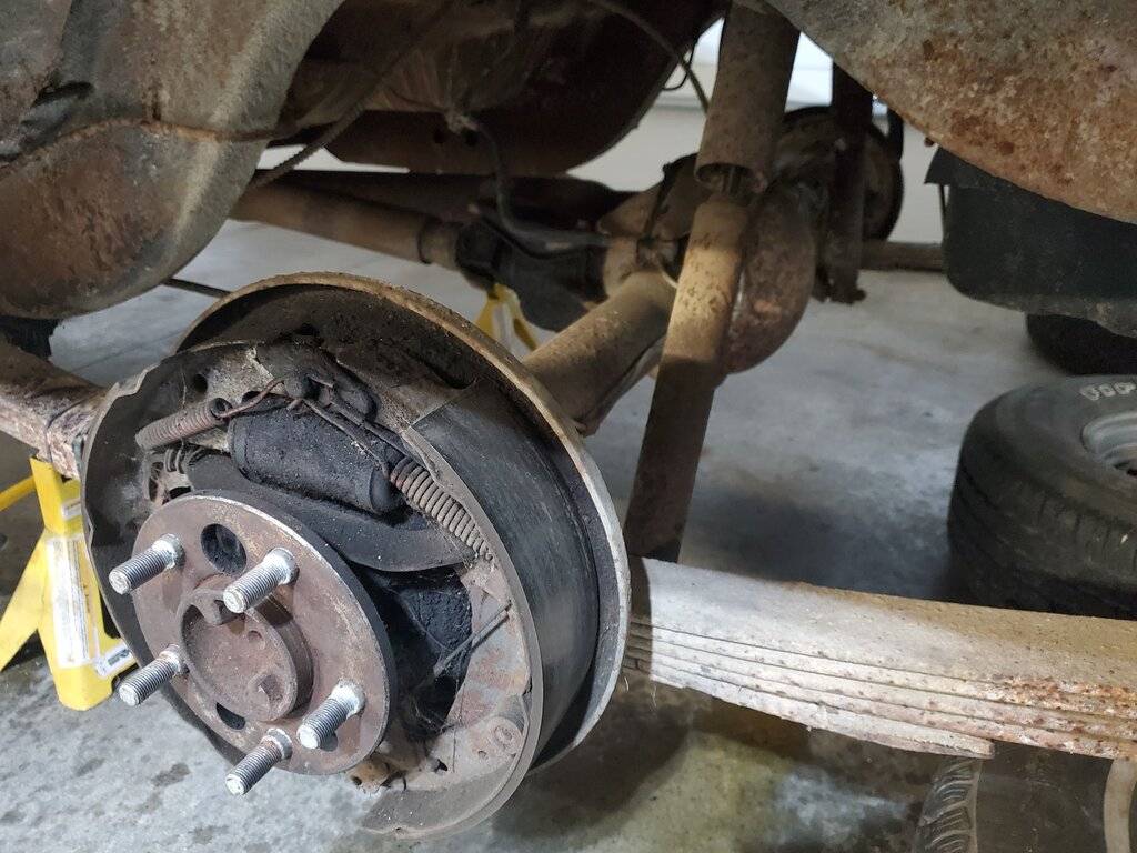

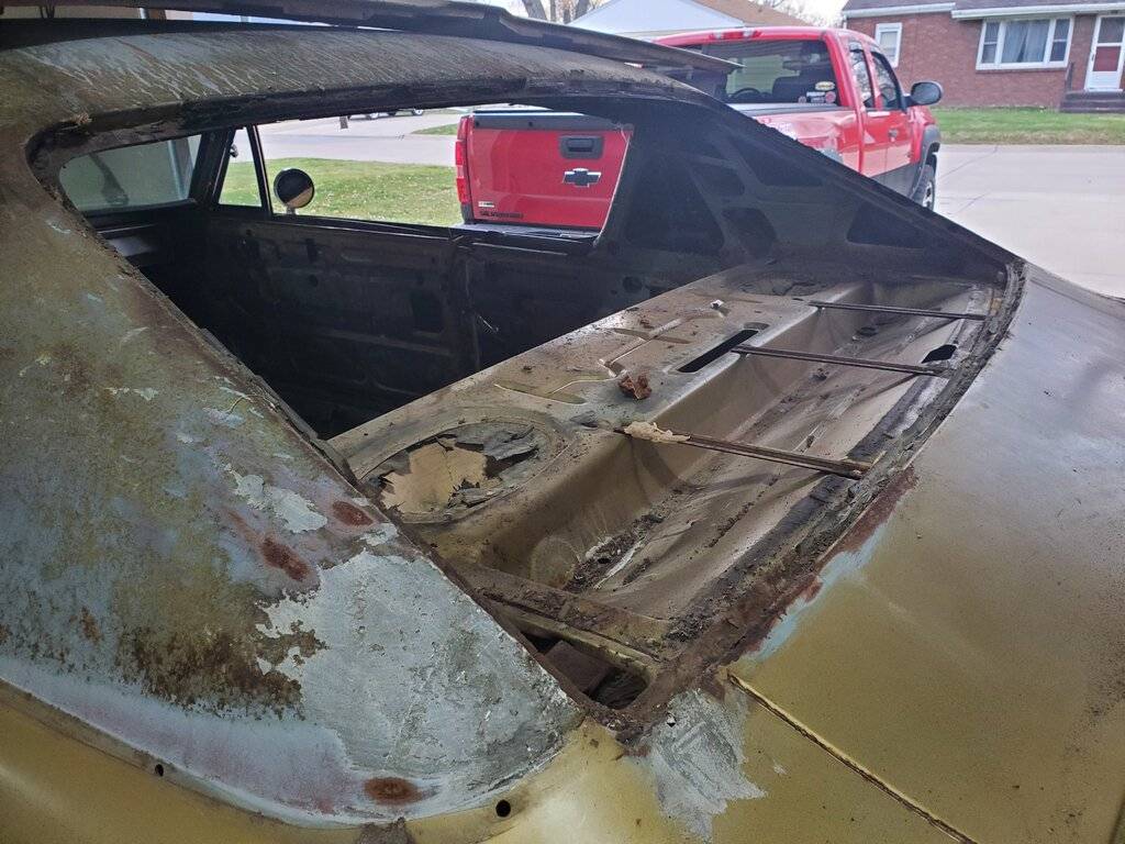

can i fit 15x8 wheels on this car? I'm only reading mixed reviews
The 67 New Yorker picture with the Magnum 500s has 15x8s with 255/70s on the rear and 15x7s with 225/70s on the front.
The wheels were from Wheel Vintiques and the backspacing is 4.5" on the 7s & 8s. The 8s would would fit with no issues on the front as well. Be aware that some of the early brake calipers may stick out past the bolt surface on the hubs and may not clear some wheels.
