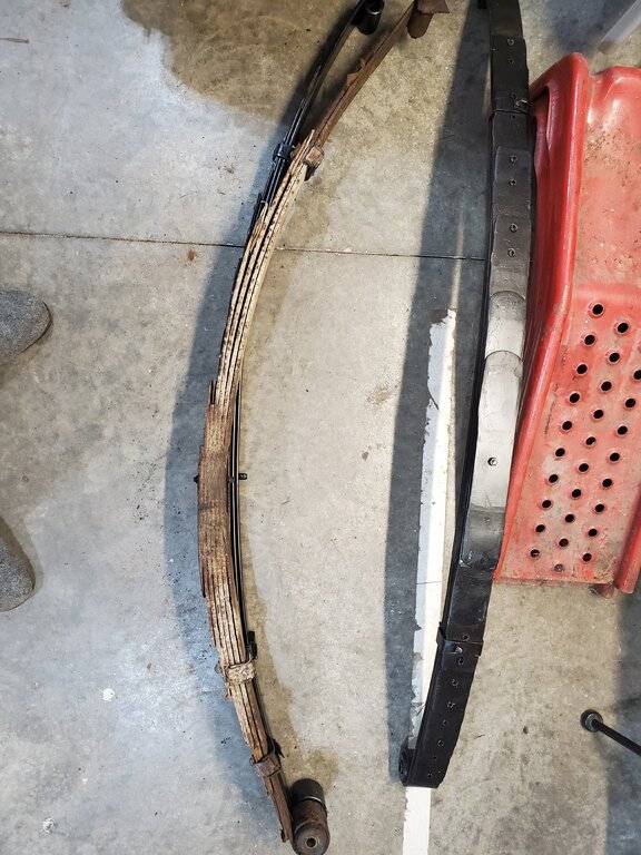

First leaf out... old one sitting on top of new one. What a difference!

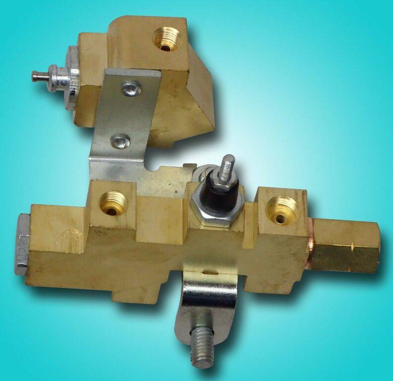

At some point in time Chrysler added a metering valve to their disc brake systems, which is the smaller, separate valve. The only purpose of the metering valve is to prevent early lock-up of the front wheels on ice, so it's usually not a must-have on a hobby/collector car. On the surface, this certainly looks like the best way to go, but the problem is that these China sourced valves have a tendency to leak, especially when used with silicone brake fluid. I recently installed one on a 1970 Challenger that I'm working on, and sure enough, both valves leaked like sieves with silicone fluid in the system.
Mopar Disc Brake Proportioning Valve & Metering Valve Disc Drum A, B, C, E body | eBay
Proportioning valve with metering valve
70-71 Mopar E-body 71 B Body Plymouth Cuda Dodge Challenger Disc Brake Valve | eBay
Proportioning valve only

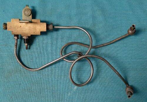

A, B, C, and E body valves are pretty much interchangeable. Front/rear bias was fine tuned with the size of the rear wheel cylinders, not different springs in the valve. The hard part with this choice is finding a decent used valve. This one on ebay is being offered for a reasonable price, but the seller has it listed wrong, as it is actually a drum brake valve.
USED Mopar 1970-74 E-body Disc Brake Proportioning Valve and Lines | eBay
Jeff

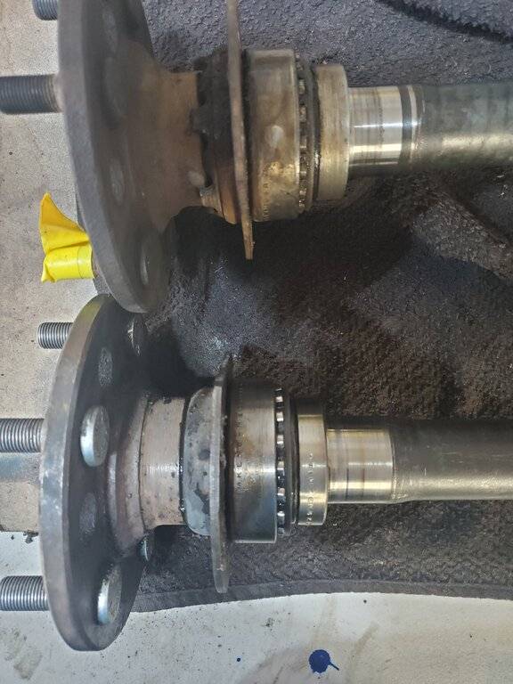

Ok so here's a question. How do I seperate the bearings from the races so I can regrease them? Or, do they not need to be greased. Learning.
You go to Napa and get one of these, then attach it to your grease gun.
https://www.napaonline.com/en/p/BK_7001193?partTypeName=Grease+Injector&keywordInput=grease+needle
Replace the inner axle seals, but don't worry about the outer seal that's trapped by the bearing. That seal only leaks when the grease has been contaminated with gear oil from a leaking inner seal. There are also gaskets on the axle flanges and backing plate. You can replace those if you like or just smear on a thin coat of silicone before putting it back together.
I just did some work on an 8 3/4, including replacing the inner seals. I bought some SKF/CR seals, and they weren't all that great. Ended up replacing them with seals from Yukon Axle, and those were much better quality. I got them from Rock Auto.
Jeff
Thanks again!! I got the ones from rock auto already on the way. When I took the axles out it didn't even look like the bearings had any grease on em. That's why I asked. Gonna take diff out and make sure the inside of the axle is totally clean. And change the oil obviously.
It would be a good idea to put a couple drops of oil on the bearings and rotate them to make sure they are smooth before greasing them. The bearings are a pain in the *** to replace, but better to do it while it's apart.

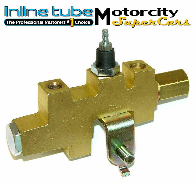

Here's a fourth choice: Simply add this proportioning valve to your rear brake line. Inline Tube is calling it a hold off valve, but it's what Chrysler calls a proportioning valve in the video.
70, 71 Mopar Cuda Challenger Disc Brake Hold Valve NOS | eBay
Jeff
