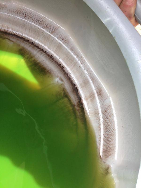

Flushed the system a few times. Flushed the heater hoses. Ran it with water. Some crud but I guess my friend actually did a pretty good job cleaning it out. Water was flowing clean as pictured.

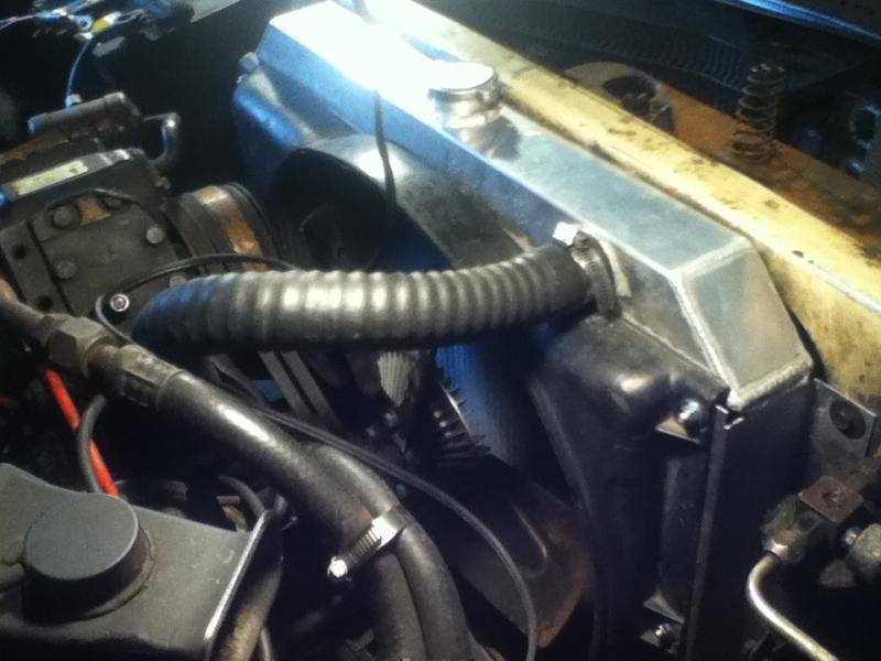

Going to take it back to the friends shop, have him drill the proper holes, then try and put all the new parts on. The new radiator profile is actually slimmer because the mounts aren't extended forward like on the stock one. So there is plenty of room for the new fan and fan clutch. Only issue might be theres too much space and I NEED some sort of shroud.

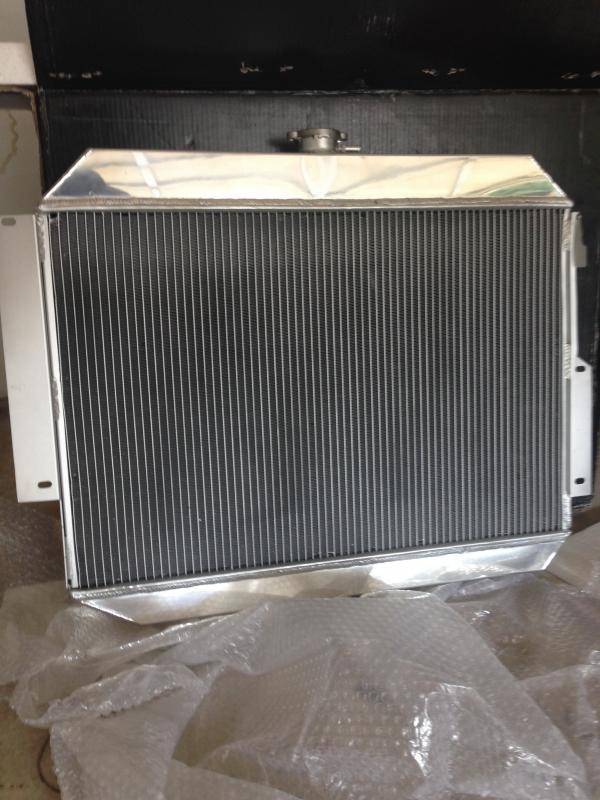

The side you posted is the side that get's mounted to the rad support.
What does the other side of the rad look like?
Does the new rad have a provision for mounting a shroud already?

I don't have it in front of me. However it appears to be the same as 70NPORT just posted. A champion radiator. Mine might just be slightly larger as I mentioned. Busy weekend but monday I'm having the new mounting holes drilled and then replacing the water pump, thermostat, new hoses and putting it all back together. With the clutch fan. And then I will get some measurements for what I can use for a shroud.

I will probably be interested. As I said car is not with me at the moment so can't get any measurements. I can post the measurements of the radiator I bought. Maybe that will help...
· Overall Dimensions: 23 1/4" high x 29 1/2" wide x 2 3/4" Tank Thickness
· Core Dimensions: 17 1/2" high x 26" wide x 2" Thick (3 row core)

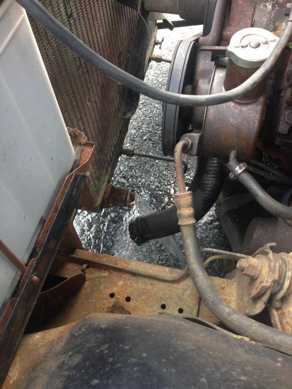

Got the aluminum radiator mounted up. Went pretty smoothly. had to drill a couple holes, but nothing crazy. Took the thermostat housing off to find there was no thermostat installed. I'm assuming this wasn't helping anything. The upper intake manifold below where the thermostat should have been was rusty, and had been empty and sitting for 3-4 days so I had to chance to clean it a little but it didn't look good. Installed all the new hoses filled up the system and started it up and things looked good then noticed that coolant was leaking from one of the thermostat housing bolts. My father tried to tighten it and went a little crazy and stripped the bolt. Half of it is still in the thermostat housing the other have snapped off with the bolt head in the wrench. Now I need to get a bolt extractor and new bolts for the thermostat housing. Also below is a picture of the old coolant after flushing the system. There was no oil on the surface but some crud for lack of a better work at the
