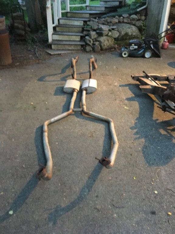

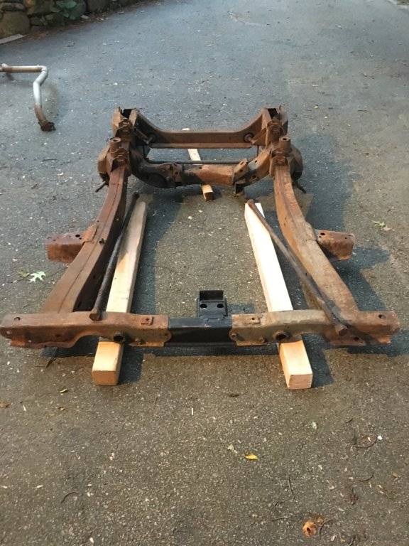

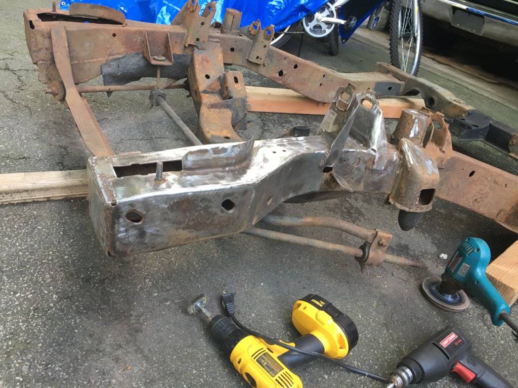

    Ok. Its been awhile folks. Work, travel, family time, vacations....you know the drill.
    Got a stub frame, fender, dual exhaust set up, torsion bars, some suspension and disc brake parts locally (a morning drive). Got it from another great Fury guy with some great experience (Thx Paul). Frame is for a 383.....which has a sway bar and excellent shape if i want to swap out from a 318 to a 383 in the future. Its solid and better than mine IMO. Anyway - I have some PTO and getting ready to clean off the new/used frame. Did some quick test area with a wire wheel and sanding disc. cleaned of quickly. Looking forward to it. Goal is to have stub frame swapped out this fall. I will upload pics as it happens.

    15 mins in with a wire wheel and sanding disc....the frame is starting to clean up well!

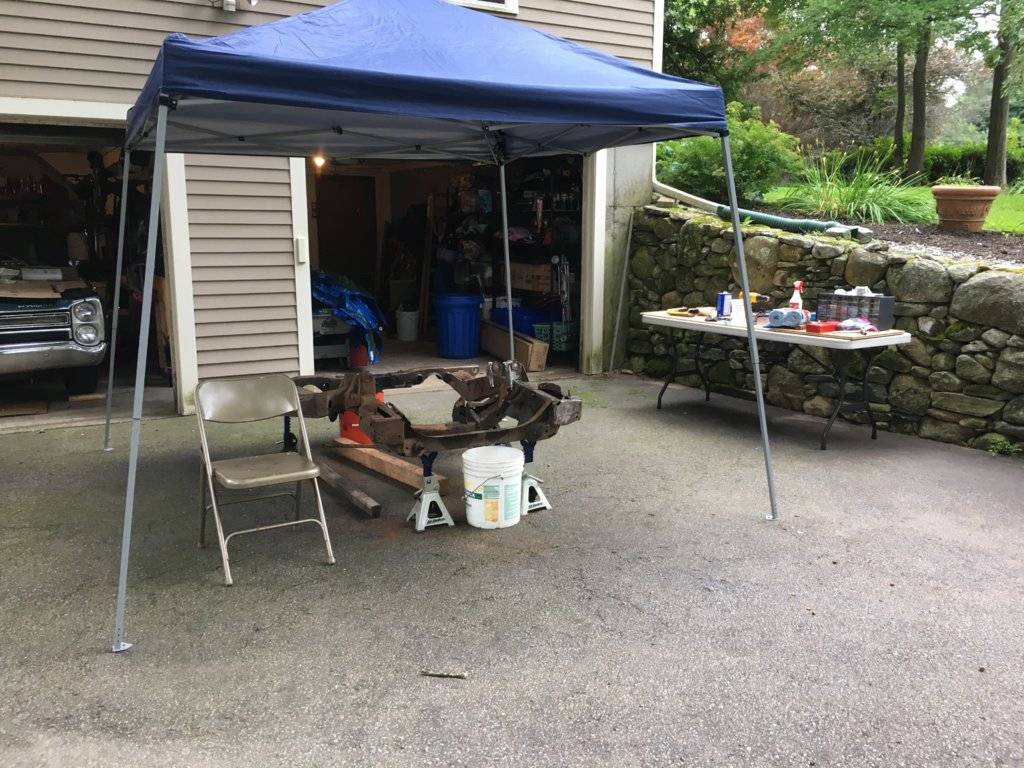

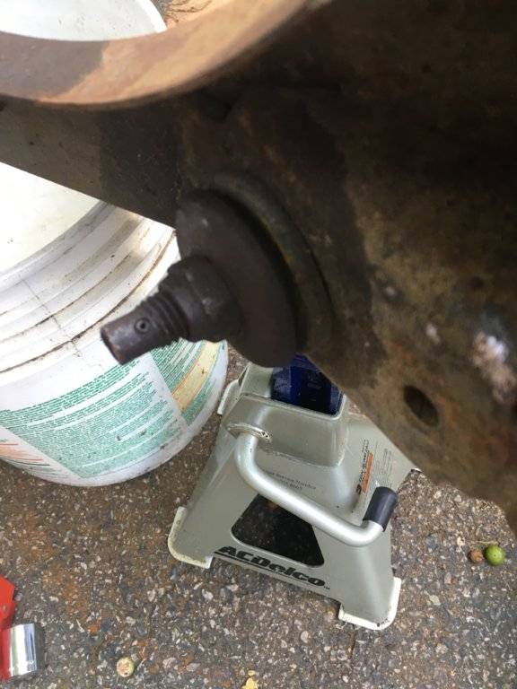

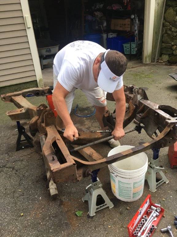

    update....back on the frame again. Little at a time.
    Now that we know that the rust comes off easy...I continued to "strip the frame" of ancilary stuff. I removed sway bar assembly and working on strut rods. Front strut rod nut didn't want to come off....so i am soaking it in PB Blaster over the next couple of days. will try the use of vise grips or channel locks to grab the other end of the rod.....or place double nuts if i can find some 9/16-20. Eastwood Rust Encapsulator Platnum and Chassis Black Extreme (satin) on order. Also ordered couple cans of the internal frame coating. Overkill - maybe - but my gut says its best to do it now while frame is accessible.
    Some friends coming over Saturday. will finish wire brushing/sanding frame, control arms and other suspension parts for new coating. Hoping the Eastwood all arrives before the weekend. Will place order for new bushings after the suspension parts have been painted.
    Kids didn't want to help out this time around....but willing to take pics on there way out to the beach! LOL

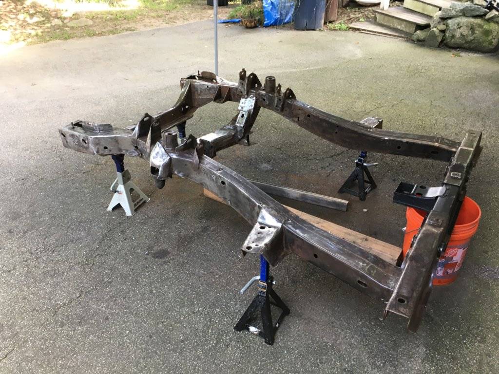

    BC85AFB9-14E7-4AC3-9DEC-E59E94A154D9.jpeg 372B15A5-DC42-4EB8-B192-ED69BB99FE45.jpeg B8C47A11-27A8-4B3A-866B-1D441C93426B.jpeg Good day of work today. Friend officer O’Sullivan stopped by to lend a hand. My done helped a few minutes as well.
    Removed remaining bushings, strut rods, skirts, clips and ancillary bolts. Bagged/tagged. Sanded and wire wheeled the frame clean. Put on first coat of Eastwood platinum rust encapsulator. Dries hard as a rock. Will flip frame tomorrow for touch up and second coat. This looks great! Neighbor came over thinking I bought a new frame. Had a cold beer and hit the showers.
    Lesson learned-
    1. DONT get this stuff on your skin. It’s a B+#$ to get off! Need baby oil and scotch brite sponge/pad if it has dried.
    2. Put drop cloth under frame for any drips
    3. Take the time to remove all bolts, clips, clean off nooks/crannies of grease or dirt - no short cuts. Missed some spots that needed some quick cleaning....which will slow u down.
    4. See # 1.
    Soon I will figure out how to clean inside the frame tubes as best as possible and use the Eastwood internal frame coating. Then spray everything on the outside w chassis black. That’s the latest. Pics attached

    Looks great. Buy some good quality rubber mechanics gloves for painting.
