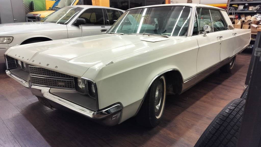

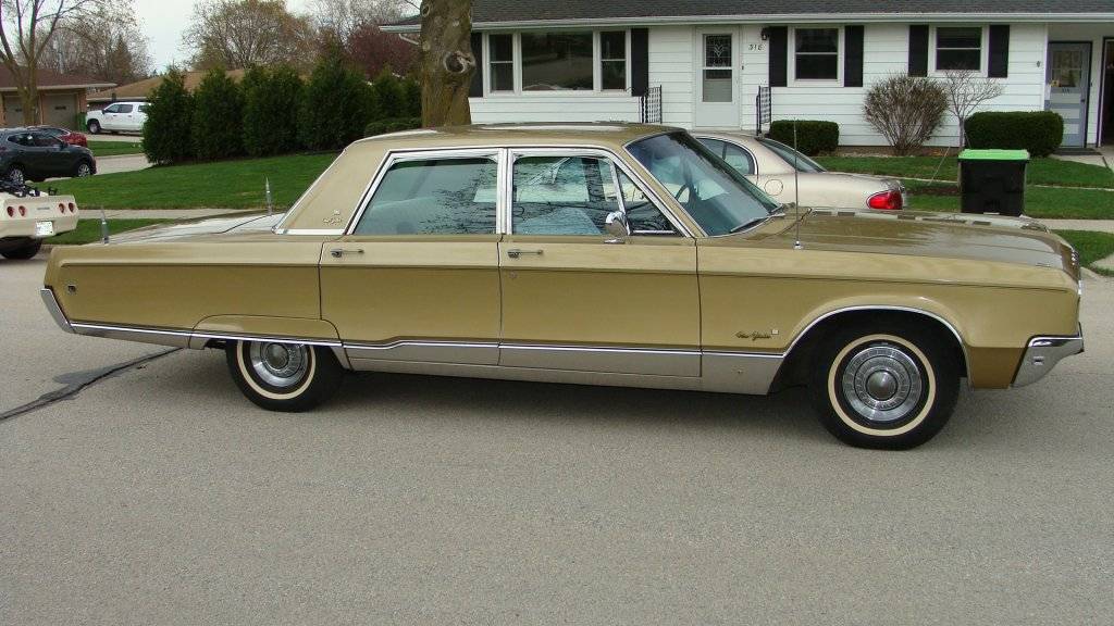

Just recently acquired this really clean and original 1968 New Yorker. Northern California car it's entire life, I have found a bunch of original papers with the car. It's had a history of two families before me. It was driven until 2014 then It sat on non-op. Must have been under a tarp for some time because the interior is moldy and has surface rust on the ceilings and trim pieces, as well as the inside of the trunk top. Everything else on the car is completely solid. I was looking for a classic prestige car to turn into a daily driver, and look cool at the same time, I'm a Ford guy, but this car came up and everything looked good and the price was right for a car this age that is running. So I am new to the Mopar world and am going to be learning as I go. I intend to build this car into something that I can use daily for short commuting and longer trips, and not cringe about it being in traffic or on our modern destroyed roads.

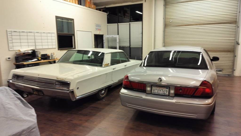

Look how much bigger it is than the Mercury parked next to it.
Welcome and congrats on your purchase. Quite a contract in styling between the two cars.

Great score. What engine? Cooling system rebuild, brakes, suspension, electrical, tires make for a goos driver. Nothing hot rody, just the stock stuff all up to spec.
Firm feel can make you a front sway bar that will really help with the daily road feel, also good shocks. Basic improvements can make a huge difference. The Nexxen AH5 235/75r15s do well on the old Chryslers. The C-posts on your Chrysler should have a vinyl cover, that is why they most likely have rust. Repair the rust and having the vinyl replaced will help plenty in the aesthetics of your new daily.

It's the 440 , the Odometer reads 40k. As far as I can tell from the records I have, it has not rolled over to a hundred yet. Underbelly is pretty gooey, so lots of new seals and gaskets are in order. First step is going through the entire brake system with all new everything. Axle seals are leaking as well. Already got some cheap tire from Walmart to roll around on for now. Also going to rebuild or replace the carb and new ignition components all around. The C pillars are actually not rusted (so far) that is just dirt caked on behind the vinyl that was peeling.
