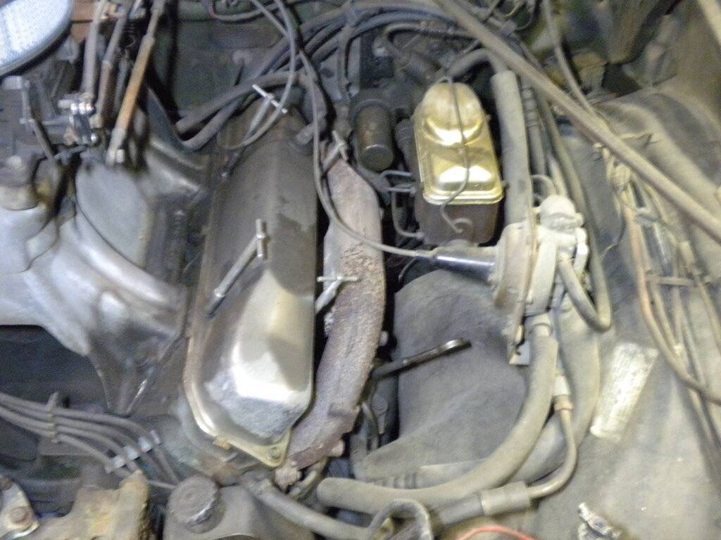

    the ultimate solution: newport 008.JPG

  8. Davea Lux

    What did you use the hydraulic booster off of?

  10. rags

    mark V lincoln. along with the disc brake rear. p/s pump brackets from '76 new yorker.

  12. 65sporty

    The Hydroboost

  13. commando1

    I had to Google that.
    Why didn't it work?

  14. 65sporty

    I am not quite sure I am following you, Rags has it and says it's the ultimate solution. Carl needs it or a vacuum pump because of the low vacuum.

  15. rags

    exaclty. thank you, sir.
  16. fury fan

    When I first saw that, I thought it was the Teves electro-boost from the 84-92 Mark VII. Those are a 'neat' item but not suited for retrofit as you must learn how to repair them yourself. Still have 2 in my shed from my Mark 7 days of 15 years ago.
    Another option for a low-vacuum engine would be to convert to manual disc brakes - circumvents the vacuum problem, and better brakign to boot.
  17. rags

    no. i wanted something that would work. and not exactly a bolt-in but close to it.
