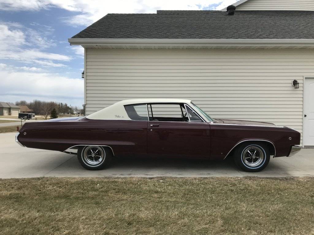

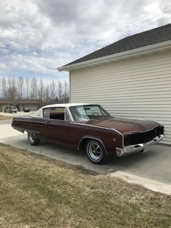

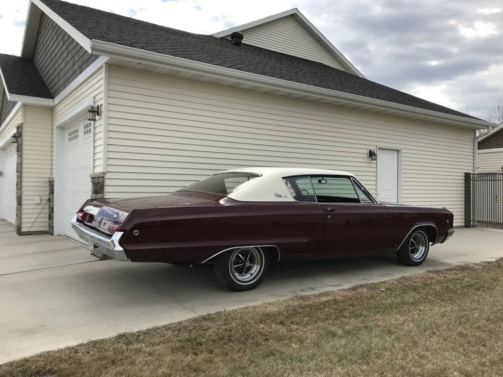

    Out side picture and video after I took it around the block. Now I need to finish my door trim panels, strip my trim and get it to the exhaust shop.

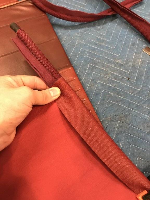

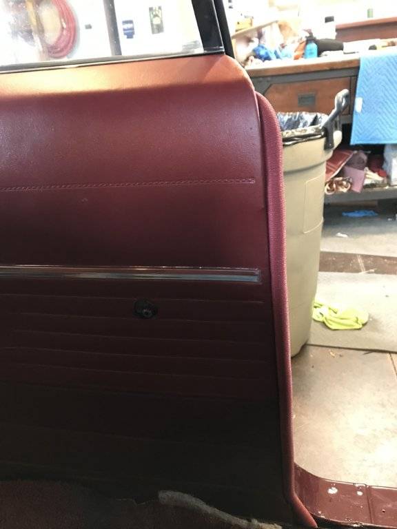

    I used. Chrome tape to replace the old vacuum chrome on the door panels. I think it will work ok. It would be easier if the strips came off but they are embedded pretty good. I just hav to line up the top and slowly press it down. You can see the peeling original to the right.

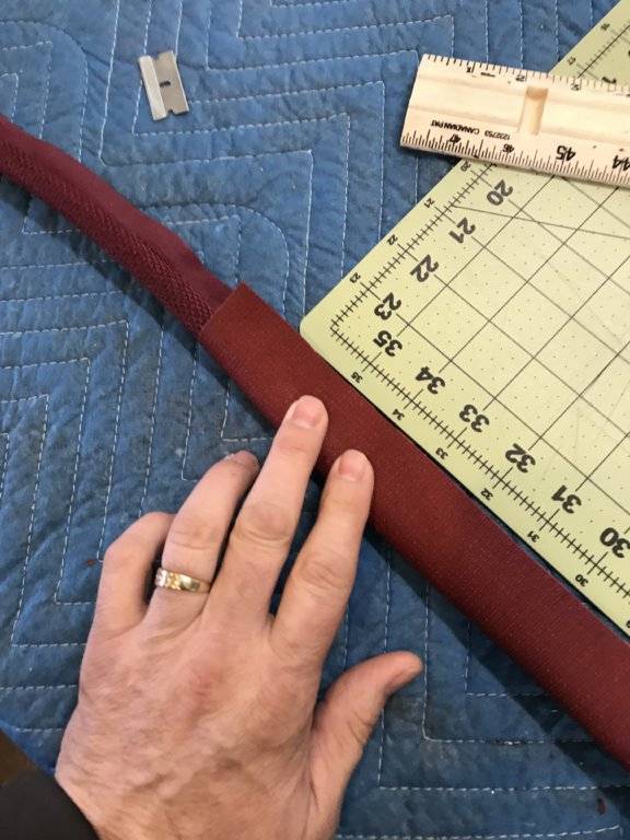

    I have to do something different with my windlass. The purple they sent me isn’t going to cut it. I do hav some left over headliner material. Maybe I may use that until I find the right color. Supposedly this was as close as SMS had?

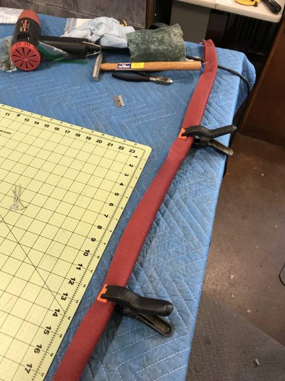

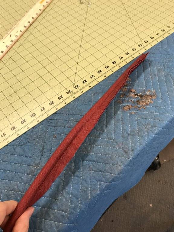

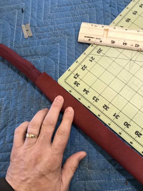

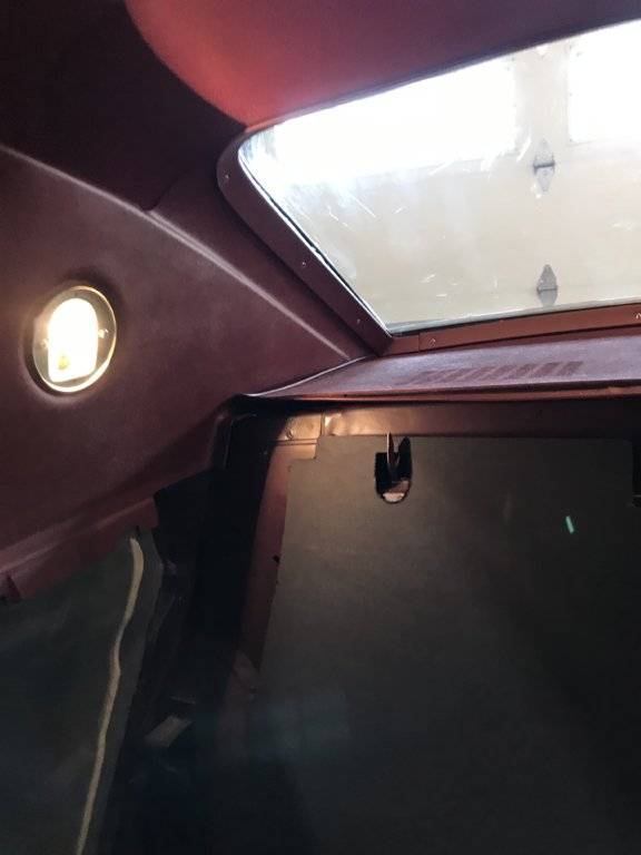

    I re- made my windlass today using a leftover piece of my headliner. I think I actually like it. Because of the pattern it actually looks kind of close to my original.

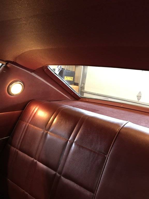

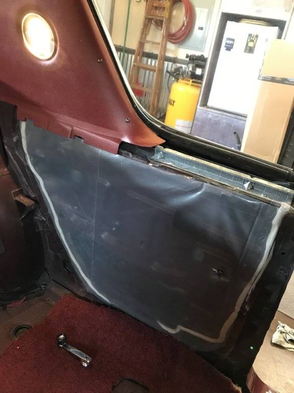

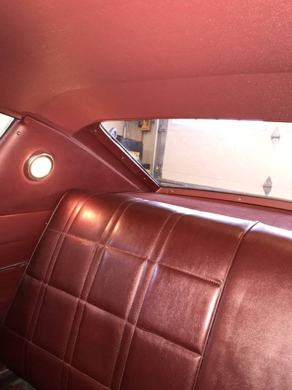

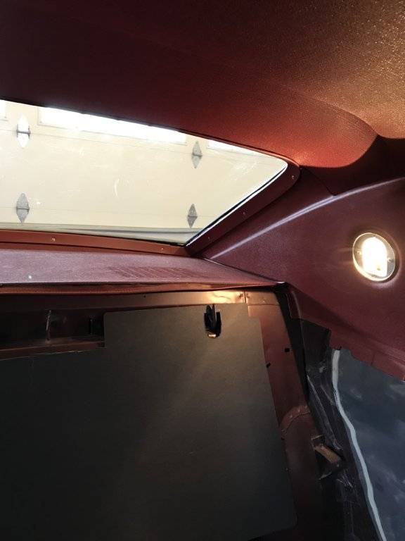

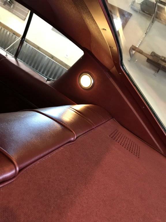

    Rear back almost put back together. Package tray, sail panels, windlass, and rear door panels. Seat belt installation next. Waiting for my tags to sew on my seat belts before I install.
    97AAA6EC-6799-4DB2-9B84-DA0FED74914B.jpeg D9D31B91-1887-418C-90C4-21592A830D92.jpeg 3F75A5A6-1EB7-4B17-8D74-B28D5D8E5EAA.jpeg 5B54777A-1014-4B75-89C3-42E9193109AF.jpeg

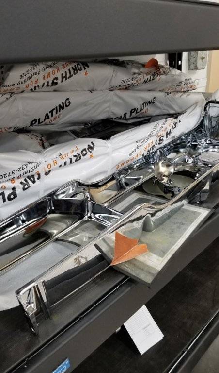

    Today was like Christmas when I got home. I received news that North Star plating finished my pot metal plating. Headlight surrounds, grill, tail light filler panel and tail light bezels. They struggled with my headlight surround, but finally got it on try 13. Should ship Monday.
    Also received the Aurora conversion of my radio from Gary Tayman, vacuum advance and extra points and condenser from @halifaxhops.
    Arm rest bezels, and rear window cranks, and some tags from @dart4forte.
    Right now my nemesis is my left front wheel well trim. Which I have been looking 10 years for and still have not found. I guess I need to learn to bump aluminum and try to take the rock dents out of my old.

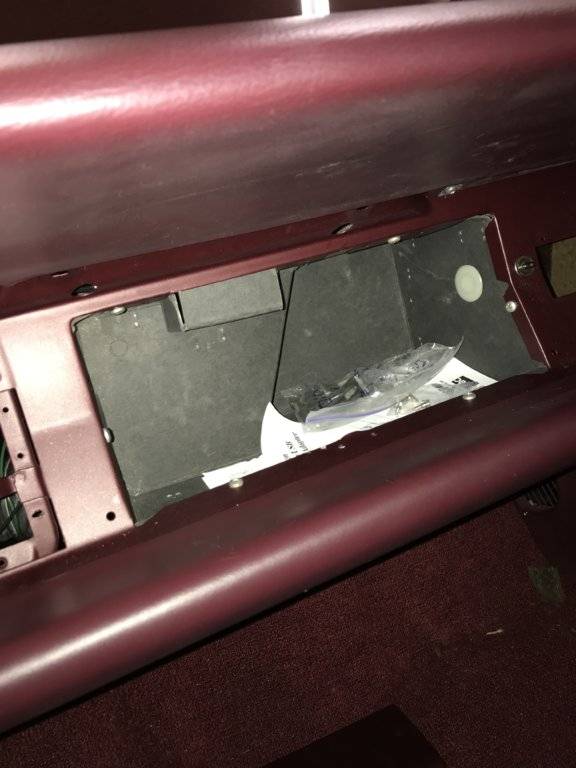

    Mother Fruther. Chrysler did not think about making the glove box easy to replace or install without taking apart the dash. I had a repro glove compartment kit from REM. You cannot slide it under the dash and you cannot slide it in from the front. ( without some distortion. Opening is about 5” tall and box is 5-1/4” tall. My first step should have been to fold in the lower front part. I had to compress the sides and force it in. Not much room behind it either. I got it in to find that REM only had half of the holes in alignment. Was able to pry the screw tabs off and put them where they belong.

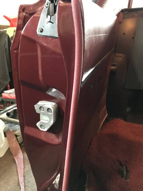

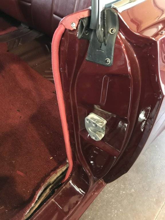

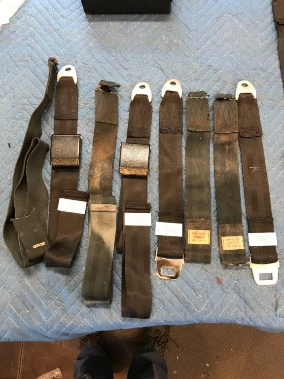

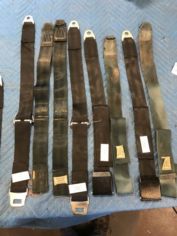

    Seat belts remade, detailed the hardware and sewed on some original looking parts tags. Have to mess around some more with my right retractor. It seems to have expanded and doesn’t want to roll up as nice as the driver side.
    Old and new side by side and tag on
    CD853D7A-A8DF-4428-8A5F-0D96F28C18F0.jpeg 09A978E4-32C1-4962-8C5E-EDF42F8DAAB1.jpeg 68CE9A1A-1A72-4AC9-BF2C-71B2DA43E211.jpeg
