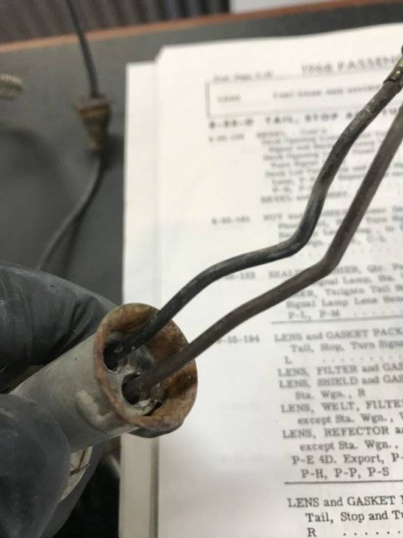

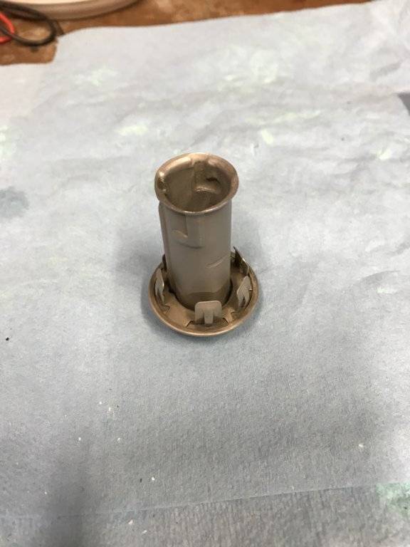

Tail light harness needs a complete rebuild. Years of sitting with a the trunk lock missing let some rust in and corroded some of the sockets. It seems the side marker lights are somewhat available as they were used on all models and a parts search called them out as a mid 60’s ingnition switch socket. (Either it is true or the 68 parts manual is in error) section 8-14-3. P/N 2097 003. This was the first year for side marker lights so maybe ma Mopar used something existing.

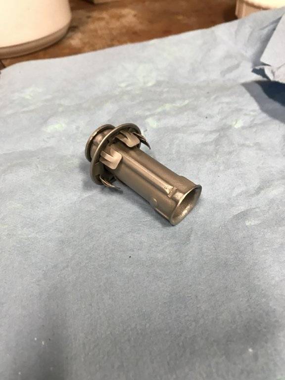

The backup light sockets are common with other body sizes for the Basic and Medium models, so can find them around. The tail, turn, and brake light socket is Polara only so no online luck (did not search salvage yards). I ended up taking them apart and blasting, acid etching, and tin zinc plating them. They seemed to turn out ok.

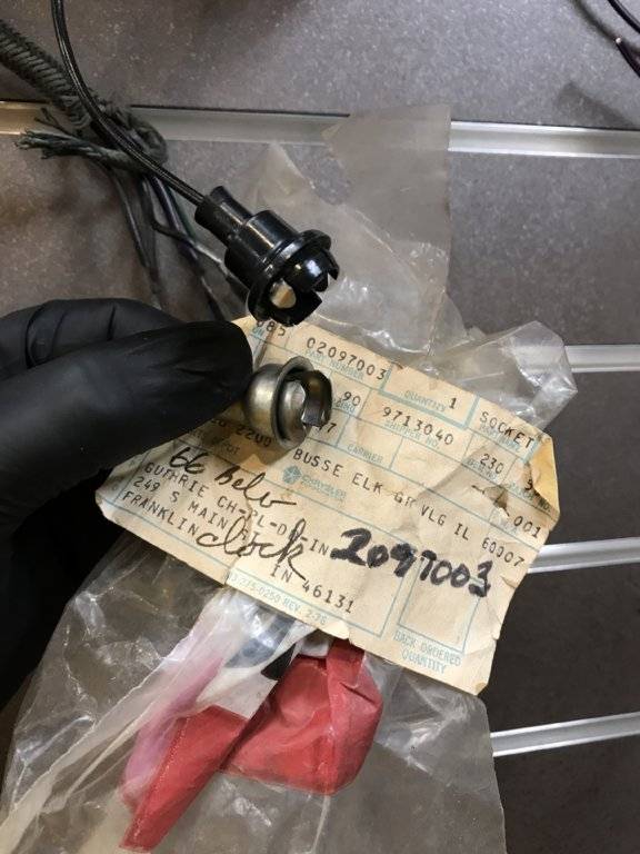

A couple of posts earlier I mentioned that the rear side marker light socket P/N in my parts manual was 2097 003 and was for all 68 models. When I did a search for the parts the descriptions kept coming up as an ignition light socket for 65.( the handwritten note on the tag says this one is for a 66 Belvedere clock)
I went ahead and ordered one. It is different than what I have. However it looks like it would fit the hole. (Probably does a better job grounding as it is all metal. My assumption is that someone figured out that the one piece metal assembly grounded than the two piece plastic and metal.
Plastic original on the top,replacement NOS Below.
Since it doesn’t match the original on the other side, I took another look at my original that was rusty. I was able to take the metal socket out of the plastic, blast, etch, and re-plate. At some point I will have to list the all metal NOS part for sale.

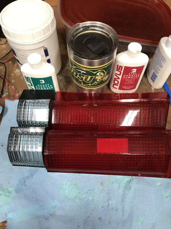

Tail light lenses polished up nicely. Not bad for 50 years old.

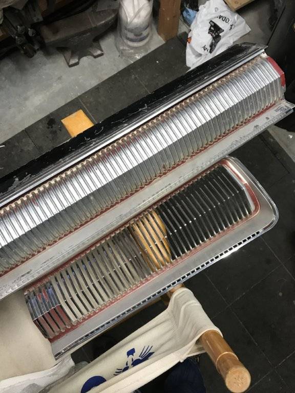

Next to detail the rear filler panel. Will be a challenge to detail as every grill space is painted red. If anyone knows the correct color red let me know. I am going to try to polish the chrome There is a some small pitting. Then some sanding and re-apply the argent silver and red. If not I may see if the chrome place in Brainerd can re-chrome. (If they are still in business). It may be worth the 2-1/2 hour drive to talk to them.
Holy crap those lenses look amazing! Great job, man!
They were well protected behind he chrome bezel's. And if I recall correctly this car spent most of its life parked with it's tail to the North, so not a lot of sun fading. I do also have to give credit to Novus plastic polish. I was first introduced to it when my neighbors, who worked for an instrument panel manufacture, helped me polish out the curved plastic windshield on an old 68 Silverline boat. They used the polish on their assembly line to polish out any scratches on their newly assembled Instrument panels.

Does the kit also come with buffing pads or can you use a generic one?
I just hand polished with shop rags and finished it off with a micro fiber cloth. For deep scratches you could probably us a cloth buffing pad on a drill, but would have to be careful you didn’t get it hot enough to permanently mar the surface. I think the kit came with what looked like paper shop rags anyway.

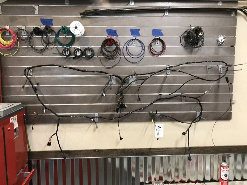

Engine harness complete. Wires replaced and re- wrapped. If I had access to the original connector types (molded rubber over crimp). I may have replaced more. If it had a special connector and if the wire was fine at that point but bad further up the harness, I would splice with a waterproof connector just inside the wrap and replace the rest. If the wire was bad at the connector (my coil wire and alternator power)I carefully cut the rubber connector off and used a sharp tool to un crimp the connector. After cleaning up I re-crimped the new wire and re-applied the rubber connector and sealed it with heat shrink. Not exactly factory, but I don’t have the tools to mold another one. Seemed to turn out OK. If the wire and insulation was fine and not stiff from excess heat I left it alone.
Another lesson learned: You can never take enough pictures of how the harness lays and what side of the loom the wires come out. I am sure I will have to do som twisting to re-install. Mark your old wires where they exit the loom and replace the wire at the same time as adding the new one.
