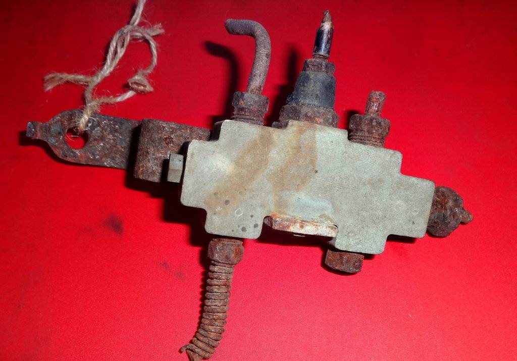

    Here is the metering valve I have.

    That is not a metering valve. That is a brake warning light assembly. If you are going to do a disc brake conversion, you will need to keep this type valve. See yesterday's post by moparsteve, the metering valve is on the frame fail at the L/R brake line split.

    That is exactly where this unit was mounted.
