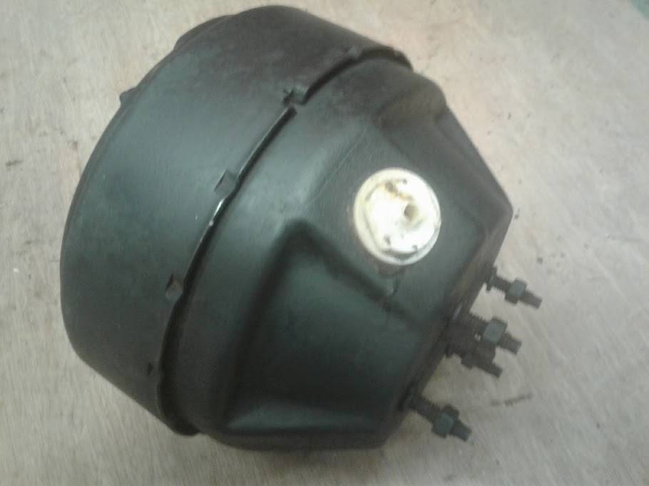

    I stumbled across an old rusty booster I thought was from a C Body, I sanded it down and spray painted it black and sent a pic of it to boosterdewey, they Id'd it right away- good guys. It was a 67 Hemi booster. I had no idea.

    Sell it for hemi prices. I had the same thing happen to me at vatozone for a E-body
