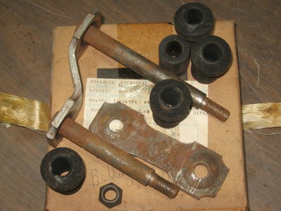

Stan those look like fuselage shackles....I wonder if Formal shackles work...
www.ebay.com/itm/NOS-Mopar-1974-77-Dodge-Plymouth-C-body-rear-shackle-package-/371114412965?hash=item5668248ba5&vxp=mtr
Gary, I have the NYB up on the lift as we speak. I can take measurements for you if you want...
Nice work. Lol yes that "jog" in the left side of the shackle has got to be there for a good reason.I am going on record to say the the style of the set of shackles for the Fusies has to be where 1 shackle has to be a straight and the other side of the set has to have an offset shackle or you will have proplems. The top is wider than the bottom. Using two straight shackles will,
1. Force the bottom inward so you have a trapezoid
2. You will force the centerline of the leaf end off to one side therefore the whole leaf spring isn't parallel / perpendicular in its location.
I think I have a line on a pair already.
