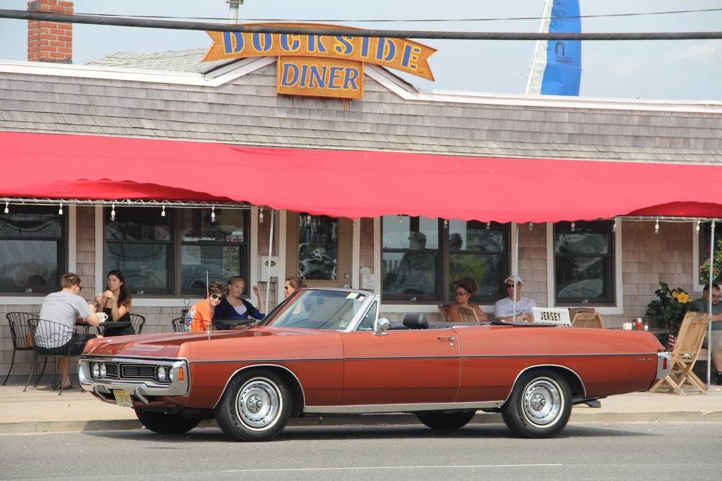

Not sure of the stock height, I can measure mine and let you know. Do yourself and the car some justice and replace the springs ...You wont regret it. Springs and hardware are under 500 an
d it will be the best suspension upgrade you will ever do
