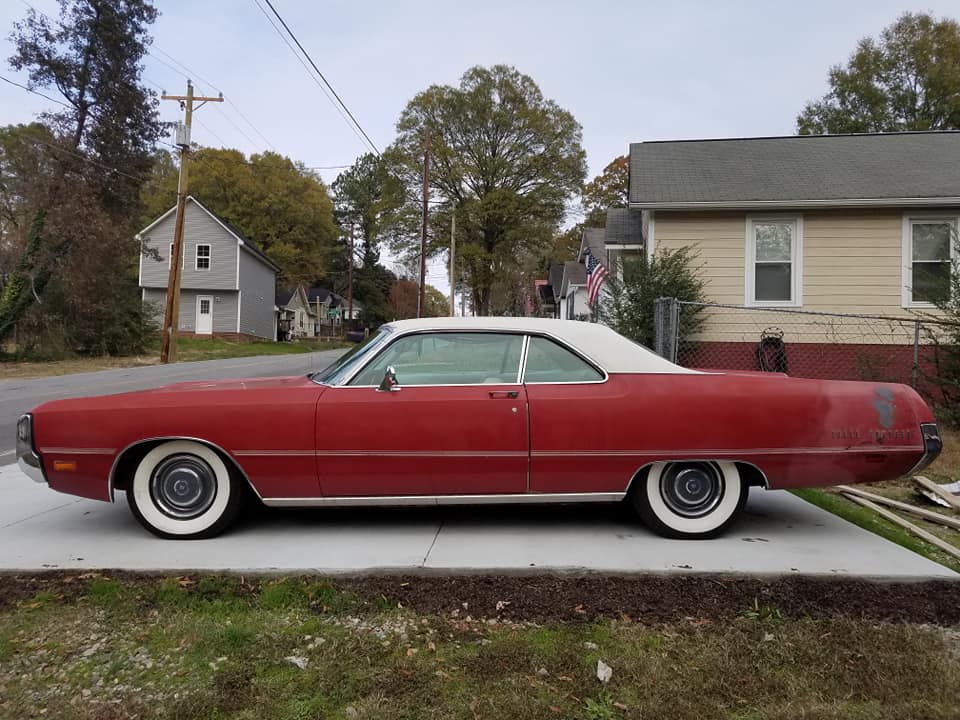

Should there be any differential between the front and rear ride height? I have a 69 300 and always noticed a bit of a rake in the car's profile. I remember the revious owner telling me he had planned to make it a low-rider (to each his own...) and may have already begun by lowering the front.
Measuring ground to the bottom of the car nearest respective wheel wells, the back is 9 inches and the front is eight (25 inches to the fender lip). This is on 225/75R15s.
Also, I know the front ride height is a simple matter of adjusting the torsion bars. How is the rear height adjusted (leaf springs and shocks)?
I think thewide whites make the car seem lower. The back looks correct, but the front seems slightly low. Here are some photos from the 1969 Chrysler catalog for you to compare
The front looks too low. I would adjust it to factory spec if someone here can tell you what that is. The rear can't be adjusted. You would have to replace the springs. I've had good luck using those shocks with coil springs built into them for raising the back. Disclaimer: if the leaf springs are worn out, it's best to replace them, shock mounts weren't really made to carry the weight of the car.
That being said, I think the rear looks OK in your picture.
Your driveway has a slight slope to it. You'll need to take your measurements from a level surface. I think it looks great as is. Wish it was parked in my drive.

Here's my general rule of thumb . . . the rocker panel needs to be parallel to the ground (flat surface). If you look at factory pictures, you'll also see that if you extend a line from the lower rocker panel side through each of the wheels on that side, there is a general relationship of where that line crossed the center of the wheel cover/hub cap, too.
Then follow the procedure in the FSM to ensure the front end is at the correct height on each side. If the rear is low after doing this, then some way to raise the rear can be investigated.

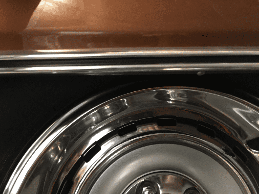

FWIW, this is a pic I took a while ago to answer a similar question. This is my '70 300. I installed new springs that were "stock' height a few years ago.
As you can see, the fender lip is about even with the rim edge. Looking at the entire car, it looks a little lower... Camera perspective being the difference and why you can't got too much from some pics. The upper pic of the wheel well were taken a few years after the lower pic. Both after the new springs were installed.

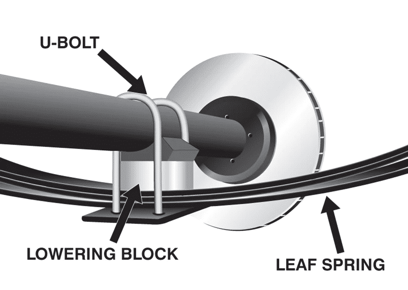

Lowering or raising a leaf spring suspension from the rear - there is no "adjustability" built into that design. Once can change the height by adding shackles or lowering blocks:
1) LOWERING THE REAR: blocks can be placed between the rear axle housing and the leaves themselves - the leaves stay in the same position, but the axle sits higher by the thickness of the block above the leaf springs, and hence, higher up INTO the body of the car, effectively lowering the car. You will need longer U bolts.

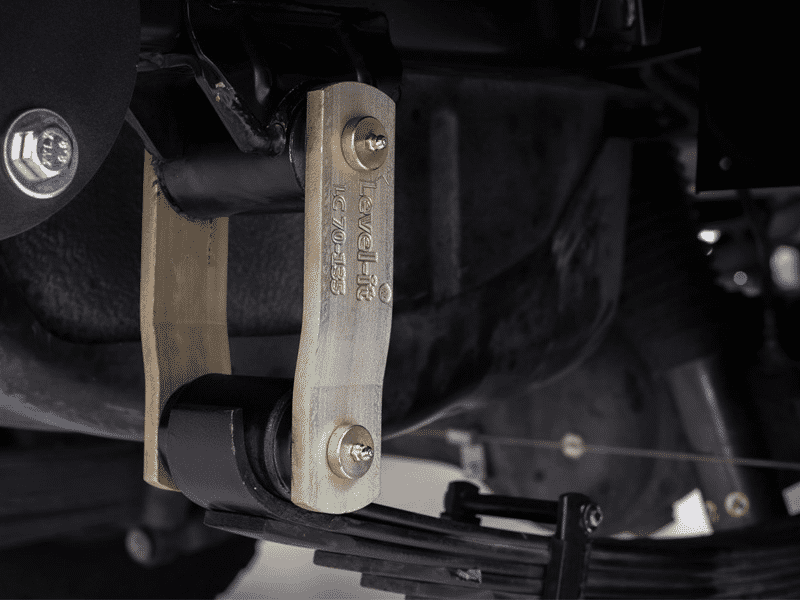

1) RAISING THE REAR: shackles that are longer can be placed on the rear spring hangers, raising the car up. These weaken the suspension strength, and are not recommended. The points at which your leaf springs are bolted to the car are designed with a certain amount of pivot and flex - extending those puts exponentionally greater amounts of those forces into play, potentially with bad results.
