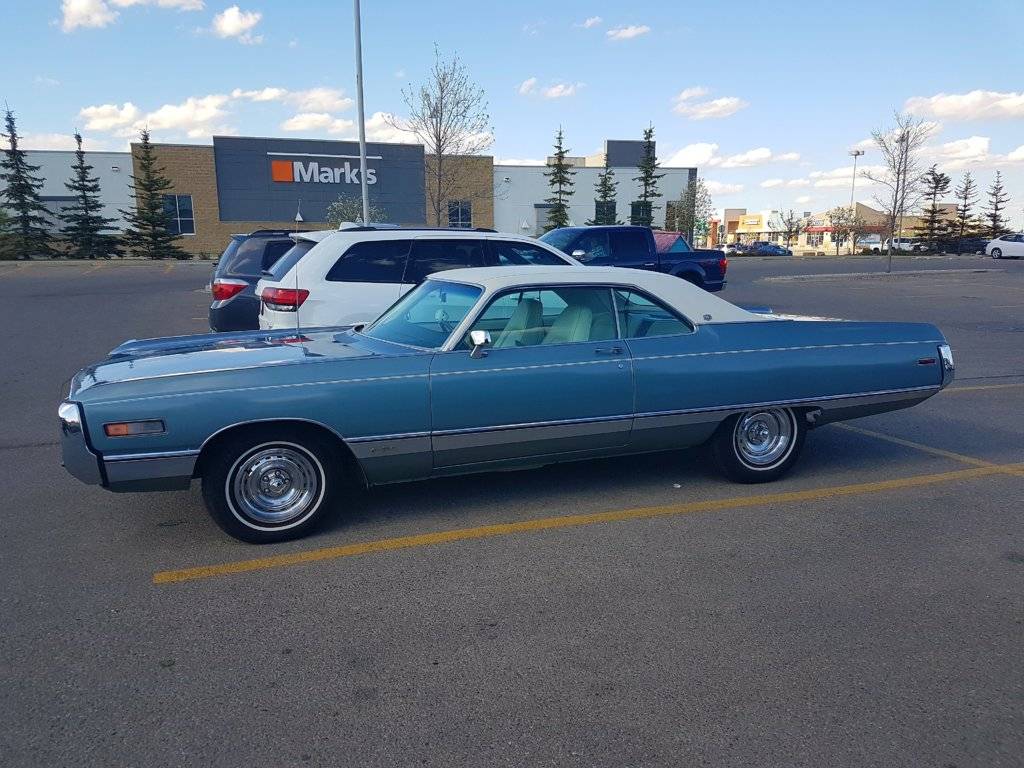

Hi folks I just wanted some thoughts. My 71 Ny was working good than one evening it just wouldn't start and it's been that way for a few days now. Turns over well but just want catch. I checked the fire with a spare plug and it was firing fine not sure how bright the spark is supposed to be but there was lots of spark. Fuel going to the carb also. Question will the plug still fire if the points are done. The previous owner gave me all his spare parts he accumalated over the years not sure how long he had the car I think 5 years but later as I went through the parts I noticed two or 3 sets of old points is that normal?I am so used to the electronic ignition set up. So it worked one day then died. I also replaced the resistor with a known working one I replaced the voltage regulator this spring..any ideas or suggestions I would be all ears thanks guys.
Also before it completely died it would run slightly as if a plug wire was off and then stall. So I checked all the connections on the wires both at the plug and distributor all good..thanks. Also it has a newer coil.
