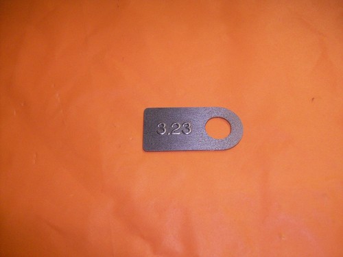

There should be a tag on the gear housing, like this one
Unless it was swapped out, that tag should be there.

Idk, i looked for the diff tag underneath on the pumpkin, didn't see any.
have you tried to count the tire rotations to the drive shaft rotations to get around the number for the gear ratio
Haven't yet, it was my next idea. Have to remove the rear anyway to clean/detail, and replace rear brakes
