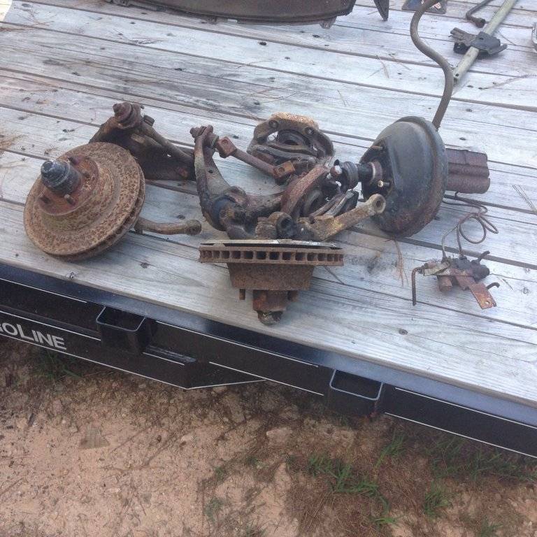

Here's what I have. All this came off a 74 Newport. I was wondering if this whole setup could be adapted to a early car that had the eccentrics on the upper arm. Fab machine a bar to replace the eccentric Cam's

View attachment 94939 Here's what I have. All this came off a 74 Newport. I was wondering if this whole setup could be adapted to a early car that had the eccentrics on the upper arm. Fab machine a bar to replace the eccentric Cam's
The problem with this setup is the lower ball joints, the 74 and up cars have the ball joint in the lower control arm that goes to the sub frame. The lower arm on the spindle here is not able to be changed out to an earlier ball joint/arm unit.
Well that sucks. Guess we'll have to stock up on spares from the yard we know has a couple of these cars.
