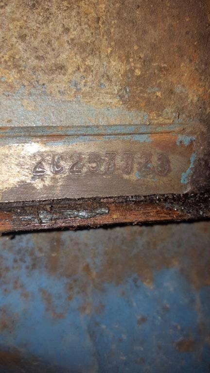

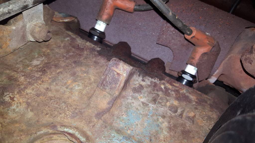

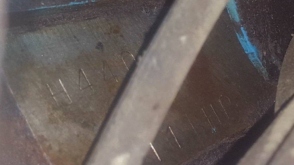

I finally had time to take some pics to confirm the engine. The front pad was not easy to photograph because of the compressor, and I had to remove one of the spark plug wire holders that was partially covering it.
The casting date looks like 3-13-72.
No 400 disguised as a 440 here. Its the real thing.
You would appear to have a numbers matching engine in your cruiser, good find. (Most have had at least one engine change) HP stamp on the boss confirms it is a steel crank engine. Check the harmonic balancer, if it is a round unit, the engine is internally balanced, if the center section is egg shaped, it is an externally balanced engine. The externally balanced engines usually have the heavier rods. HP1 means the engine was produced on the first shift, HP2 was on the second shift, no difference in the engines between first or second shift.

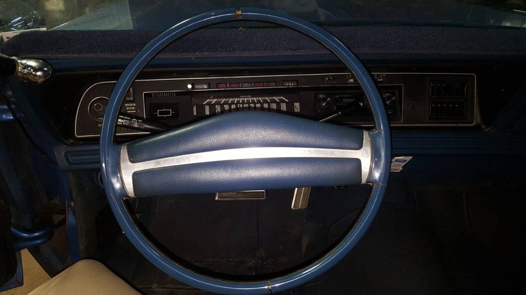

Chryslers had three steering wheels in 72: the 3-spoke one and two different types with two spokes of which the fixed was standard for the then-new New Yorker Brougham.
But it's not the same wheel. So you know automatically if a car has tilt or not by seeing the wheel which was my point. You don't need to see the column to know.
I learned that many years ago after having one of each
