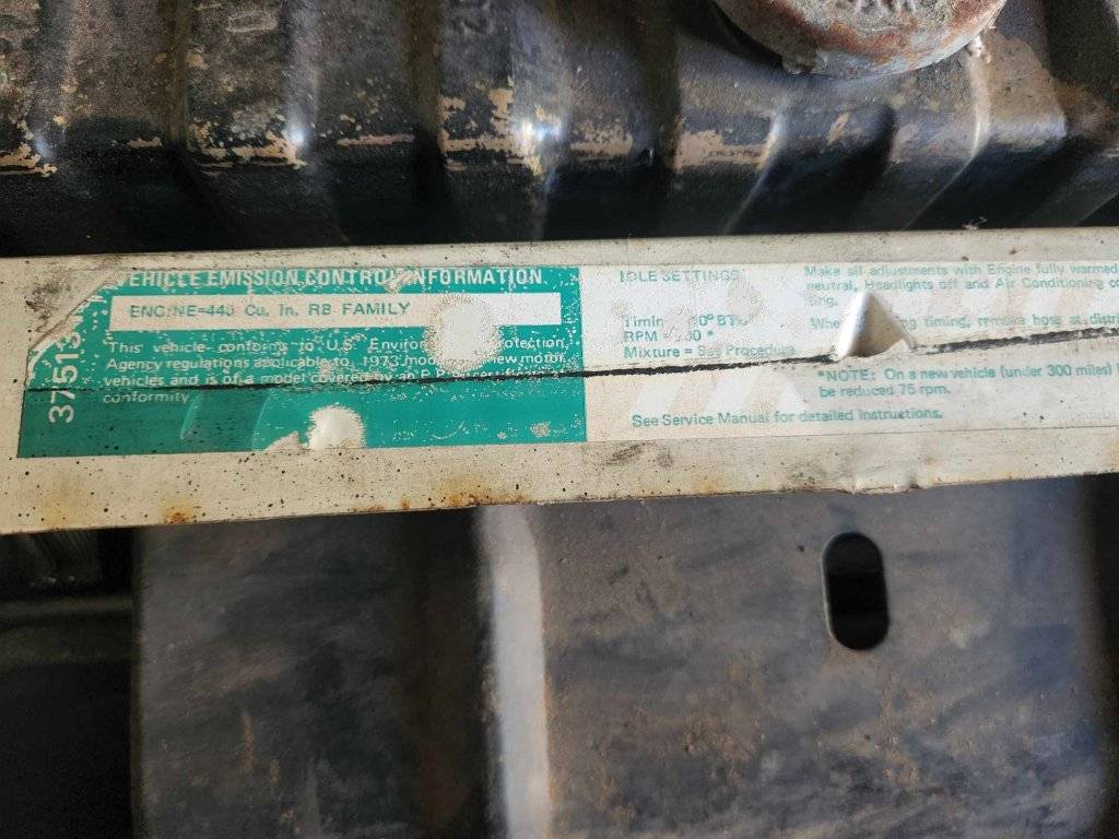

It seems like there ought to be a sticker under the hood like this:
As GregG48203 mentioned, there should be a sticker on the radiator support.
