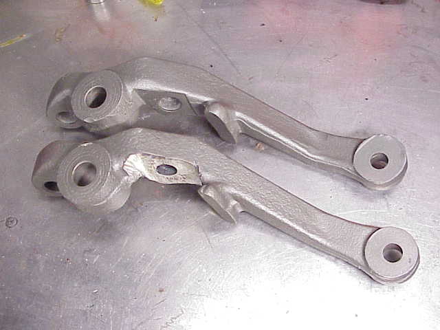

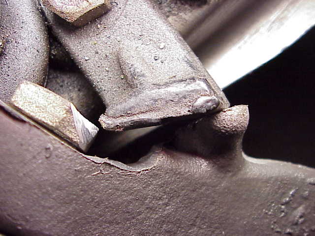

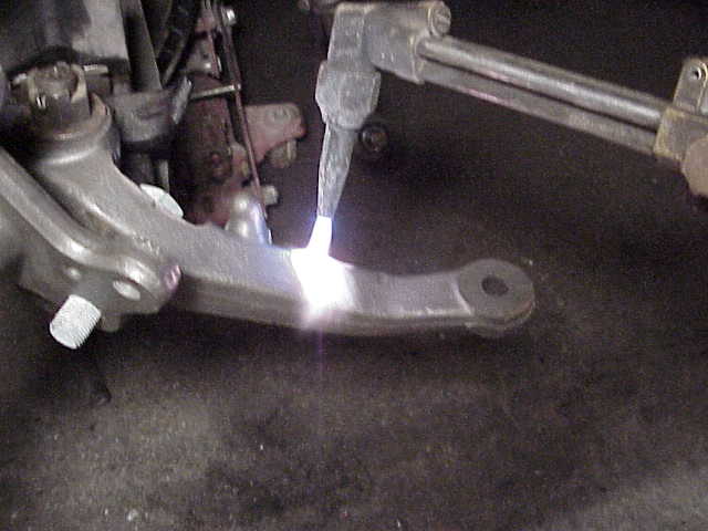

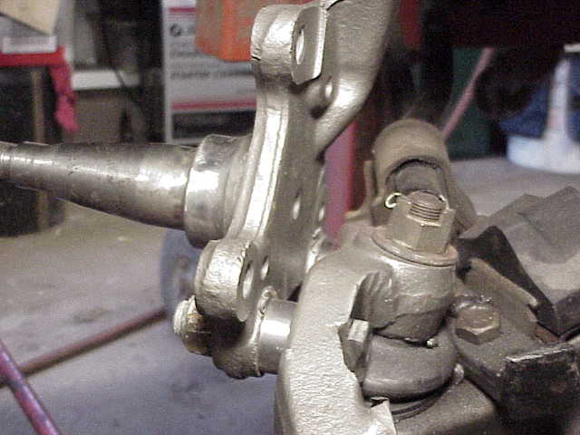

The issue we are concerned with is the grinding and bending done to make this work...
It seems to me... do any of you think a little more work with those spacers and steering stops, most of the grinding could have been avoided??? Maybe different tie rods too???

I still have mine for sale. The ball joint hole is too big to fit the earlier upper arm. I was on one of the hot rod/rat rod boards a week or so ago & a guy was making bushings to adapt some kind of big brake spindle to his project. Which is what I always though could be done. I didn't repost it here cause I figured it start a big fuss.
THANKS Cantflip and C Body Bob. This has been a very touchy subject here for a long time. One of my projects for over the winter will be designing an adapter to fit the 1965 and up drum brake spindles to work with the Chrysler brake adapter and Calipers. I do know the 5300 rotor will fit the drum brake spindle. Scott (Locomob) is holding a set of spindles for me. We older guys have to help the new guys keep from having these lovely cars from getting mangled up. I am totally with you on this. To quote Saylor again, we need to try not to die.

Im not talking about the spindles, if you look at the pics of the part that is ground, it is the lower arm that bolts to the spindle, but you are probably right it is probably a forging too.
I'm not real impressed with that conversion.
I think you might be really screwing with the geometry of the front end using those spindles and spacers. The grinding is very crude, although I've seen steering arms bent like that without problems.
I did a disc conversion on my 53 Windsor and that was a pretty simple bracket wand used Ford rotors. I think that would be the way to go with the car shown.
Now that I am home and have a better chance to look at this I think if any grinding had to be done it should have been on the spacers on the spindles, not the arm.
well guys i would have counter sink that bolt in that steering arm , so the thickness could be kept , but the stop would need some modification , no great issue there and for the heating to cherry red of steering parts for bending to alining is or was okay on the early us built cars , with out issues . hell how do you think a hot forging is done , lol . but hot rodding is not for the meek . i've broke alot of parts in my time . so bob you tried a 75 up spindle on a 61 -64 ? i'd like to do my 64 300k with chrysler stuff , i have all the disc's from a 75 imp , spindle out fronts and rear disc's setups also , even the master and booster n ' p' valve . and i'm not slaming chrysler calipers , but the gm calipers are more compact and lighter and mount easily . to use older aftermarket rims , that 1/4'' off the caliper radius means balance weights can be there on my 15'' old school american torque thrusts with a chrysler 11 3/4'' dia rotors , and the gm larger dia rotor is only an 1/8'' larger on the dia ( 11 7/8'' dia ) .
