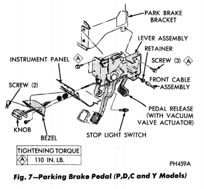

The manual refers to, but doesn't show, a manual release for the parking brake. I can't find it--anybody know? I really want to find this, because I had the vacuum release fail on another car that didn't have a clearly marked release and I was pretty much up a tree.
There is a release pedal and it's way up in there.
