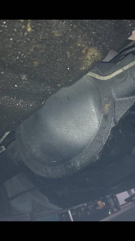

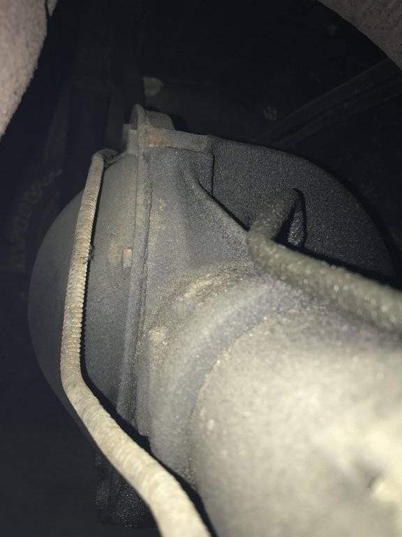

I have searched and looked at photos of the rears and am i correct thinking I have a 8.25 rear in my car with and aftermarket cover? I was expecting a 9-1/4. Most I have seen have the plug on the right. I am thinking a 3.23 rear change from the original 2.71 would make it a little more sprightly.
This is a weekend car being updated on a budget (bushes, suspension,brakes) but kept looking quite stock and a little oommpph when the pedal is pressed would make the kids and I happy.
Any advice is appreciated.

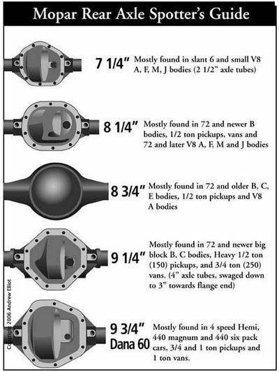

Thanks. I have the same pic, I have just not seen the case without plug in it or smooth not molded as in guide.
