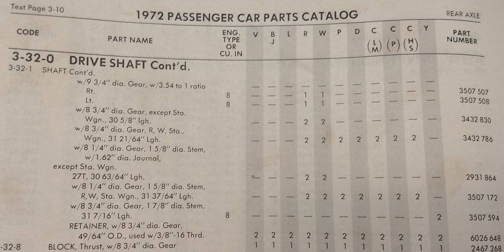

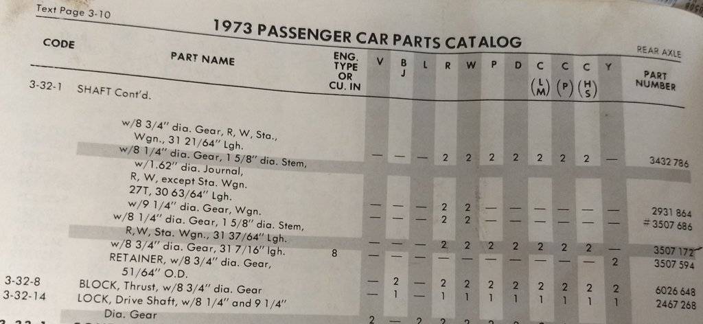

Been doing some research in my parts books. Unless I'm mistaken all axle shafts from a 8-3/4 are interchangeable from 1972-1973 C-body wagon & sedan Plymouth Dodge Chrysler as well as Satellite Coronet wagon. (Part # 3432786) Can't be 100% sure on my findings these parts books are hard to interpret.
View attachment 192126 View attachment 192127
Look at the length of the shaft for all ex wagon=30 5/8", station wagon =31 21/64, lines 2 and 3 first page. They are also a different part number.

"Look at the length of the shaft for all ex wagon=30 5/8"........Look at the top of that page. Your reading column R & W (R=Satellite) (W=Coronet/Charger) So part # 3432830 is for all Satellite-Coronet-Charger except Wagon.
"station wagon =31 21/64, lines 2 and 3 first page. They are also a different part number."........Your reading column R W P D C C C (R=Satellite) (W=Coronet/Charger) (P=C-bodyPlymouth) (D=C-bodyDogde) C=C-bodyChrysler) I interpret this line as Satellite-Coronet Wagon only & All C-bodys 4-door/2-door/wagon. Part # 3432786
These parts books can be very difficult to interpret.

"Look at the length of the shaft for all ex wagon=30 5/8" Look at the top of that page. Your reading column R & W (R=Satellite) (W=Coronet/Charger) So part # 3432830 is for all Satellite-Coronet-Charger except Wagon.
"station wagon =31 21/64, lines 2 and 3 first page. They are also a different part number." Your reading column R W P D C C C (R=Satellite) (W=Coronet/Charger) (P=C-bodyPlymouth) (D=C-bodyDogde) C=C-bodyChrysler) I interpret this line as Satellite-Coronet Wagon only & All C-bodys 4-door/2-door/wagon. Part # 3432786
