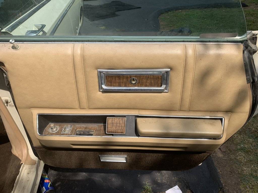

    First, I worked on some of the door interiors. I thought the switches were rusted based upon their appearances. Once I cleaned them I was surprised, check out the pics below.
    Door before cleaning:
    Note how nasty the switches are, I thought they were rusted.
    These photos are after they were cleaned. (Obviously different door due to me getting excited and having to recompose myself).

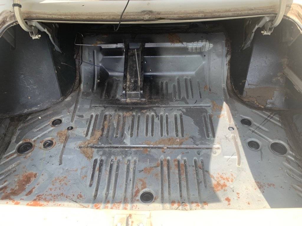

    Here is a picture of the trunk after I removed the carpet and everything else. This really surprised me, again I had to recompose myself!
    No rust issues, just very light surface rust and a few remnants of sound insulation. Whew, was I glad to see that.

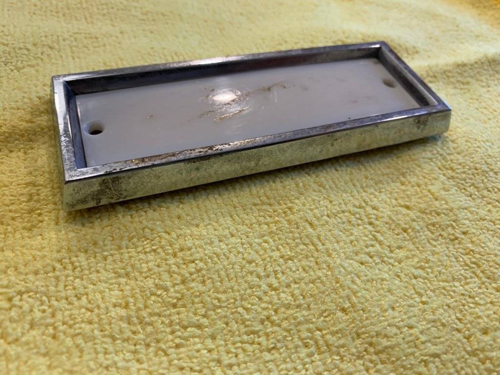

    Here are a couple of before and after pics for the lower door lights.
    Before:
    Ater:

    If you are still with me, I have a question for the people familiar with the Imperials. After cleaning the parts I have so far, did Chrysler use a higher quality of parts for the Imperial?
    The reason I ask is, I have been shocked by how good the parts clean up for a car that is 50 years old and has not been restored???? Plus, the methods I am using are just regular common products and plain elbow grease. As I stated in my earlier post 'Cleaning Products'.
    My first car was a 1968 Plymouth Satellite and it had the rusted out trunk from a leaky window and the parts were not in as good of shape and that was back in the mid 80's.
    I would appreciate any input.

    The paint and rust proofing protocols are the same for the whole line of Mopars. Better attention to detail on the the higher end models, but the same materials. I suspect the interior parts may have been covered by "smokers residue" not rust. In any case, it cleaned up really nice.

    Thanks for the info. That is a good point, I was wondering if it was maybe the body oils from your fingertips. The car has been sitting for I know at least 13 years (last registered in 2006) and I suspect longer than that. All 4 doors look like the pics I posted.

    Check the ashtrays, if they are well used, probably smokers residue. If not probably just dirt. If the headliner is yellowed, sure sign of a smoker.
    Dave

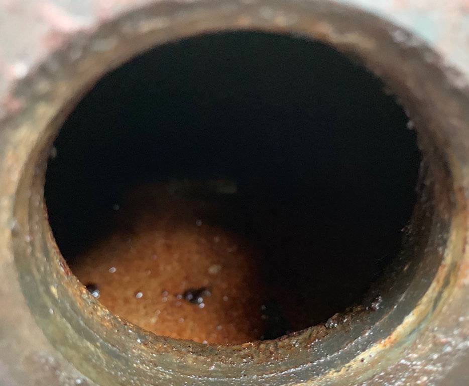

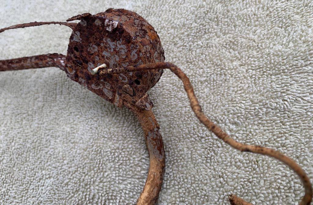

    I finally have another update on my 69 Imperial.

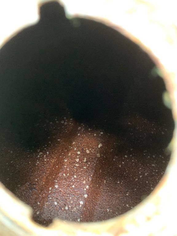

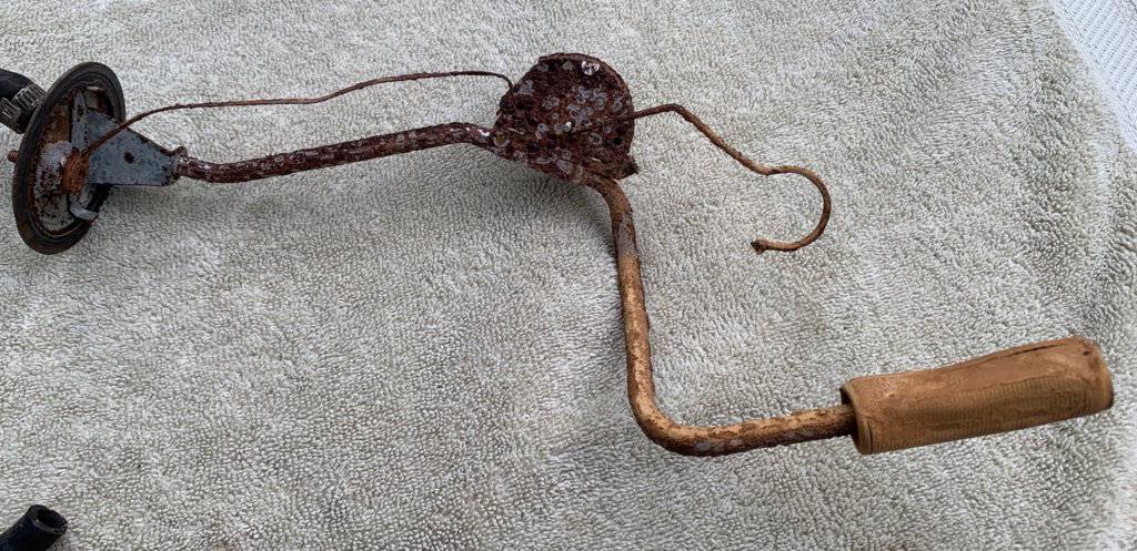

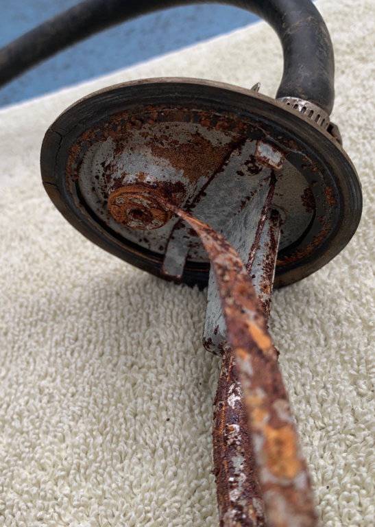

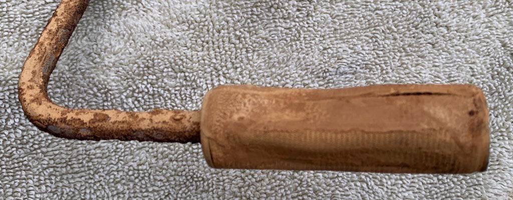

    Today I dropped the gas tank and pulled the fuel sending unit. I have a few pictures below of the sending unit and the tank. After seeing how nasty they were I am glad I dropped them. Again, this car has sat for way too long.
    I was wondering if anyone has used the VansAuto for replacement fuel sending units and gas tanks? I saw a link from a previous article. Thank you in advance for any input. FuelSender1.jpg FuelSender3.jpg
    I had to cut the straps to drop the tank because the bolts had so much undercoating I could not get the bolts loosened enough. I am debating on just getting all new hardware because I am not sure the tank is worth saving, it does have a few dents on the bottom, plus there is some rust on the inside.
  12. Davea Lux
    Davea Lux Old Man with a Hat FCBO Gold Member
    Messages:
    5,234
    Likes Received:
    1362
    Joined:
    Mar 27, 2017
    Location:
    Cornelius Or
    Replace the tank and sending unit. Do the job right the first time and save yourself a lot of grief later. You existing tank will continue to rust pretty much no matter what you coat it with and it will be just a matter of time until it leaks. Be sure to save the lock ring off the old sending unit, the replacement ones are mostly too light and leak.

  13. MacLebaron
    MacLebaron Active Member
    Messages:
    219
    Likes Received:
    87
    Joined:
    Jul 30, 2019
    Location:
    Maryville, Tennessee
    Hi Dave,
    That is what I am thinking. I learned years ago, trying to save a buck can end up costing you more in the long run. Plus, I want to have the car fixed so I can enjoy it.

  15. Fratzog
    Fratzog Old Man with a Hat
    Messages:
    10,349
    Likes Received:
    4986
    Joined:
    Nov 12, 2010
    Location:
    Grimsby, Ontario, Canada
    For what it's worth I had the original tank on my 70 polara cleaned and coated by a rad shop in 2003. Still no issues and going strong today.
