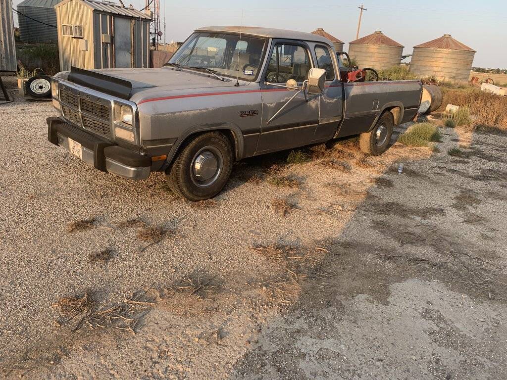

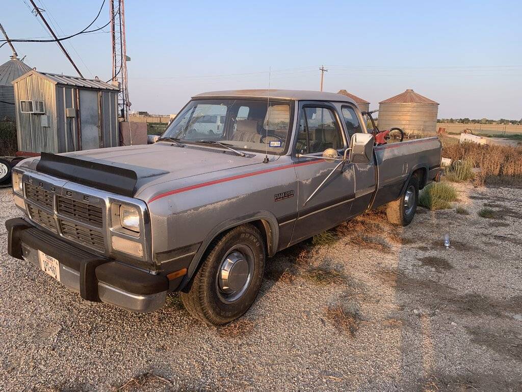

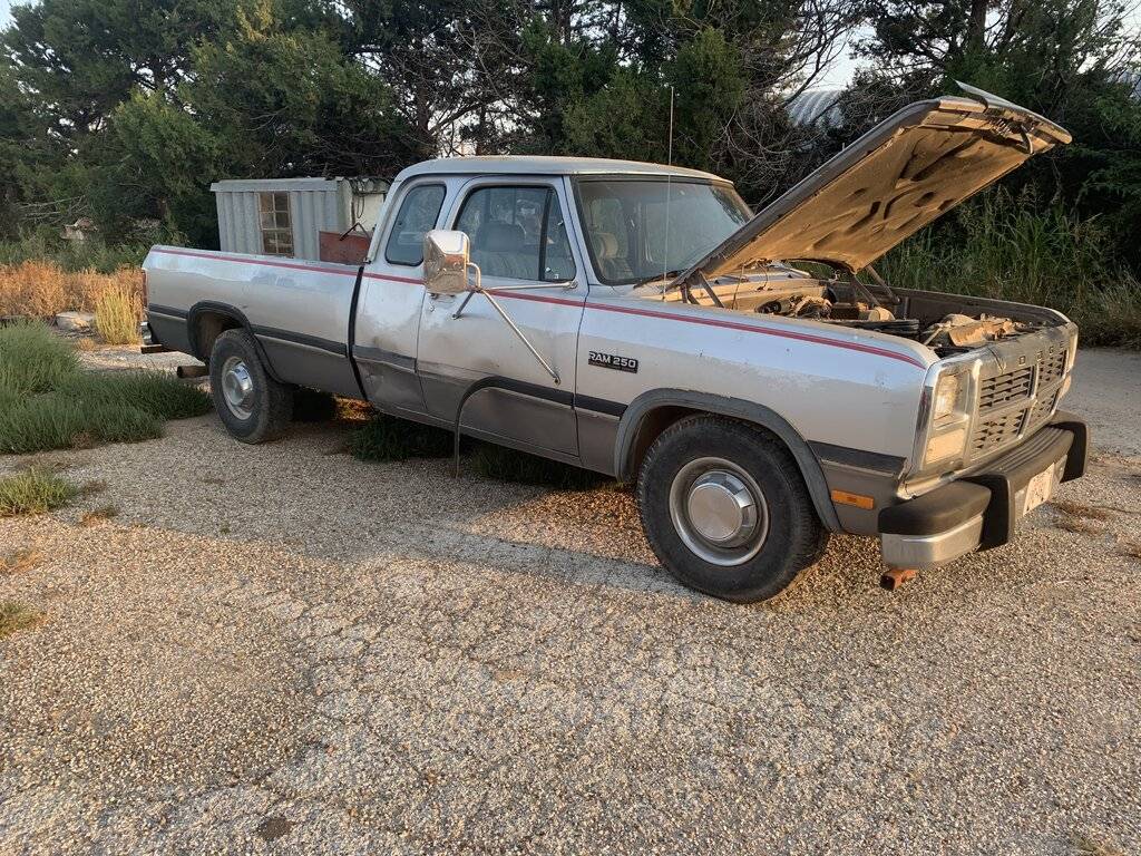

    I’m in the process of purchasing this 92 D-250 automatic 5.9 Cummins. It’s a one owner truck has 225k miles . It has very little to no rust on the body or frame . It will be used to tow my camper and car trailer pulling my demolition derby cars. What’s y’all a opinions and concerns? Any idea on the fuel mileage?? What would y’all suggest to do performance wise to the engine or trans .

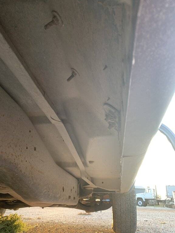

    The Cummins, if it has been taken car of is just broke in, important to keep clean fuel and fresh fuel filters for the injector system. Injector system usually will need to be rebuilt at about 250-300k, engine should run 500k or more without major issues. The fuel cut off solenoids were a POS. The weak point of the truck is the transmission. Check the fluid for discoloration, drive it check for slippage and smooth shifts. Check the frame rails just aft of the cab for cracks. Also important that the coolant has been maintained to factory specs. These trucks were good reliable vehicles overall. You can get a boost in performance by installing a low restriction exhaust system. Injectors can also be tweaked but be careful as too fat a fuel curve greatly reduces engine life. These trucks with the automatic were about 12mpg combined. This one looks like a farmer truck and the field miles can be tough.

    2 wheel drive frames are known to break at the dog leg at the front of the cab if the truck was in rough terrain/worked hard. Front crossmember by the rad support will break at the steering box and the box itself flexes the frame enough that the bolts that hold it on will back out.
    Inspect those areas carefully and have someone turn the steering wheel left to right while you observe the frame where the steering box is bolted.

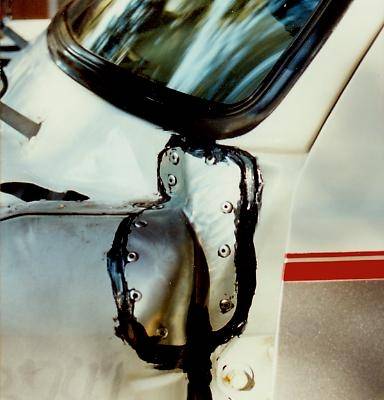

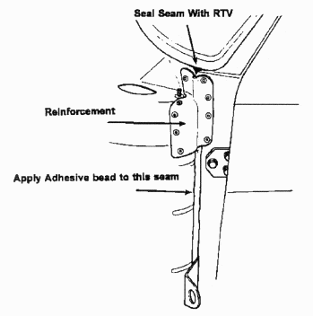

    I forgot about the frame/steering box problem.As stated, the OD section of the 47RH transmission has a snap ring and oiling problem...well know with easy fixes.Another spot is cracking in the cowl area.This was a factory repair...NLA.

    That's only a band aid.
    What is the cause? That is what needs to be addressed.

    Too much torque is the cause... lol
    Followed closely by all the clatter and vibration. Until they went common rail injection, that B series engine was about as smooth as a jack hammer.
