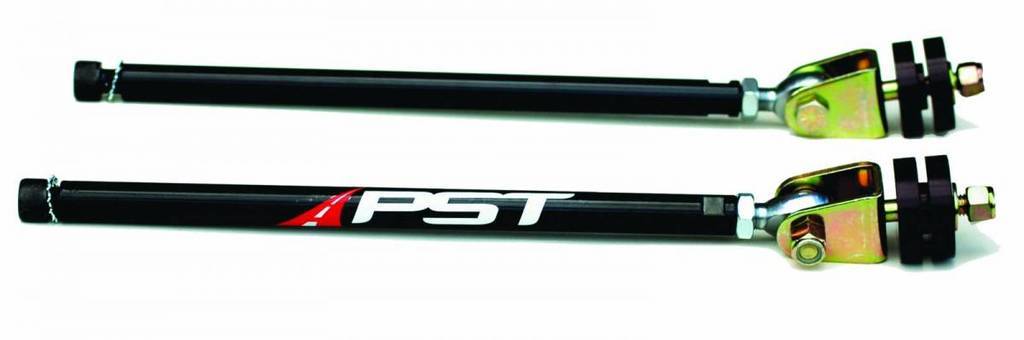

    could you explain, did you weld a bolt in on the LCA side and then put a nut on it or did you just use a bolt altogether that goes through the LCA and in the Rod? I'm curious on how you did that!
  2. 65Fury440
    65Fury440 Senior Member
    Messages:
    2,472
    Likes Received:
    1012
    Joined:
    Apr 21, 2013
    Location:
    West Central FL
    No I used grade 8 5/8"x2" bolts. Same way PST did theirs.

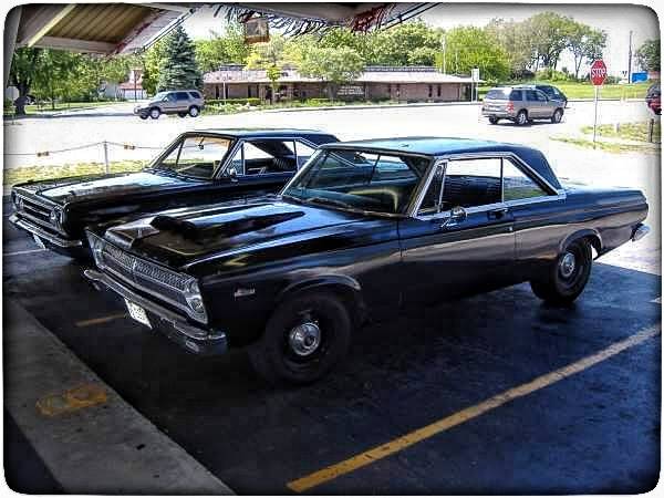

    Sweet B body there!
    I really like my Wilwood brakes so far. I ain't easy on them either.
    Is there a reason you would want to go adjustable strut rods? In my case, the pocket for the front strut bar mounting point was pushed back just a hair, and the car always acted funny driving through dips, like a bump steer. I was being really anal about making sure it was all square, turns out torsion bars fixed that problem.
    I don't think you can beat factory engineering on an important suspension component like a strut bar, I sure wouldn't reinvent the wheel if not needed.

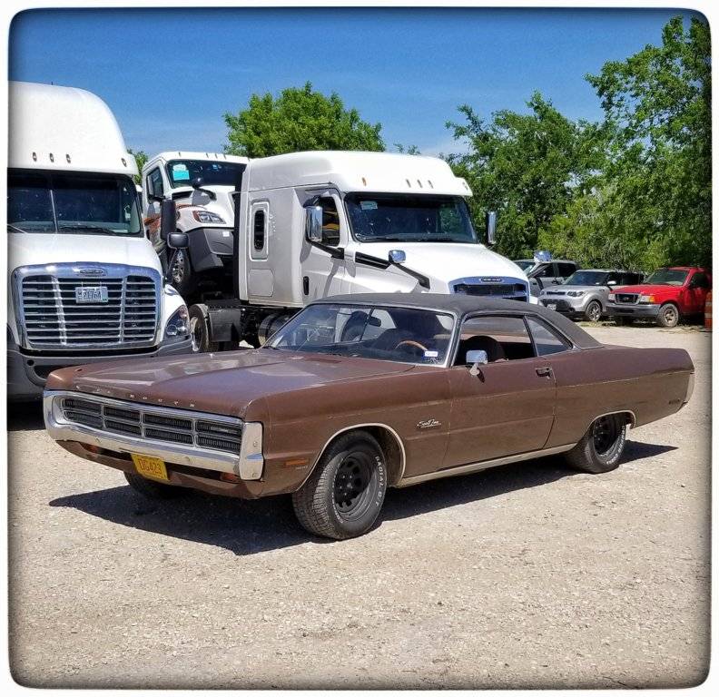

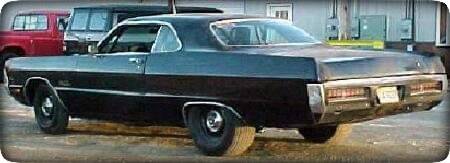

  8. furyusvip
    furyusvip Member
    Messages:
    132
    Likes Received:
    88
    Joined:
    Feb 6, 2011
    Location:
    Outside of Chicago, South Holland, IL
    well, I like to over-think and overkill most projects I take on. The idea of adjustable strut rods (for adding caster for stability) have always been something that I 'liked' and I've got it sketched out in a notebook somewhere from when I did my Black 71 Sport Fury. I'm sorta recreating that car using the remaining pieces (Dana 60, Alston battleship ladder bars and panhard bar, exhaust, transmission...) it's not a 'practical' car at all, but the original sure was fun. The black car, Vicky, is long gone. The Brown car, Coco Chanel, is back in my possession and all of those parts are just sitting in my garage/basement. So, you see...I gotta use them!

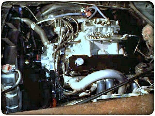

    West Central FL
    Wow you know which direction you are headed, that black Fury looks mean.
    Any idea what headers those are?
    I thought about using the ASRs to pull for a little extra caster, then chickened out at the thought of tweaking the LCA bushings. I guess a guy could pull a little, how much as the $64 dollar question.

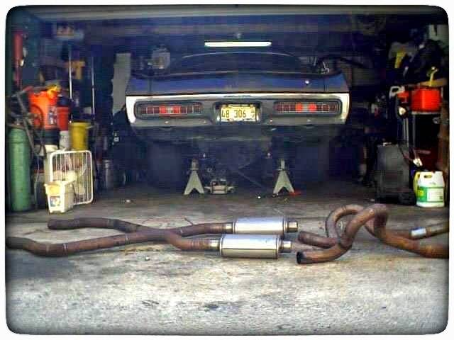

  10. furyusvip
    furyusvip Member
    Messages:
    132
    Likes Received:
    88
    Joined:
    Feb 6, 2011
    Location:
    Thanks! Those are custom headers I had made with 2 1/4 primaries with 3" collectors and full 3" exhaust with an X pipe. It's a slip fit design that I can take off without moving the engine off the engine mounts. The long upper tube slips out to adjust the valve lash or get at spark plugs. They will work on a 440 based engine with Indy raised port or Victor Edelbrock heads. So, I'm planning on building a similar engine, but bigger and kinda milder. Like 510 cubic inch and around 600 hp/600tq should be easy.
