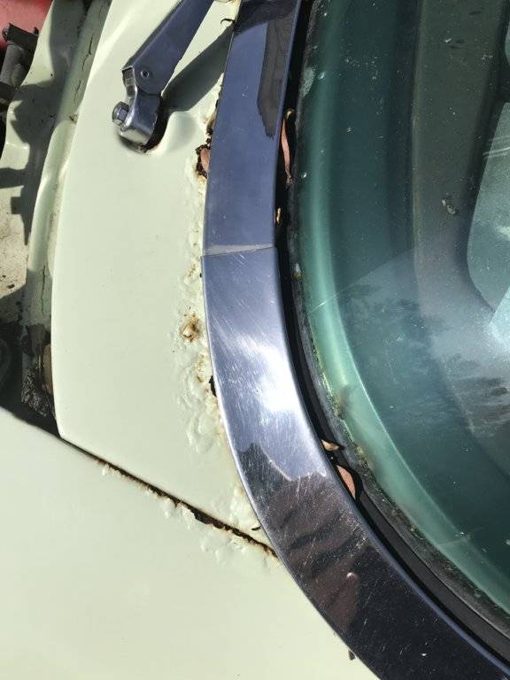

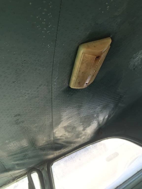

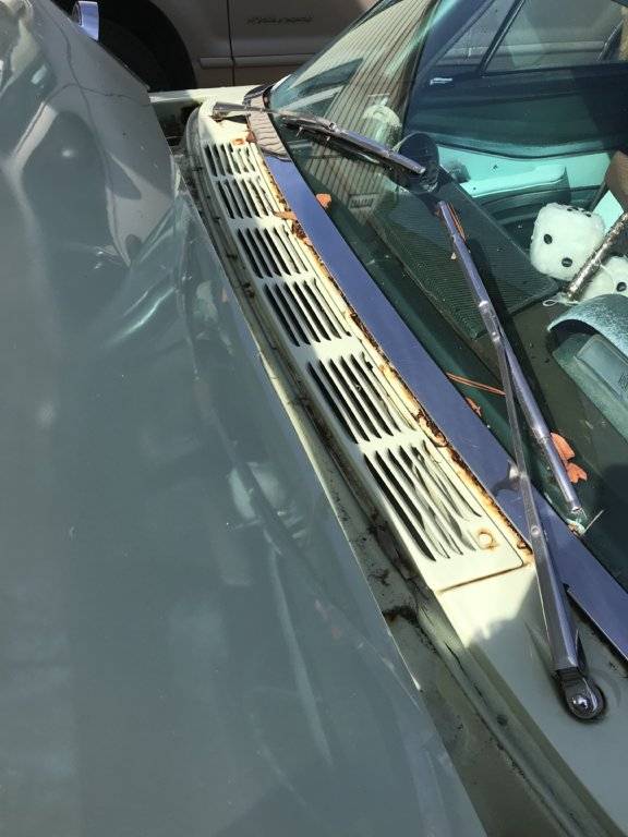

I am a bit nervous about some areas. Heater core bypassed. Rust. Headliner wet from roof rust. Trunk sprung at hinge passenger side. Dude dropped price to $4500.
You're rightfully nervous. Unless (even if) you are an expert metal fabricator, that cowl and roof rust looks serious. Can't help but wonder what other secrets are hidden (floor and trunk pans etc)There are experts here, but from my amature prospective, it looks like a potential money pit. I realize '60 Dodges aren't on every street corner, but you might be better to find a more solid project or if that's what you just have to have, continue looking for another complete solid car. You might be $ ahead. Best of luck!!

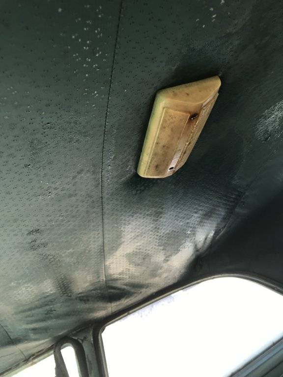

Car hasn’t been driven in 6 years. 50k on rebuilt 361. It snowed yesterday otherwise I wouldn’t have seen the soaked headliner.
Parts car sorry to say. Way to costly to fix that rust, and there will be more bad areas than what you,showed.

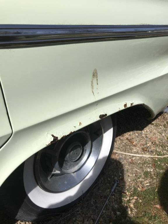

Lots of expensive issues there. The rust you can see is just the tip of the ice berg, especially on a vehicle that has been repainted once already.
It's cool that it is a factory A/C car, but I'd run away as fast as possible.

That roof leak kind of did me in on the car. My body guy says it’s a difficult repair to do and expensive. Like you said, more rust than meets the eye. I hate to see it rot away but I am limited on the money I can throw into one. On the plus side, my Sport Fury is running well and I can drive it.

Rust...for what you don't see add 50% more damage.
Water in the roof but where does the water go? Into the structure of the unibody which is where I would be concerned.
