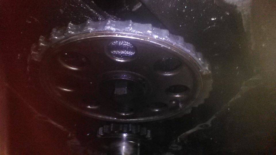

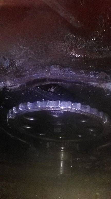

i would s=change the timing set but replace it with a double row timing set . yhe oem ones r what they called a silent cain . if ub dont change it it may jump / throe the timing chain. i tried to cut corners by not replacing the chain when i replaced the water pump @ 99,000 miles but @ 135k it throw the chain & i bet every valve but 3
OK Marty; watching You Tube I thought the worst that could happen with a broken timing chain is that the engine would quit. But you and some other members of the group have put the fear of God into me with your stories. I will change the timing chain. Paul
Yes, the engine certainly will quit, and if running at more than idle, it can quit very CATASTROPHICALLY! Think! The forces required to shove those pistons up and down as they act on 2 tons of load can certainly shear metal, rend flesh, et cetera, if but slightly misdirected. Spending a couple C notes on the parts and carefully DIY comes CHEAP!
