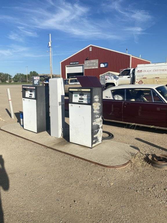

The start of the highway to the end of civilization. This is after my first stalling issue in Glendive, Mt. But got it started and it ran fine for about 190 more miles.
Road construction with gravel and a pilot car. Still running fine until I had to stop and wait for the pilot car. Died just when it was leaving. Got it restarted in time for the next run. Really thinking I got bad fuel.
Filling up with “good gas” after an assist from a New Jersey couple that drove me 32 miles round trip. I did buy a nice $25 gas can from this Oasis.

Started up fine. Ran good for the 100 miles to Lewistown. Filled with gas and just started to Leave the station and it stalled. I put the hood up and was about to fill the carb bowl with my Evian bottle of gas when this old guy (compared to me) and started asking about my problem. His first question was, is it a Ford or Dodge? I was thinking he wouldn’t be much help. But he started asking the right questions from his pickup seat. He ruled out the ignition, water in gas, vapor lock… he says it has to be something with the fuel pump and maybe the check valve were letting all the fuel drain back. At that point I went to O’Reilys down the street which was the only one open on Sunday to see if they had a fuel pump. They did not. I wasn’t even thinking about an electric one or that the fuel pump rod may be the issue. Any way the car seemed to be running good so with limited options I decided to continue on to Glendive where I may be able to find one. What could go wrong in 250 miles through nowhere?
Got about 70 miles in and stopped at a rest area. Left it running and ran in. Came back out, jumped in and started driving. Just got back on the highway and it stalled. Dumped gas in the carburetor bowl started up and drove a quarter mile before it quit again. Dumped more gas in. This time it kept going but with a little bucking for about another 1/4 mile. Then it smoothed out and ran fine at 80 mph. Then I hit this long hill and it started bucking again. I got over it and smoothed out again.
This water bottle with gas became my best friend.
Also a nice holder right by the battery.

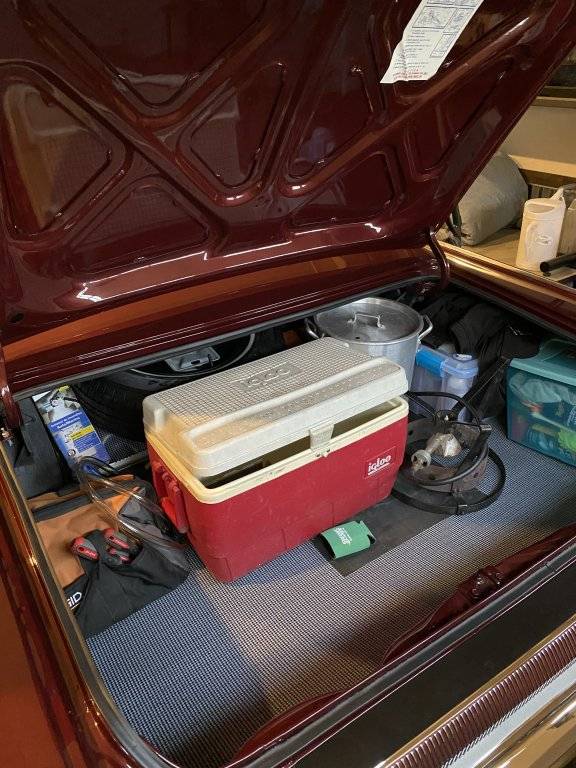

For the 2k mile trip i plan on packing spares:
Alternator
Ignition module
Cap + rotor
Voltage regulator
spark plugs
Complete distributor w/pickup coil
Ballast resistor
Any other thoughts what might come in handy ?

Fuel pump and pushrod :poke:

Duct tape and vice grips. . .

I did get a new hardened rod from Hughs engines. I also have the electric pump and hoses in my tool bag as back up.
Also put some Chrysler lube on my exhaust cross over. I usually do that once per year when I change my oil. I am not sure if I did it last year with every thing going on. It was a little sticky at idle but still at 3/4 open. (would open all the way with a little throttle) Now when hot it should be free enough to be open a little more.
I am not afraid to go again. I should now have most contingencies covered.
