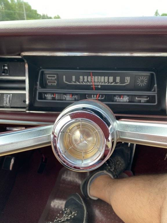

Look! No fuel or temp gauge.

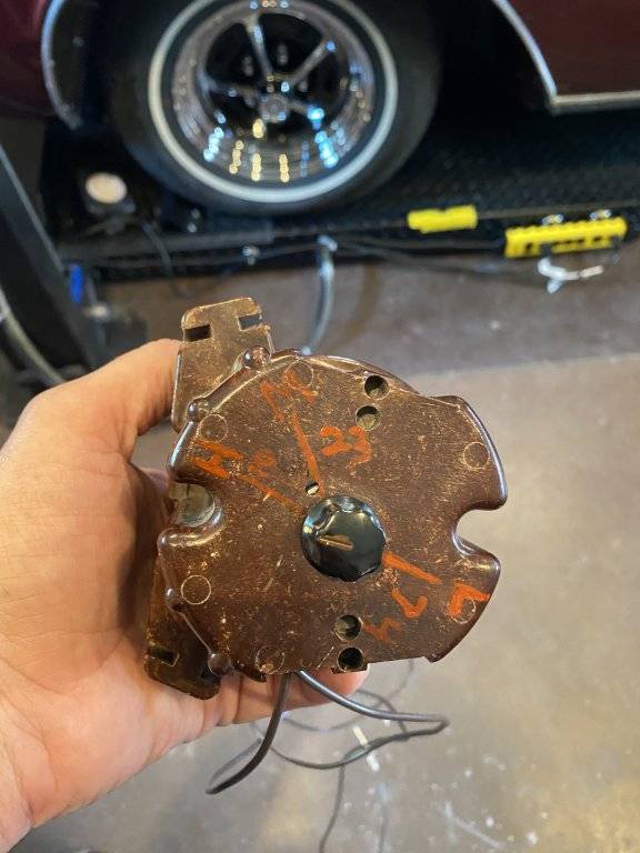

Back to Friday afternoon. As many people (except the ones camping out) left for the evening I pulled my car in the shop to rebuild my solenoid and change my dash voltage regulator. I ordered online had one of mom’s cousins pick it up for me. The solenoid I had ordered off e-bay arrived Wednesday afternoon before I left so had thrown it in my tool bag.
No lift here. Just Jack stand’s and cardboard to lay on.

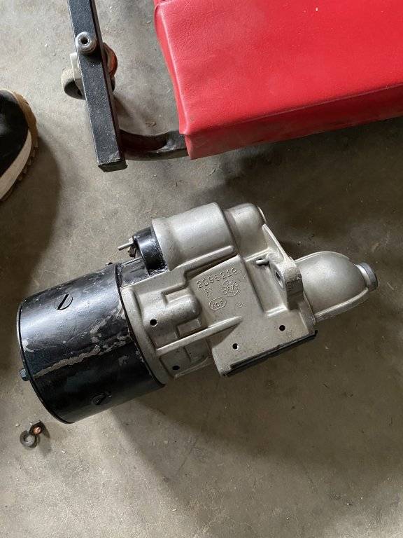

Pulled my starter out and got it set up on the bench with plans to get up early and tear it apart to install the solenoid.
Did this right next to a ‘58? international.

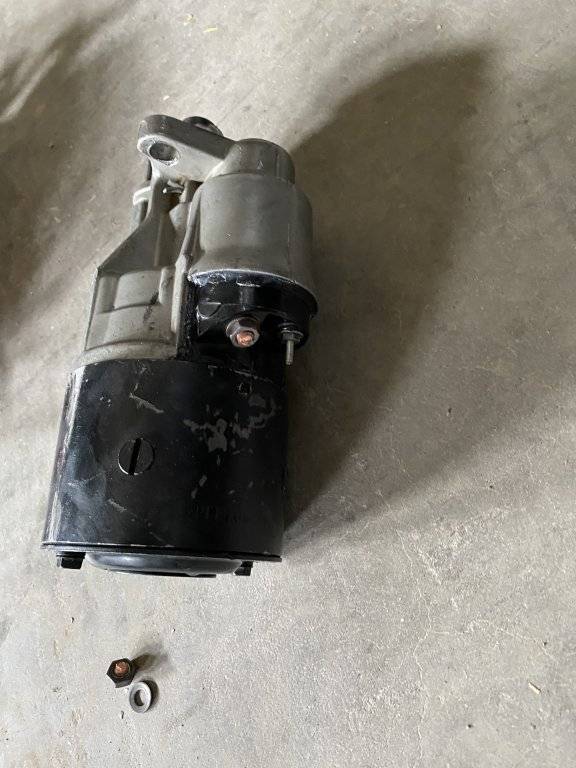

Saturday morning hit the shop around 6 Am. Pulled the starter apart and installed the solenoid. Went to test the starter and as soon as I gave it power it started turning. It seems my new solenoid was stuck engaged. Pulled it apart again. Found that the new solenoid’s spring keeper was nicked up and not letting the plunger move. Pulled the smooth keeper off my old plunger and got some movement.
Put it back together and tested. Everything worked perfectly.
Got the starter bolted in place and installed the wires. Just finished up and decided to make sure my power stud was tight….. I twisted off the F’ing stud. I did have an audience of my two uncles when the cussing started.

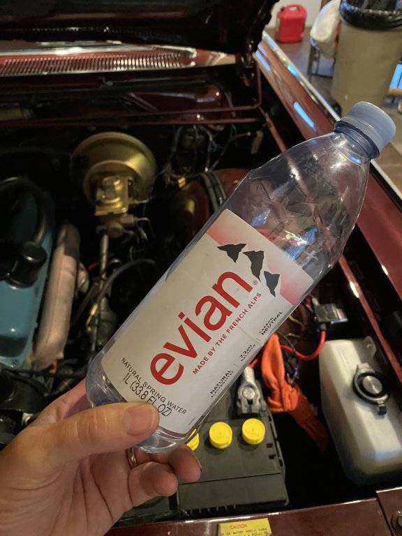

Started up fine. Ran good for the 100 miles to Lewistown. Filled with gas and just started to Leave the station and it stalled. I put the hood up and was about to fill the carb bowl with my Evian bottle of gas when this old guy (compared to me) and started asking about my problem. His first question was, is it a Ford or Dodge? I was thinking he wouldn’t be much help. But he started asking the right questions from his pickup seat. He ruled out the ignition, water in gas, vapor lock… he says it has to be something with the fuel pump and maybe the check valve were letting all the fuel drain back. At that point I went to O’Reilys down the street which was the only one open on Sunday to see if they had a fuel pump. They did not. I wasn’t even thinking about an electric one or that the fuel pump rod may be the issue. Any way the car seemed to be running good so with limited options I decided to continue on to Glendive where I may be able to find one. What could go wrong in 250 miles through nowhere?
Got about 70 miles in and stopped at a rest area. Left it running and ran in. Came back out, jumped in and started driving. Just got back on the highway and it stalled. Dumped gas in the carburetor bowl started up and drove a quarter mile before it quit again. Dumped more gas in. This time it kept going but with a little bucking for about another 1/4 mile. Then it smoothed out and ran fine at 80 mph. Then I hit this long hill and it started bucking again. I got over it and smoothed out again.
This water bottle with gas became my best friend.
Also a nice holder right by the battery.

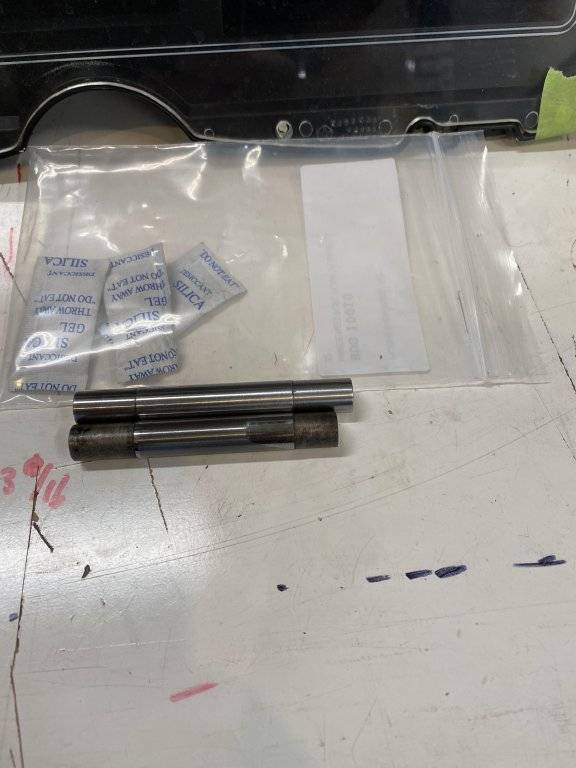

My “bad gas” and “vapor locking” turned out to be my fuel pump. Spoiler alert… it was my fuel pump rod, but didn’t know it at the time.

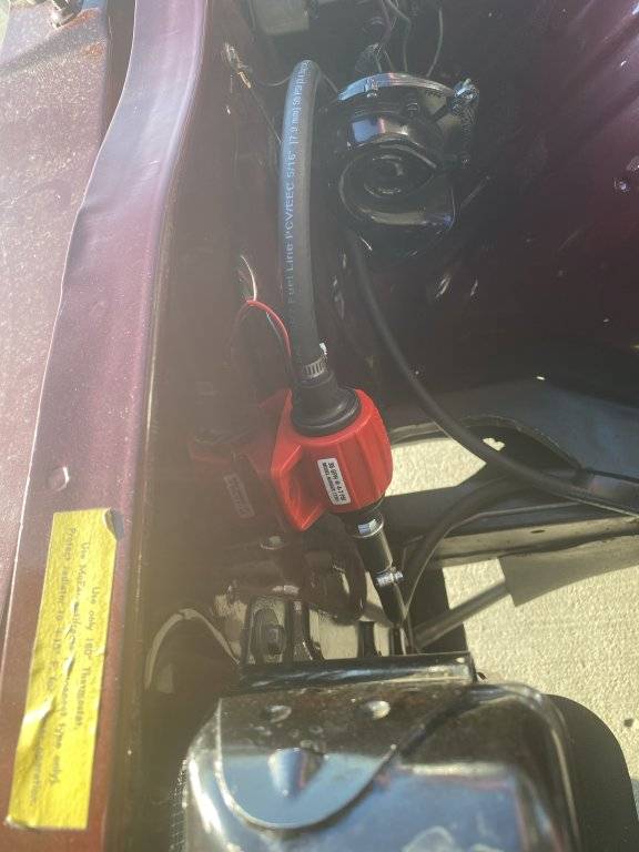

They came back with a nice little Eldebrock pump with the right flow and pressure, about 6ft of hose and clamps. I love working with people that know what they are doing.
Took about 10 minutes to install and started right up.
We mounted it to the radiator support. Used the horn ground for the pump and clamped on of my jumper wires to the power wire taped it together and shoved the alligator clamp onto my relay so it wouldn’t fall off. I would have to bun hook it each time I stopped for gas but I was ok with that.

After filling with gas and about 200 yards on the road it stalled on me. With the electric pump it quickly restarted before I came to a stop.
Vapor lock in the fuel line somewhere after heat soaking when filling?

It sucks not having a temperature of fuel gauge when having issues.

Fuel pump and rod. Rod is about 1/4” shorter than it should be.

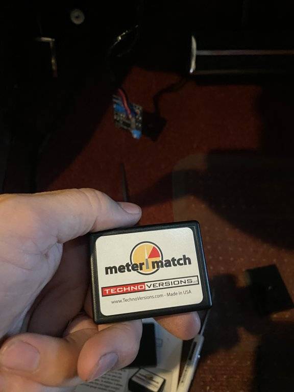

Replace my Instrument panel voltage regulator. A 6 volt Ford one (that looked exactly like my 5 volt Solid-state) does not interact well with my gauges.
Replace my meter match and re Calibrate.

Don't get rid of your electric pump yet, I went through two push rods, one the original, second was a comp. I think the comp is likely reason but my thoughts are it is like wiping a cam lobe and lifter. You can't just install a new lifter. I now run a Carter full time in the Coronet.

I did get a new hardened rod from Hughs engines. I also have the electric pump and hoses in my tool bag as back up.

if you have an Ohm meter then you have a gas gauge when the limiter quits. Tap in at the kick panel.
Yep 10 ohms full, 23 ohms 1/2 full and 74 ohms empty. If the sending unit is 100% calibrated.
Although grabbing the ohmmeter out of the trunk and crawling under the dash wasn’t first on my list when I was still halfway on the road.
