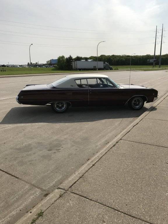

Pic from a quick rest stop. Sorry no time for scenic pictures. Am trying to get home before all the bugs come out at dusk. The last 40 miles is all small lakes and slews.

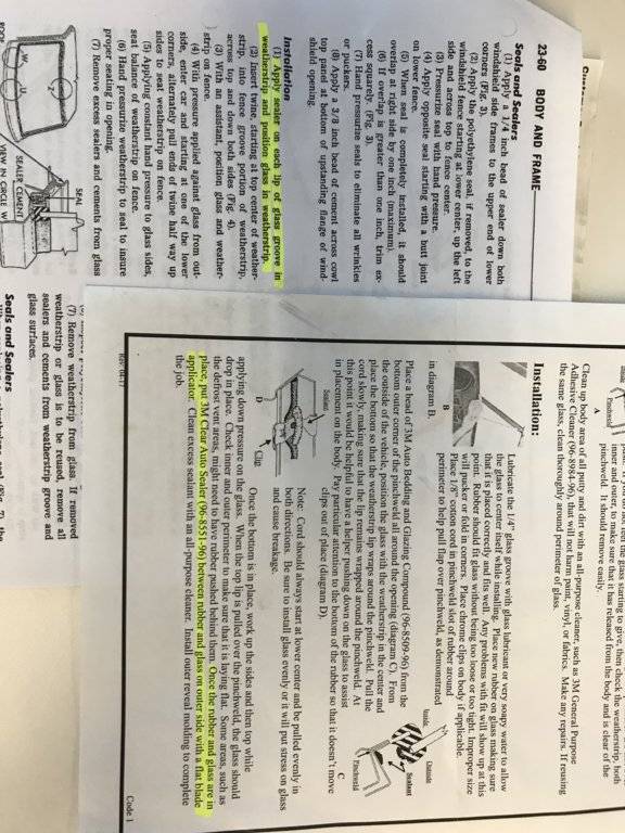

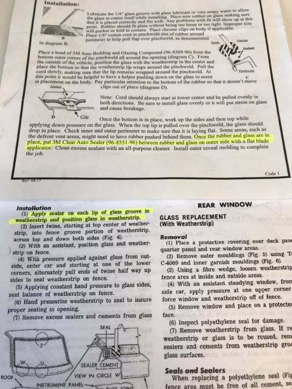

I washed the bugs off tonight and found my leaks. Lower bottom corner of rear window. Has a tiny leak, but it is getting on the corner of my package tray. Not good. Also found that the front window is leaking from the glass groove in the bottom. The instructions said to put a little sealer in the groove, and run a bead on the glass and seal. I asked the installer when he did it and he said he never does it on truck windshields that use seals. I think his comment also was that I probably won’t drive it in the rain anyway? WTF! Am I supposed to stop under a bridge anytime it starts raining when driving?

When the directions on the window seal and from the service manual tell you to seal the front side of the glass to the seal, maybe there’s a reason.
I don’t think I can blame after market glass for leaks just yet when they don’t follow directions. Hey but what do I know I am not a glass installer and the people writing the instructions ( 50 years ago and today) must be morons and don’t know what they are talking about.

Repost of highlighted instructions right side up. Both FSM and aftermarket say to use sealer on the glass.
FSM says apply it to the glass channel. Aftermarket says to the glass face and groove.
