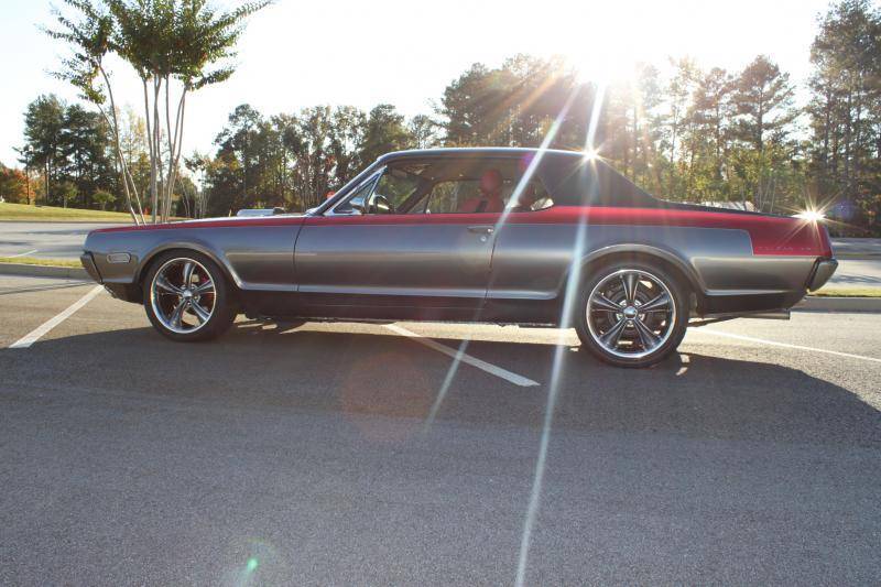

So I ended up with the super trendy Ridler 695s. Not at all my first choice but I already had tires sitting in my garage. I do have two of the Daytonas, so if I ever come across another pair, I'll certainly switch to those. These are 18x8 with 0 offset. They fit really well, too. The tires are fat 275/40/18 Dunlops (I was planning on 18x9" wheels), but they fit up in the wheel well with no problem at all.
I'm not big on the muscle car wheels under the long family sedan, and the fact that they are pretty much the same wheels that I had on my Cougar. Maybe if I drop the front a little more to hide the top of the tire they'll look more on purpose.
Hey what clearances do you have with those suckers? have a line on some of those ridlers @ 18x 9.5 wide with 1/4" offset at a really good price
Hows the clearance on the front suspension components?

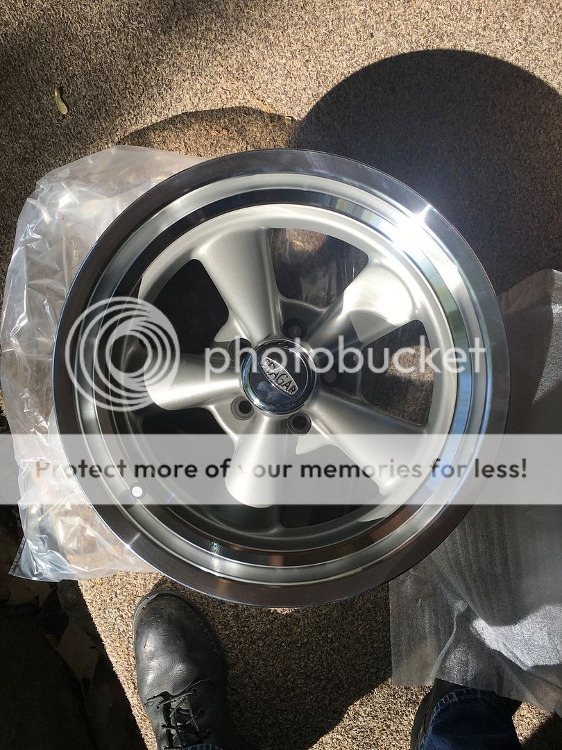

I have to agree on this one. For some reason the C-bodies just seem to look beautiful with the Magnum 500's. I got mine from Summit Racing (probably via Wheel Vintiques) and put them with some 215 70R15 tires. It still has enough sidewall for a comfortable ride.
View attachment 65476View attachment 65477
I got a set of those from Summit as well. Mine starting rusting in 3 months.
Have you seen any rust on yours?
Mine were installed in the fall 2012 put 100 miles on the car, by the time I got the car out in the spring there was rust on the wheels. They are now 3 years old, really didn't get much worse than that first year. I would still buy them again, just wish they put a real chrome finish on them.

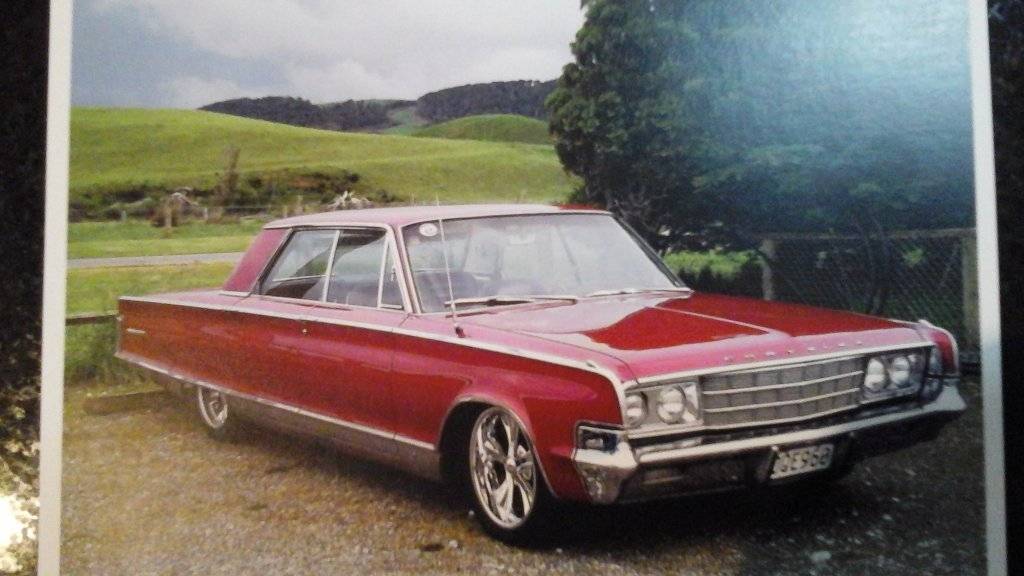

I'm looking to replace the rusty Cragar wires on this 66 New Yorker with something a bit more modern-sized and styled. I like the Mustang eleanor-style wheels, in probably an 18. Are 9 inch wheels possible in the back with the skirts? Anyone done anything like this? Pics of your experiences are greatly appreciated!
Yes, I like the factory hubcaps, but I'm only 35...
I put 2004 mustang wheels to start off in the beginning and no issue. but I have disc on all 4 corners. 16x8oem.
With boxed in leafs 17x10 in rear 6.25 bs. Fronts 17 x9
This post is worthless without pics....
Here is mine. Boyd coddington 18x8s
