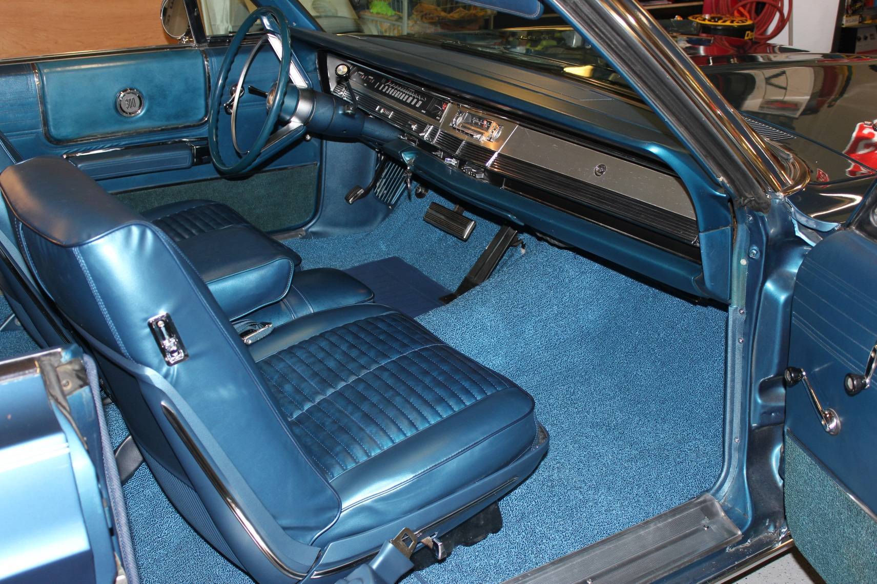

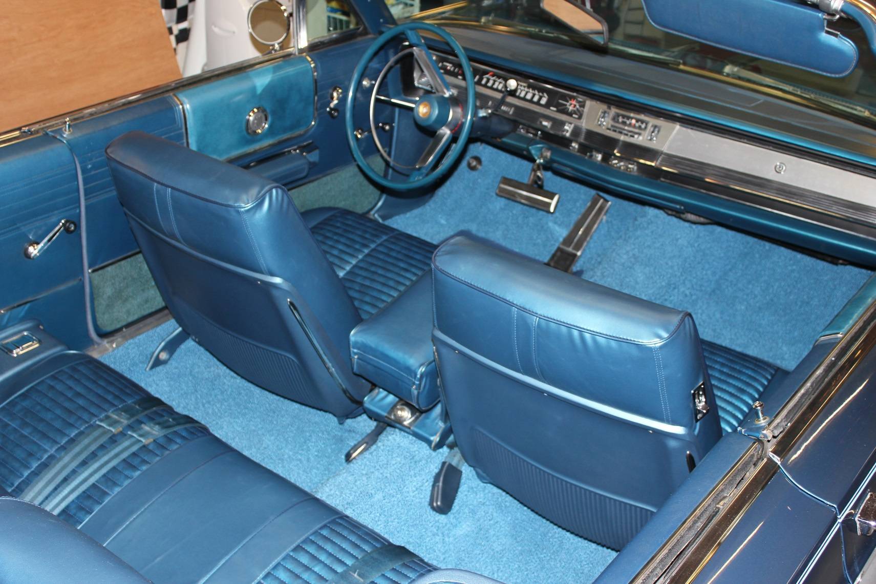

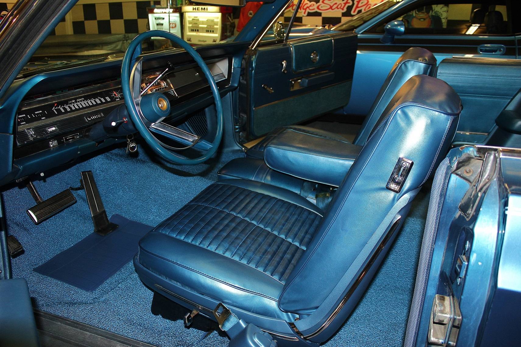

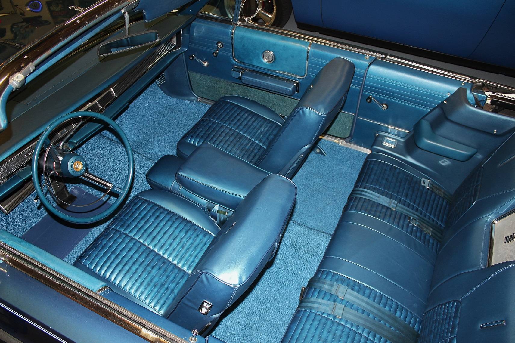

Soooo = I got busy in the garage on 12/26 !
I started by removing the bucket and rear seats, center arm rest/buddy seat, all seat belt assemblies rear side panels, front kick panels, finally sill plates and carpet.
I had to strip the old, incorrect color paint and clean up all the plastic panels that came out of the car , and then along with the new plastic - I painted everything with the vinyl paint = it is amazing stuff!!
Next step was to lay in the new carpet, and find and cut all the holes necessary for seats , belts etc
Then with much appreciated help from my wife = we tackled the re-upholstery of the bucket seats, and rear bench seat ! Well I finished the re-installation of all the components today ...so here are a few pics of the results !!!
Next on my to do list is re-carpet the bottom of the door panels = so it matches the new carpet, and I have purchased the correct New Old Stock vinyl material to redo the faded upper panel cushion with the 300 badges in them.. I will post pics when I get those items complete
