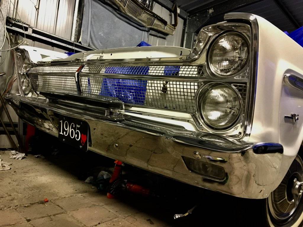

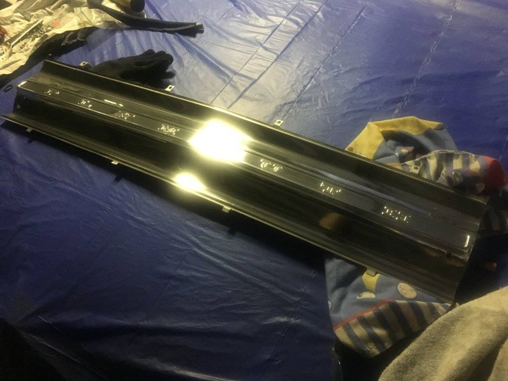

    I’ve just recently stripped and repaired all the trim on my 65. A lot of it was knocked around but it all came out perfect with time. I’ve been doing stainless repairs and polishing for many years Which helps. I haven’t clear coated it yet as I’m still undecided whether I might still get it reanodized. Just take your time. One thing I have learnt from years of casting and polishing aluminium is that the tighter the grain when you finish polishing the longer it will take to oxidise. Try to finish it with 1500 wet and dry before even touching it with a buff. The end results are worth it
