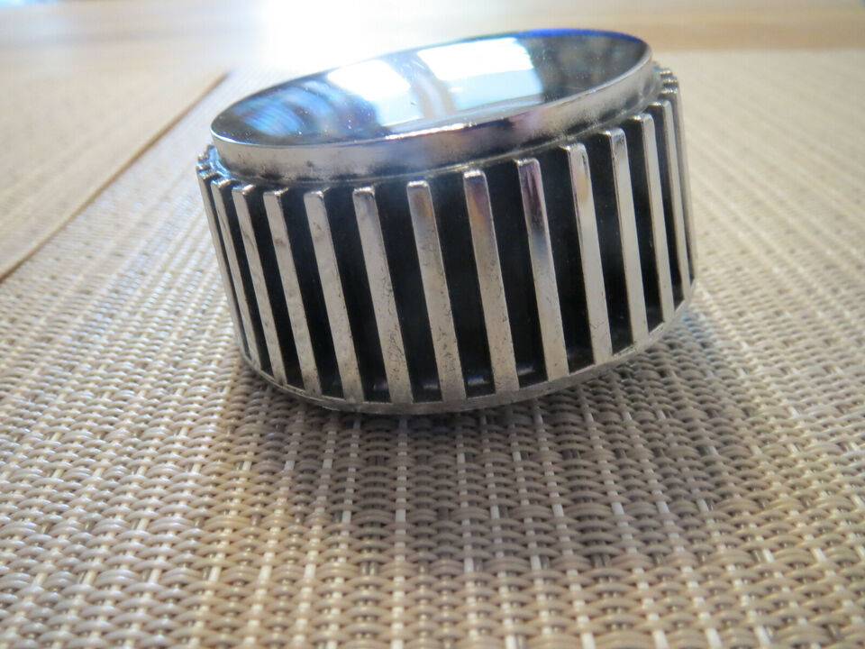

    Cheaper would be to cast the bottom part in aluminum and then machine to finish. Much less machine time and material cost. The 3D printer could make the patterns for the sand casting.

    Plating, yes... Machining from billet? No. That's an expensive way to manufacture. 3D printing is a slow process too.
    Even though the end is smaller on the repop AMC, I wonder if doing a cap over the mock axle stub would be good alternative. Increase the size to change the proportion of the end. It wouldn't be "correct", but it could be a reasonable looking part that only the really knowledgeable would know the difference.
    So many of the repop stuff is not the same as the OEM pieces. Some are... But a lot aren't, so this might be excepted.
    Full disclaimer.... I have 7" Road wheels (incorrect) and aftermarket trim rings (also incorrect) on my car. I'd probably score a set of AMC repops, peel the AMC applique off and paint that part black if I needed them.

    So...
    A cheap rough casting from aluminum, CNC finished, then triple chrome plate. I could see India turning out the castings for cheap...
    Shouldn't be more than 400 Rupees...

    Aluminum casting is pretty cheap to do. Simple sand casting and aluminum melts at a low enough temperature that it can be a backyard operation for casting.
    Getting the splines right might be tough and I think that could easily be a plated plastic part. Doing the bottom in aluminum rather than the cheap "pot metal" the orginals were made in might be a step up, but the inside surface wouldn't be as nice.
    I'm still thinking that a plated cast plastic piece is the way to get a cosmetically correct part. Very simple silicone mold like what @Zymurgy uses for tail lights. Yea, I know, it's not the same etc... and for the guy that's willing to spend the NOS money, it's not the answer. But for the guy that just wants some decent looking centers without breaking the bank, it might be a good alternative.

    If you are going to tool up to die cast these for a reasonable cost, you would use ABS or similar plastic and electroplate them in copper and then chrome. The tooling is probably similar cost but the unit production price drops to pennies. Plastic resin and the process to make it injectable is much cheaper than aluminum.
    If that AMC unit is 2 peice, I'd do a cap that looks like a road wheel that fits and call it a day.

    The AMC cap is one piece as has been stated a couple times now and its dimensions are so far off from that of a road wheel, you can spot it from 20 feet away that it is not the correct cap compared to the original Chrysler one.

    I don't know... It's 5/16" smaller at the diameter and if you made the "spline" cap proportional, you'd have to be pretty sharp to catch it from 20 feet.
    As long as you had the same caps on the same side, it might not be noticeable unless you were looking for it.

    Thank you for posting this. Can you please give the diameter of the base on these?There is a guy on the HAMB that is reproducing the Astro/Howard style chrome slot wheels and that I'm going to use on my kustom forward look 26 Dodge roadster and was thinking about using that style of center cap.
