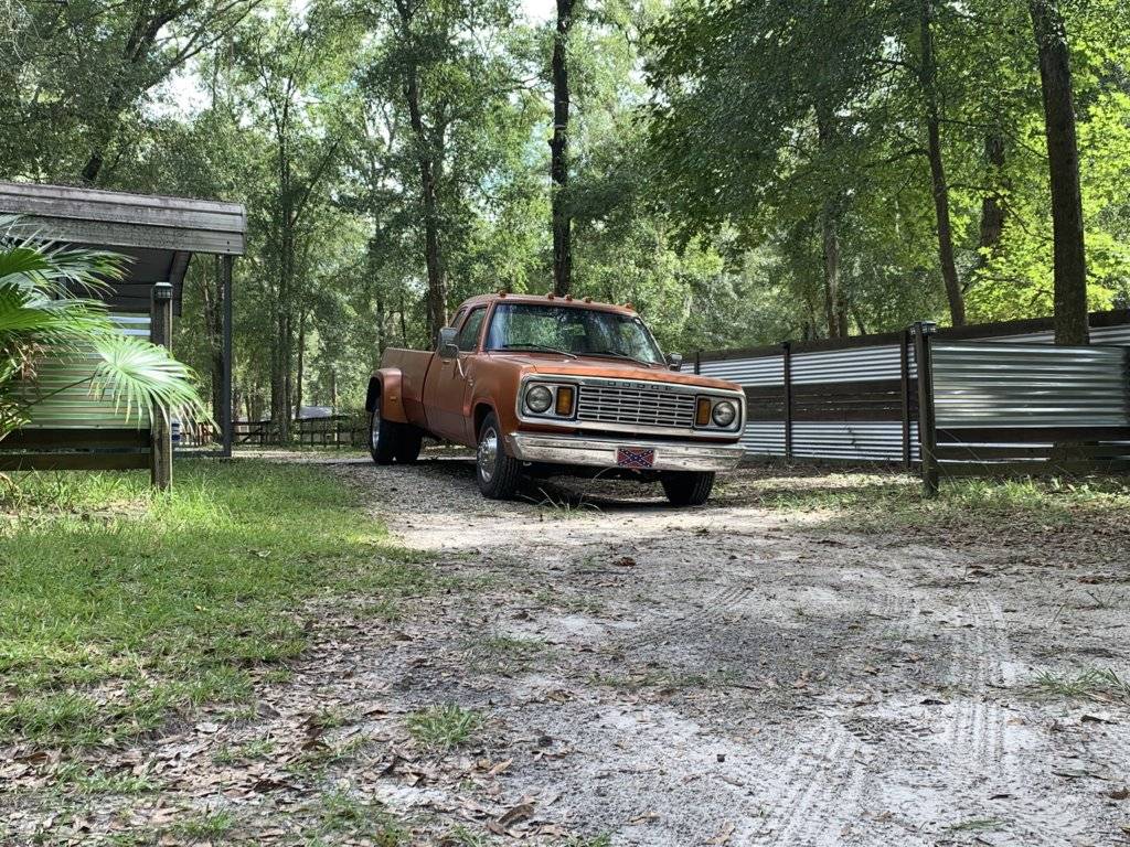

Another orphan found our driveway...

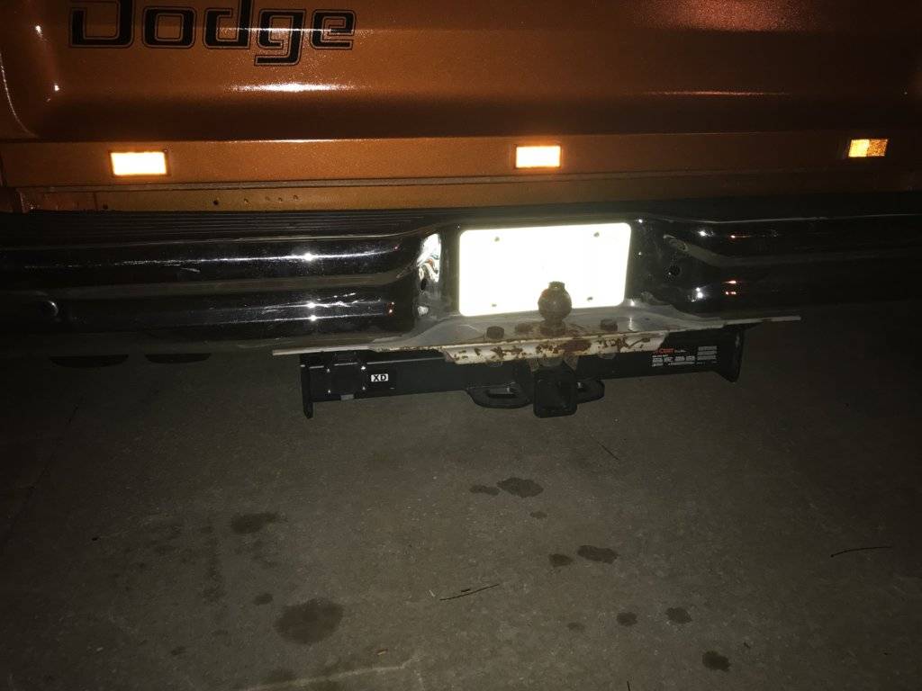

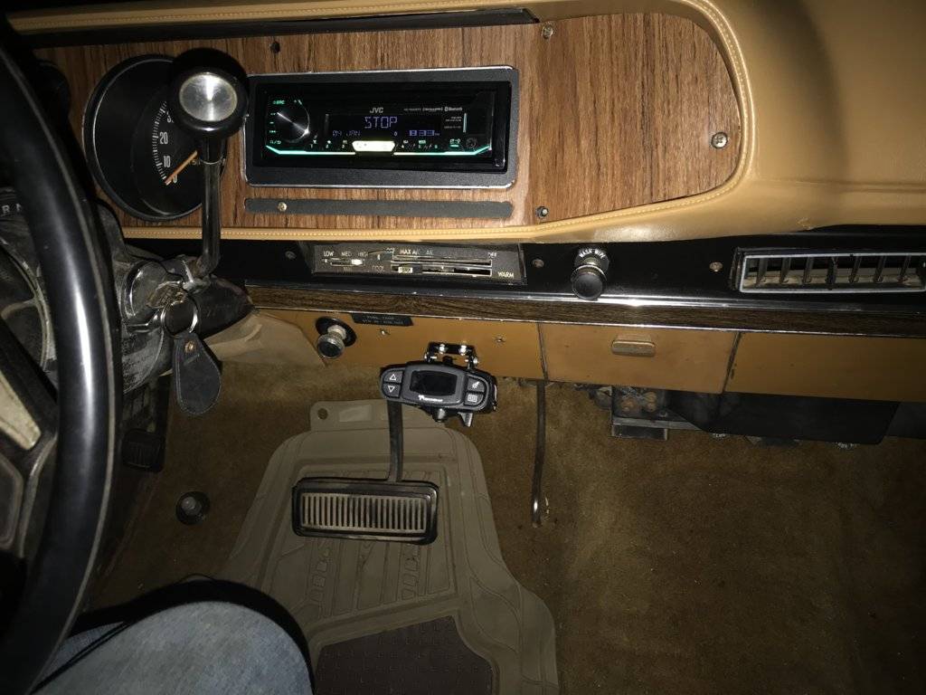

Believe the old tugboat is ready for work. 7 way plug installed, and working. Trailer brake control is installed and working as well. Just in time too. Got one more week till moving.

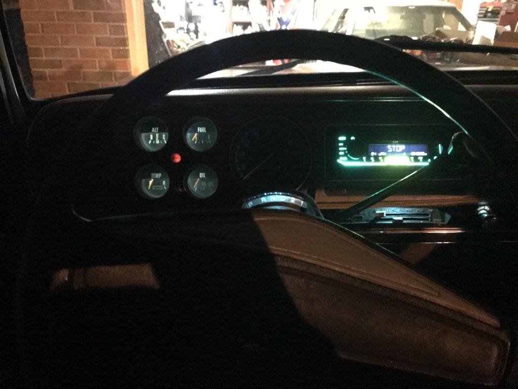

Also got the new radio to match the instrument lighting the best I can. Not too shabby. Need to get some bew light sockets for the cluster still...
Here's what I used. It's a 4 wire hookup. Power, ground,Input from brake light switch, power out to brakes.
Trailer Brake Control - Proportional
I did end up going with the p3. Seems nice. One thing I didn’t anticipate, was there is no power button. Says it goes to sleep after 15mins of no use. Im a little uncomfortable leaving it that way though, so will keep it unplugged for now. Want to re wire the power wire into and ignition on wire vs. just straight power as the instructions indicated.
Do you have any problems with yours, and power? Does it go to sleep? Or did you plug yours into an ignition on wire?
On both vehicles it was installed, I had a harness to the go to the existing wiring, so I assume switched. But when not in use, I'm sure the display was dark.

Still on the hunt for some tag lights for the rear bumper. They’ve proven to be a pain to find. Need the housings and all if anyone has a set sitting around for a step bumper?

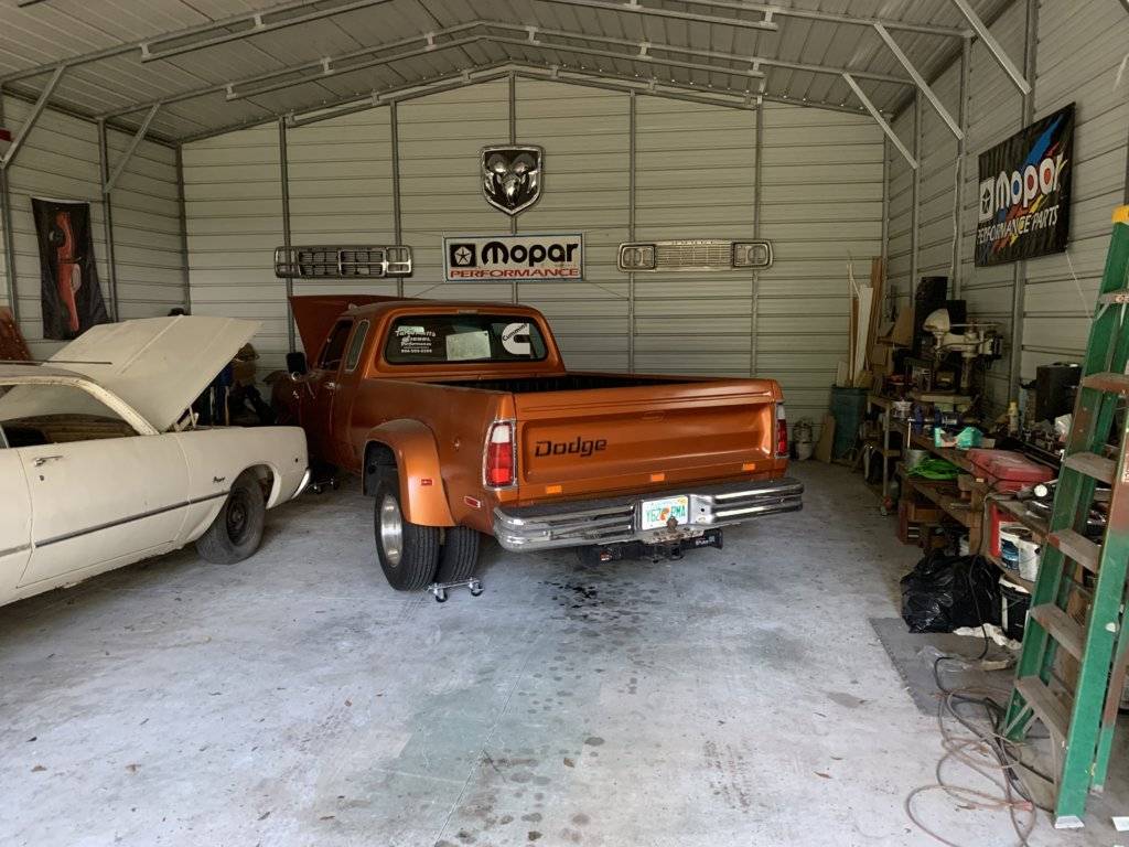

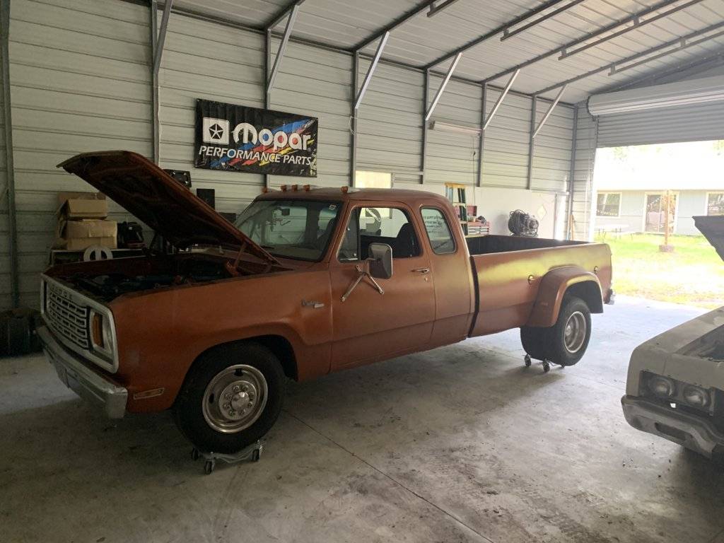

Somebody is finally coming out to play after sitting all summer in the back of the shop.
Really gotta Hand it to the little harbor freight dollies. They handled the big ogre just fine. Takes a little persuasion to get the wheels turned, but she came right out.
She fired right up on the first rotation, and was ready to go. Got a couple electrical gremlins to sort out. The sound system doesn’t want to work. A first gen with electrical problems... go figure!
I’ll get her fueled up and ready to go. She will take over daily use while the ‘96 is in the shop.

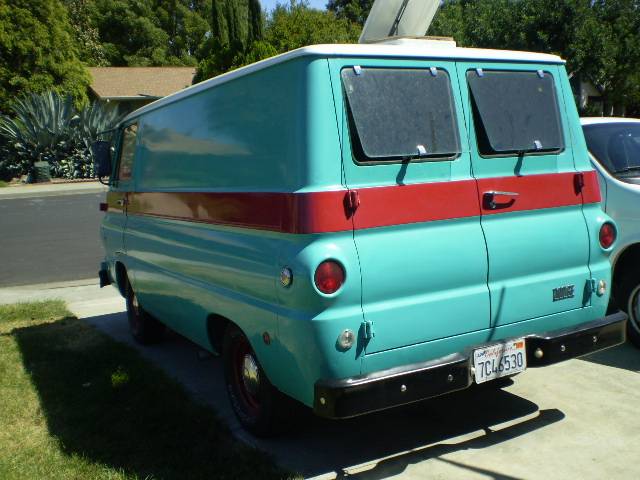

I had to find something too, I used these on my A100, you may have to hog the hole to make it work. I did! I though you had gotten another train? Always leave it to NAPA! Good Luck
https://www.napaonline.com/en/p/BK_...+-+Universal&keywordInput=licence+plate+light
I didn’t think the plate lights would be as big a pain to find as they are. Seems like all of em got destroyed in some way or another. I’ll look into these. All the aftermarket “one size fits all” is way to big.

Try finding license lens's for a A-100, good luck with that! Here's what they look like, I thought I had better pics. You get the jist of it? Good Luck!
