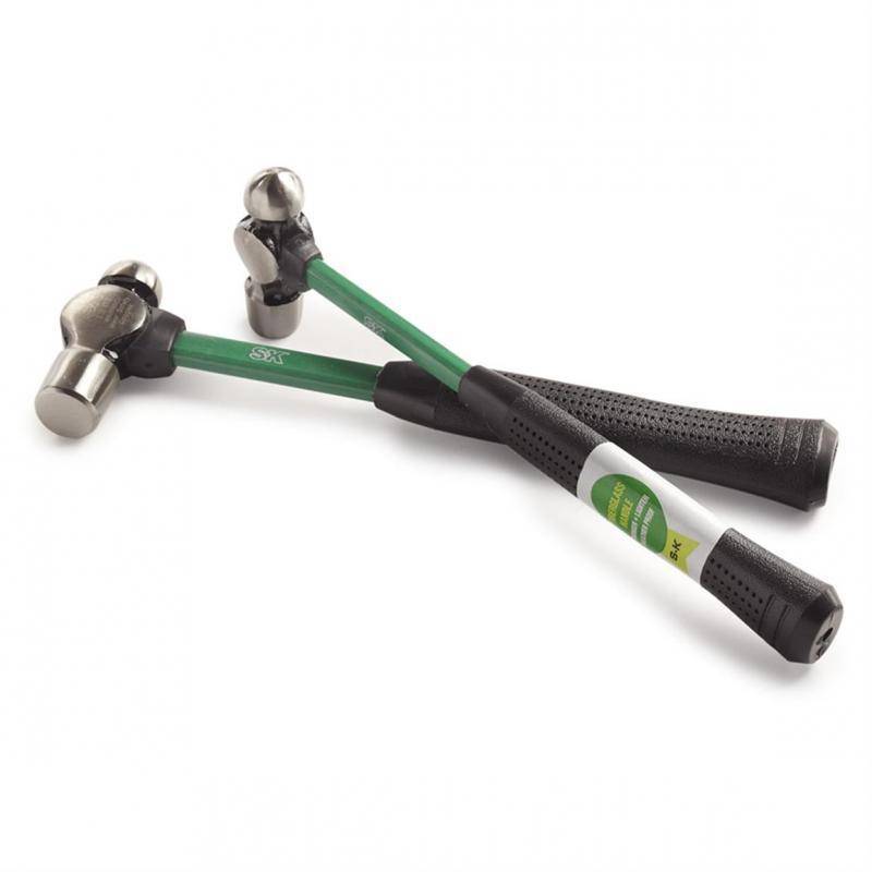

Hammer absolutely every inch of valve cover flange to insure flatness.

I agree with Stan on the flatness of the metal, with an addition. I use 2 ball peen hammers to counter sink the bolt hole area on any sheet metal (Pan / valve cover / trans pan) usually 2 light taps from the gasket side of the metal. I angle the tin against a vise for minimuim surface bends. Once you have a slight convex curve (as seem from the outside of your tin) it gives the bolt something to bite on and allows better clamping power. I use a thin bead smeared with my fingers on the gasket tin side only. I also prefer cork / cork, rubber.
If the bolt area is concave or dished(as seen from the outside of the tin) torqing to spec will have the same results as you have now My .02

Stripped the paint off, sanded to rough up the surface, then I used the ball hammer method to pound out the bolt hole areas and I also straightened them as best I could see. They did look pretty warped where the leaks were. I never bothered to do that the first time around. Didn't have any primer so I did the three step POR-15, then I did three light coats of my color of choice (Don't ask,lol). I applied gook to the valve cover and a thin layer to the gasket side that mates up with the valve cover, set them in place and pressed them in til they seemed sticky enough to hold while I worked them into the engine bay.
