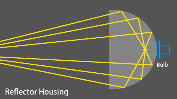

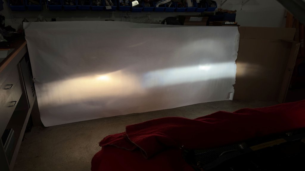

Not necessarily aim, but the beam pattern - the reflector is shaped precisely to aim the light exactly the way it should:

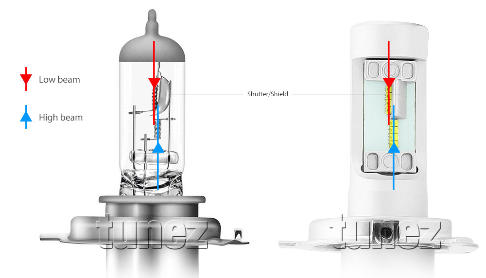

The shape is designed around the exact locations of the halogen filaments - if the diodes on the LEDs do not match up the beam pattern will be thrown completely off. Notice in the below pics how the diodes (the little squares) are placed in such a way to replicate the position of a typical halogen bulb's filaments, it even has the glare shield as well in this example:
People will often buy the cheapest aliexpress special (even though aliexpress also has actually decent LED bulbs out there) which just has diodes covering the entire bulb and then wonder why everyone is constantly flashing their high beams at them.
