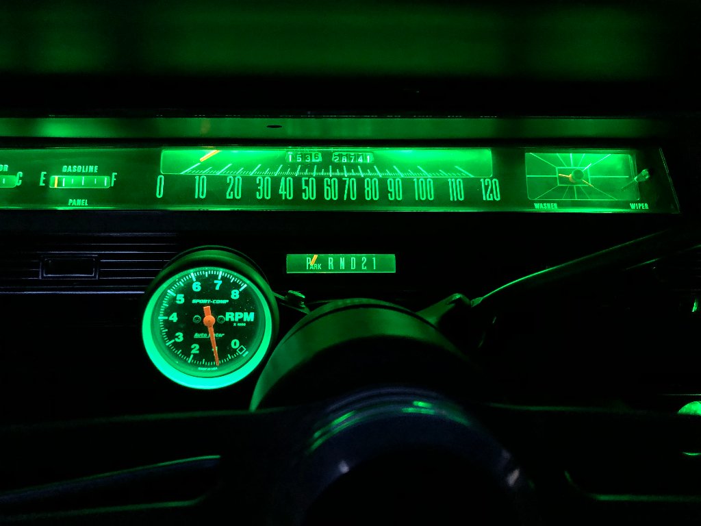

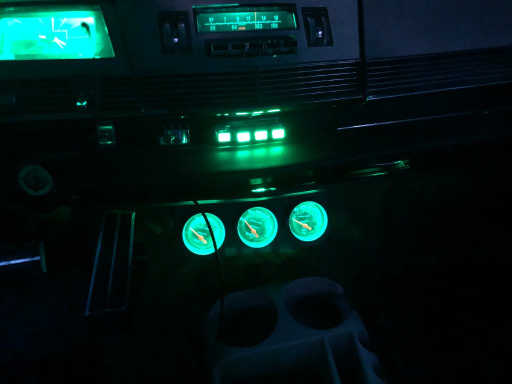

Repaced all of my dash and interior lighting with LED's. The camera makes it look brighter than it actually is, so in person it isn't quite that bright and glaring.

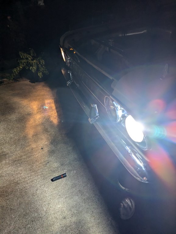

I too was in this Headlight/LED conundrum, I didn't want to modify the harness as it's intact & original, so if the next owner wants to put back the Halogens, it's ready to be swapped out.

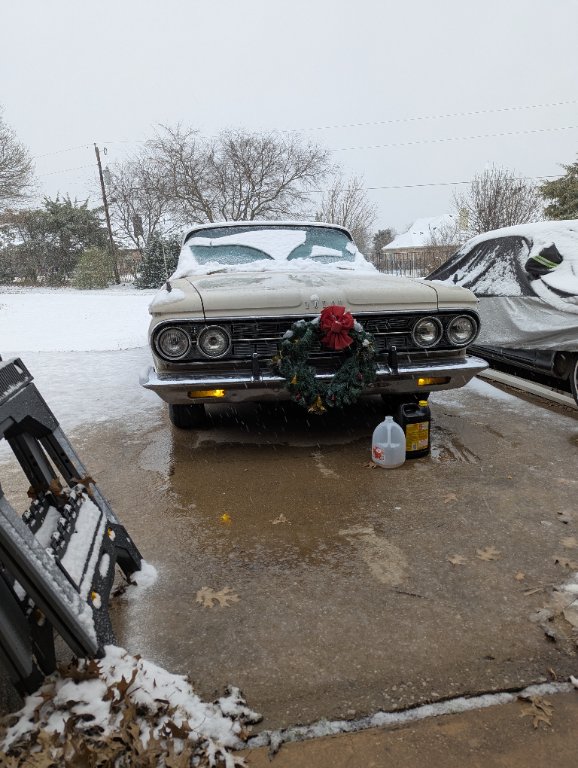

Led's draw very little current and very little heat compared to the Halogens, meaning driving in snowy weather can ice up the LEDs, few years back it was snowing and the snow started piling up in the headlight bucket/lens face.
I drive my cars as a daily driver, so the snow issue was evident, but it doesn't blizzard that much in Texas.

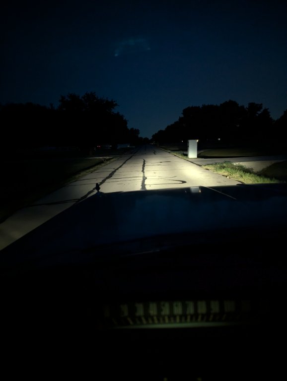

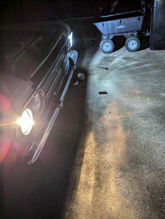

I've done a comparison of how the Halogen's looked with the LEDs mounted side by side, sorry you couldn't see the lens pattern, it still was like halogen pattern, this is very good as most LEDs have a sharp cutoff area.
The LED lights were from: Vintage car LEDs.
Note: the LEDs were not the cheapest, but the extra lumens does quite the job being able to see at night.
Lumens of LEDs: 6500
