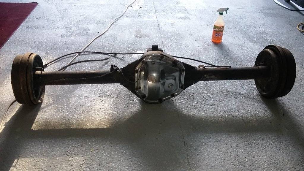

I picked up a 66-67 B body Dana 60 local. It was a reasonable price, so I took it.
Right now, with the 440 and Nitto DOT tires, the hook is getting so hard, I doubt the 8 3/4 will live.
The Dana, flange to flange is 54.25. The 8 3/4 stock in my 65 Fury flange to flange is 56.75.
The 2.5 inch difference is too much to take up with offset spring hangers and shackles.

The Dana I have seems good, the locker passes the prybar test, gears don't have any abnormal wear.

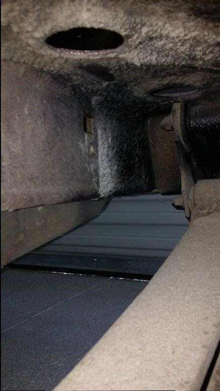

Yea the rear frame rail is at a funny angle , the rear shackles are actually angled inward pointing down.
As stoked as I am to get started, I think getting a lift first will be a smart move.
E bodies have angled rails under the rear but the shackles are straight. On a A body youweld the upper shackle tube right into the rail if I remember right. The old relocation kit from Mopar Performance the front piece was a u channel welded into a cut out section of the rail by front spring hanger and the spring then sits up inside the rail and you drill the hole for ride height.
