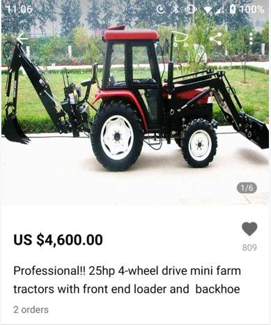

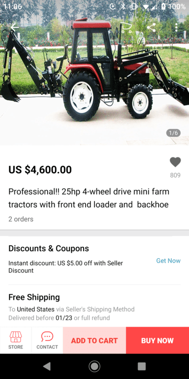

Found this on AliBaba. Seems like a good deal...
Note the free shipping. How can you lose?

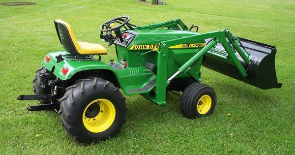

This is one of the smaller John Deeres I've had to setup and work on. This was about the time all the larger tractors were switching over to Kubota engines and I'll have to admit if memory serves me as I remember jap plating on most of the bolts, so pretty much all jap.
This 400 was still all USA with a Kohler 2 cyl engine, had hydraulics and a PTO, very versatile lightweight tractor. I think it was around 6 grand with a mower attachment back in the 80's.

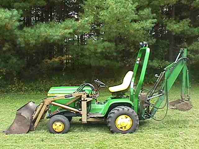

I tried it out today to bring in a load of firewood. It works ok. It does have some interesting limitations. Backing up to turn around with a load of wood is a little bit interesting. I confirmed that I have to be careful to make sure the back of the trailer is heavier otherwise it takes the weight off the front wheels and steering is very difficult. I had hoped that I would be able use the hoe to dump the trailer, but it doesn't have enough oomph to do that. It still allowed me to haul in about 6 bucket loads of wood at one time so I'm good with that.
I told the wife that it would work better with a bigger backhoe, but then I wouldn't be able to get into some of the places I need to go. Always a compromise somewhere.
The point is; you recognized a need, thought it through, executed, and now you are reaping the benefits, making your life easier for not a lot of dough. Well done.
You make it sound so simple!
Backing up is a little bit interesting. Is kind of double jointed due to the fact that it pivots on the ball and then the hoe doesn't stay perfectly still. Sometimes when it wiggles a little bit it's helpful other times not so much. We brought another load in today and I'll probably bring in two or three more in the week while the weather is warm. Better than having to get it in January or Feburary.
How about some ballast in the front bucket?
Yes, it gets loaded with wood first. This makes a big difference. Maybe I'll have to keep an eye out for some wheel weights.
I've also considered filling the wheels with inexpensive -20 windshield washer fluid. Before doing that I want to investigate getting some slightly larger tires.
Just as a useless mind exercise, I did some deep digging into these 6,000 dollar Chinese loader backhoe tractors.
Yes. You really can buy them for real.
Here's what people who did have to say.
They come unassembled.
Critical pieces will be missing.
They will not respond to any problems.
Repair parts non-existent.
EPA will confiscate it at POE and crush it.
No refunds no returns. :rolleyes:
