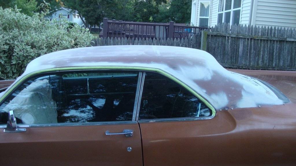

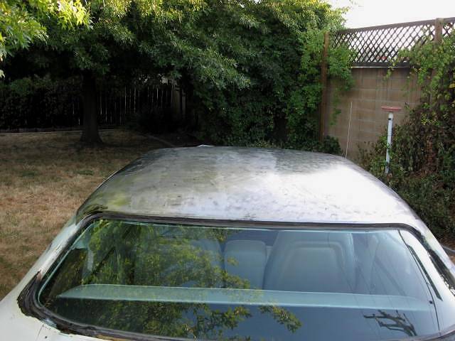

pics with the top freshly peeled...almost looks like it had a half top before the full top
View attachment 107426 View attachment 107427
View attachment 107428 View attachment 107429
So I finished up my glue removal today. I used Goof Off (the heavy duty one), some red shop rags, and a plastic scraper used for paint removal. The scraper was sharp enough to scrape up the glue once it was soaked in the Goof Off. It took several steps, but I'm pretty happy with the results.
View attachment 108100 View attachment 108101
